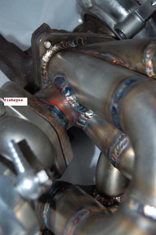

How much amperage did you use ? Where did you use 2.4mm filler ? (pipe to flange i suppose ?) What diameter electrode ? 304L or 316L ?

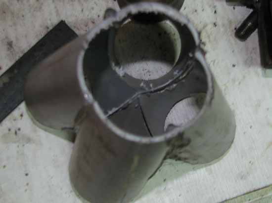

Well its a dry band saw, but this collector is from pvc pipe !
I have my jig ready (from a previous log style manifold, talked about in older posts) but i am trying to find how pipe bends and collector will go in place without wasting precious stainless...

So, you didnt mention, What were your amperage needs on average ? Did you go on the low or on the high side ?

Nicely done. Only thing i'd critique is that filler additions could be tighter/pulse frequency increased- there's some 'fish eyes'/mini craters visible

Yes, big filler just for around the flanges, maybe a little dab here and there, maybe if there is a small gap.
I used a 1.6mm then switched to a 2.4mm, no real reason, i was just on 1.6mm for a real tight job but switched back when i had to sharpen, as i usually use 2.4mm red bands for everything.
Collector looks ok, i'm guessing you did it on a dry job saw?

So you're 'pumping the pedal' rather than carrying the puddle? Can't really increase the pulse frequency if pulsing via a pedal but tightening up the filler additions/not moving as far forward between pulses will fix it. This is what i'm talking about...
With a slow pulse that freezes the puddle there's nearly always some crater defects (from fish eyes through to full on pin holes), overlapping the filler additions by at least 50% will remelt them but you need more like 70 - 80% overlap to get a smooth root profile usually

Rick ! USed 304L or 316L ? I see you used 3mm which tells me you had cracked manifolds in the past ? Really informative thread ! Thanks for sharing your work !
