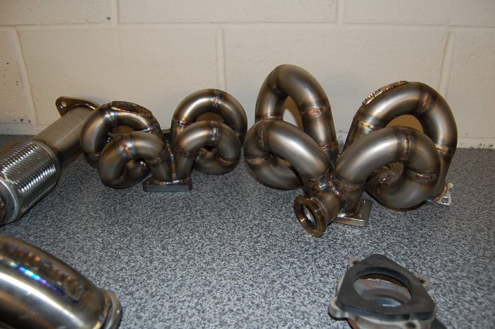

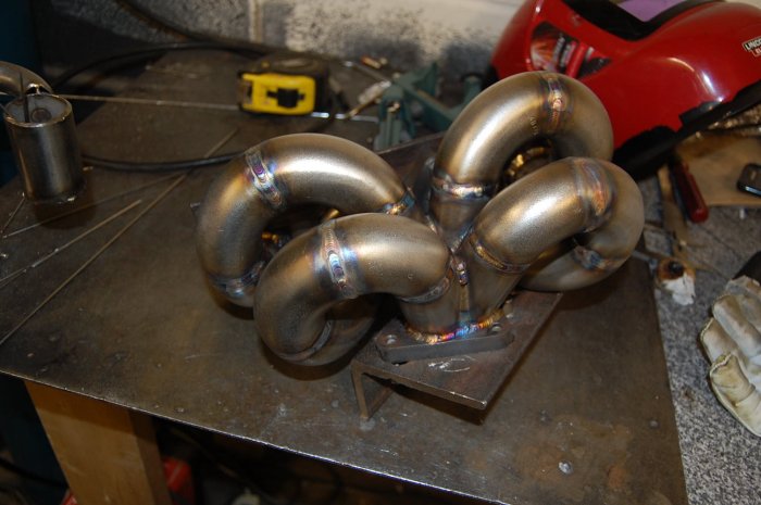

pictures of how you do your jigs would be gd....... :-P

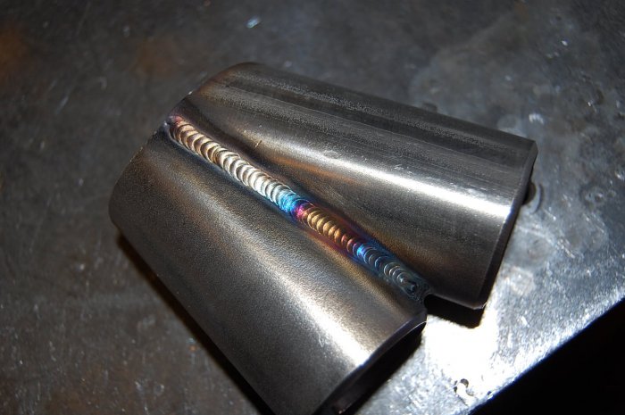

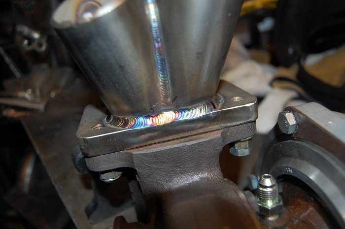

do you purge when welding and do you purge when welding to the flanges?
how far do you have your tungsten out of the cup?

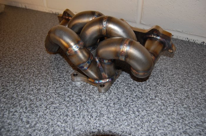

can you help me out rick, i know someone with a cheap fleabay polished manifold like thisand on the inside of the tubes are full of black suguring,cold welds etc![]()
they havnt been useing backing gas obviously so the welds wudnt of got full penetration and will probz be full of porosity.
is that why they crack and break or is it down to weight of the turbo and thickiness of the tube why they crack?
, o and not to wrap it cuz it will melt cuz its made of chocolate
