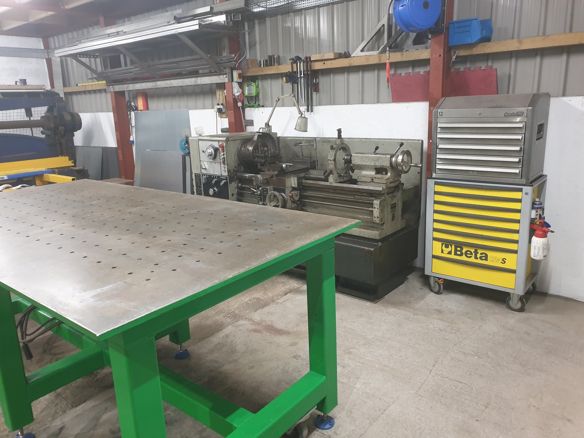

I made a build thread on WW for it, unfortunately used photobucket at the time.
https://www.weldingweb.com/forum/we...t-equipment-and-gear/147890-new-welding-table
1.25m x 2.5m x 20mm top
100mm hole spacing 16dia holes
You always want bigger I think it's a very usable size as-is, it's great for jigging up things like trestle legs and stuff that actually warrants a flat surface. If you were making gates or something, then bigger would be nicer.How do you find the size of the table, do you wish it was bigger sometimes. I can't decide whether to go for 8 x 4 or 10 x 5. It's just the bigger one will take up more space when it's not being used which could be months at a time.
It depends if you want jig holes or not.I think I will go for 10 x 5, would 15mm thick be enough with four 10ft lengths of 160mm channel iron underneath it
The 20mm plate on mine is great, but several of the most used 16mm holes are getting a little bit loose... it's only S275 plate, not super hard or tough, and it will give a little. A thinner plate will give even more.
I wonder if a 20mm hole system would be better in that regard.
