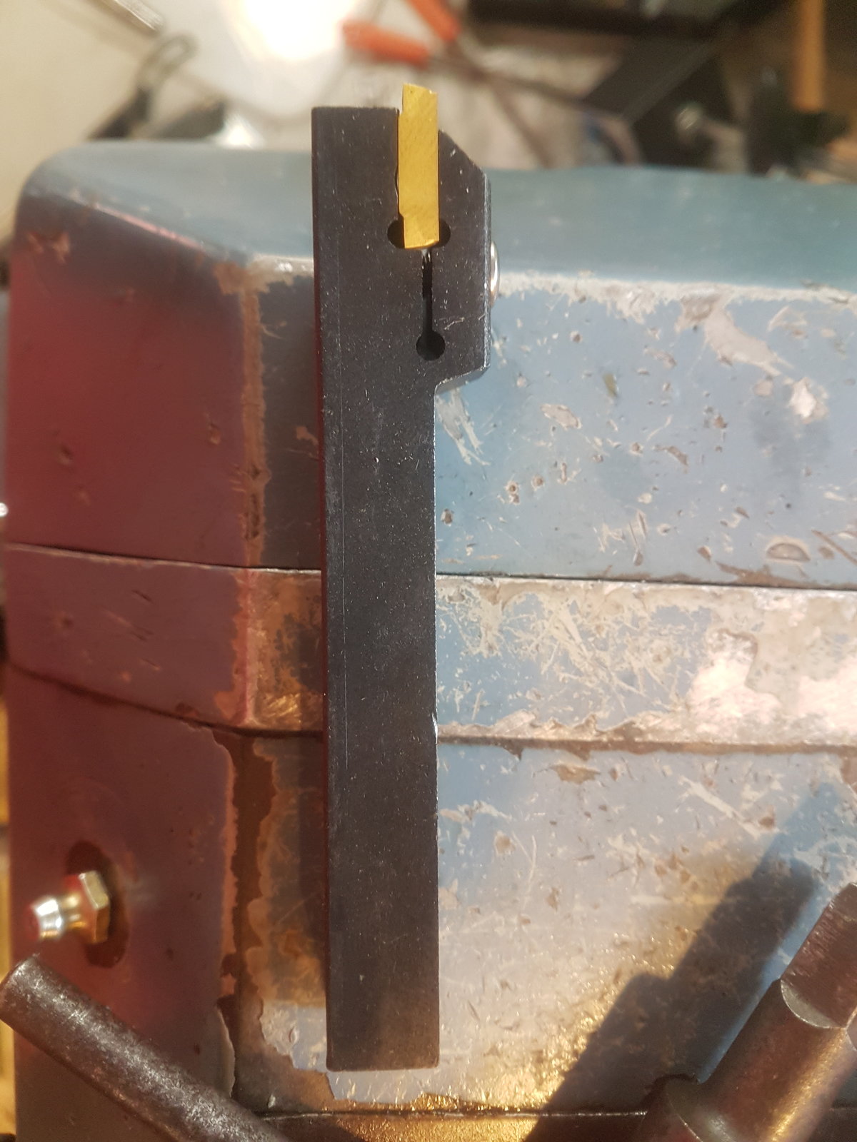

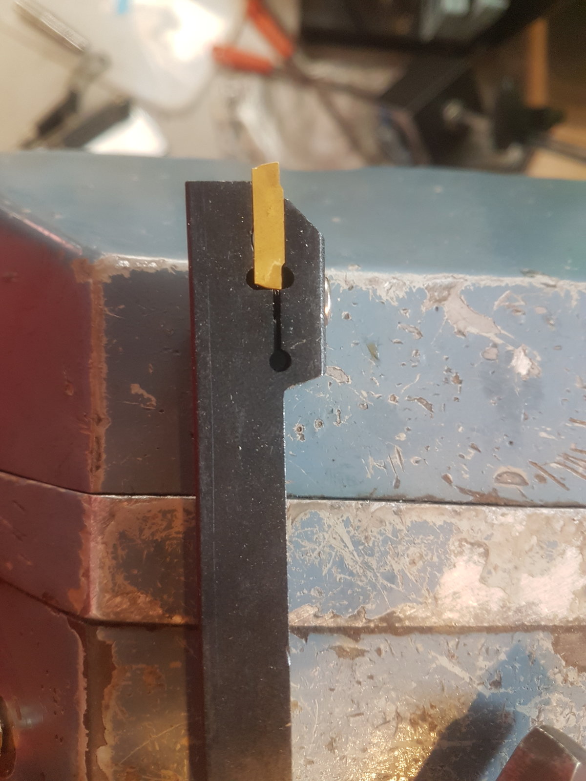

What way do these inserts
		 go in. Top pic i think
			I was correct thanks. That is a 12mm tool the 10mm one don't hold the inserts properly so they breakTop pick.

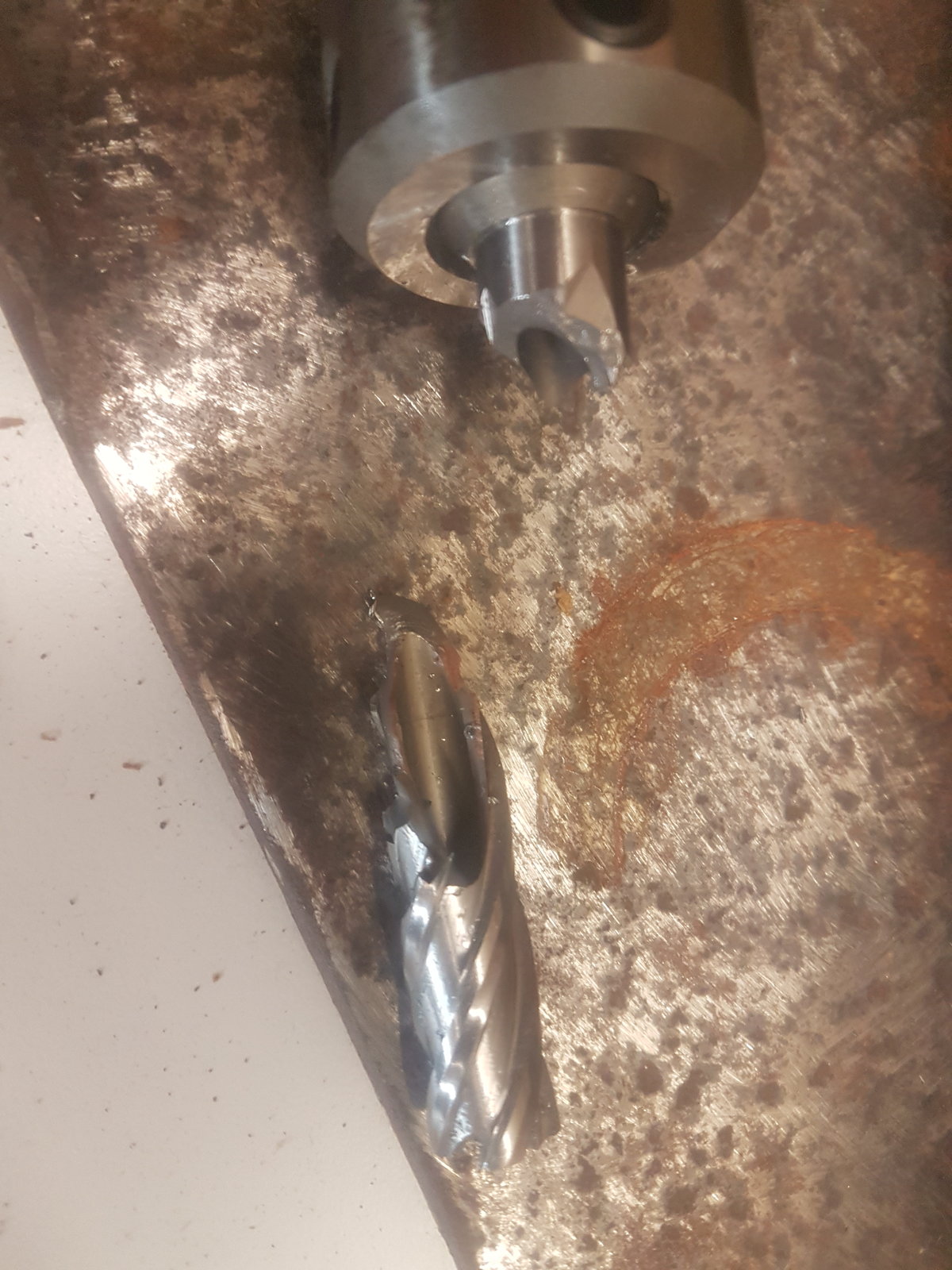

Sods law.start again.I was doing so well the the broach snapped too.

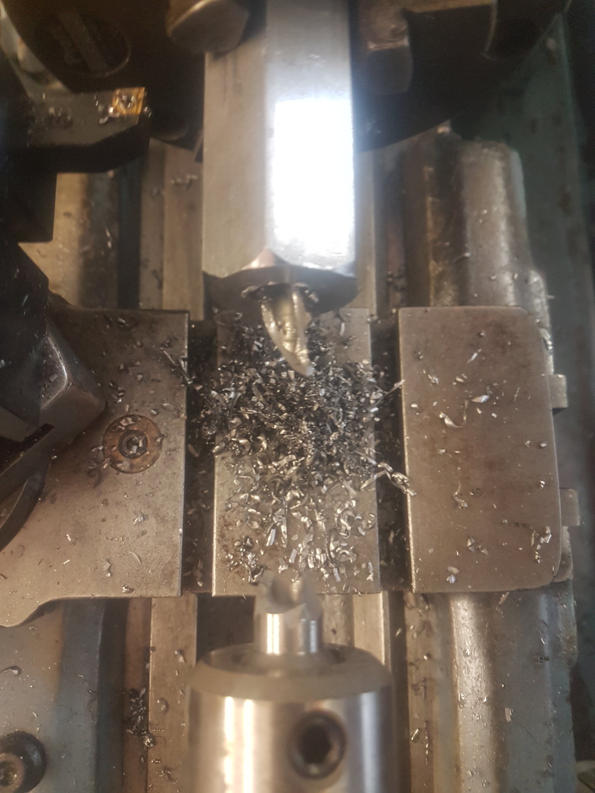

You must still have some alignment issues.I persisted with a new 4mm bit now it is done. I am like a dog with a bone. Bloody expensive breaking all these bits
possible I guess or the cutter did not like being 40mm deep in the hex bar
the rota broach dont need a pilot hole, it was nearly through when it snapped and I was going slow with plenty of oil too,
probably grabbed at the last minute breaking through and snapped. it its quite common when drilling unfortunatelythe rota broach dont need a pilot hole, it was nearly through when it snapped and I was going slow with plenty of oil too,
With any drill in the lathe you need to peck and regularly use coolant and clear the chipsThis was a 13mm broach but it was a long one and was in deep
Shouldn't the coolant feed internally with those and keep the "plug" lubricated as well?
No they don’t need coolant constantly. It’s an option for gravity fed coolant on some magnetic drills.Errrr, post #912
