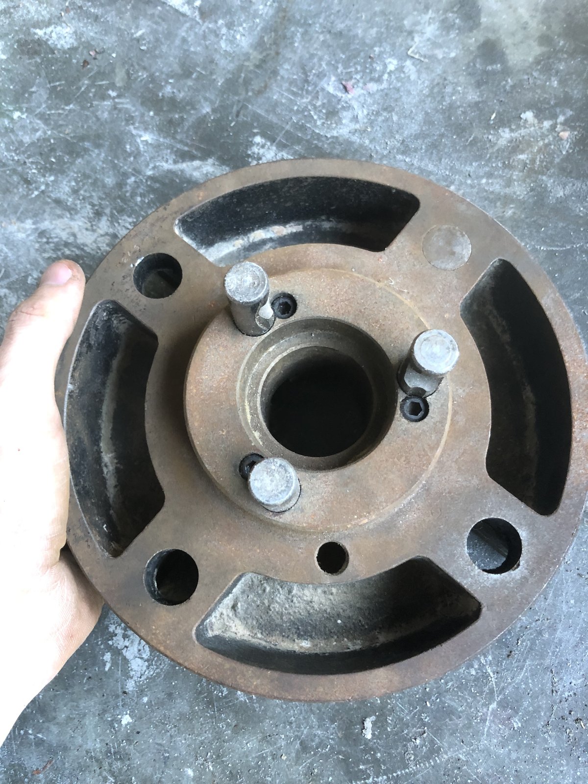

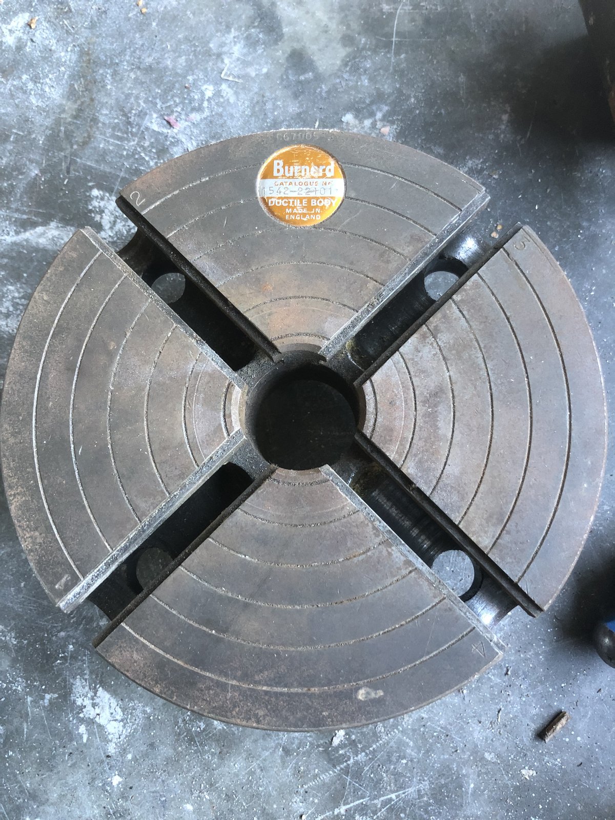

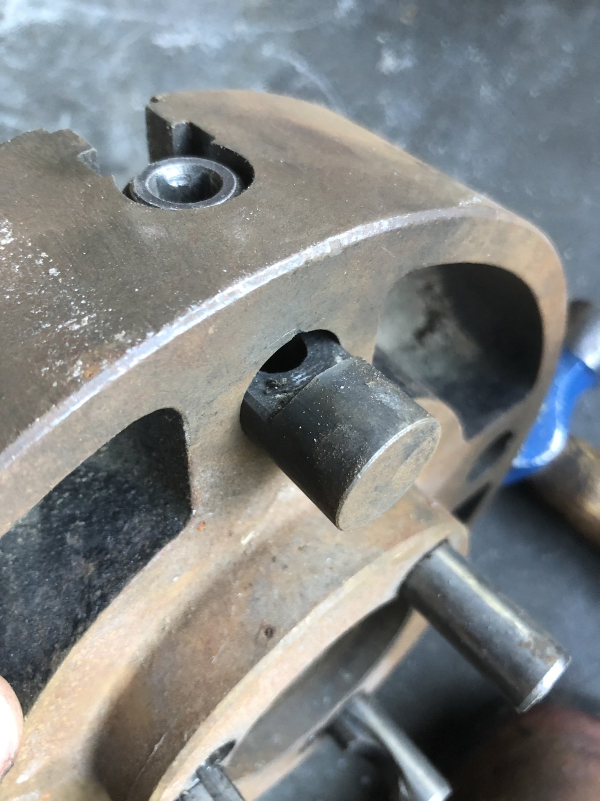

O i have a 3 jaw to do alsoIt will only be jammed up with crap. Have them out and do them properly. Takes no time. Hell of a lot easier to strip and clean than a 3 jaw
Something else I need lolYes. Use a brass or copper drift. preferably.
that is a good idea thanksYou can just buy Hex brass bar and turn your own now!

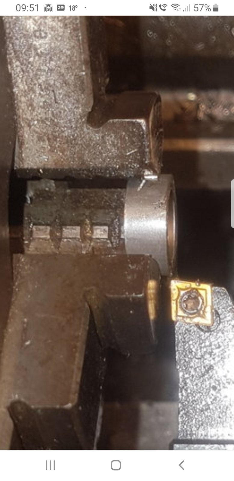

If you look at the picture. The bit your machining is very close to the edge of the jaws. If there is slight play in the jaws this will most probably cause your piece to be slightly out of round.View attachment 183215
A collet chuck.thanks Spencer, any thing I can do to combat this
A collet chuck.
Replaces the current chuck. Something like a C5 collet chuckthat could be a nice investment one that replaces the current chuck or one that gets held by the current chuck
Start with long stock. Face off. Center drill.
Drill and or bore to internal size.
Turn to external dims.
Chamfer face edge of required.
Start parting to required thickness.
Chamfer other face if required before parting off fully.
Clean up the back of the internal hole by hand if required
Move stock out when required and repeat.
