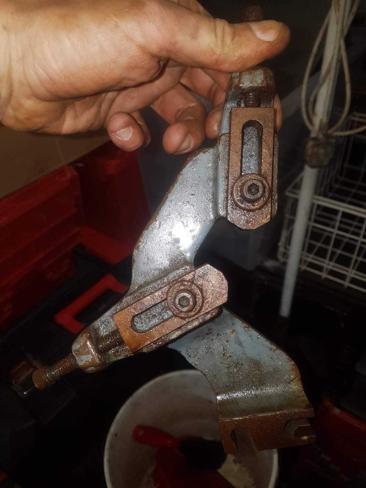

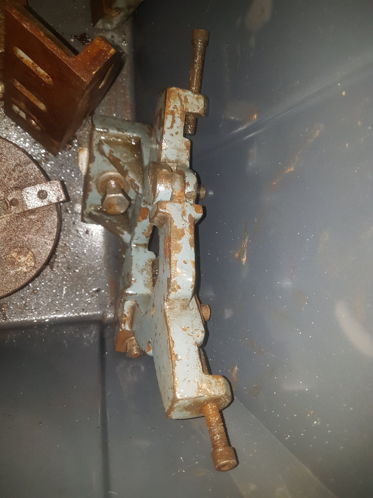

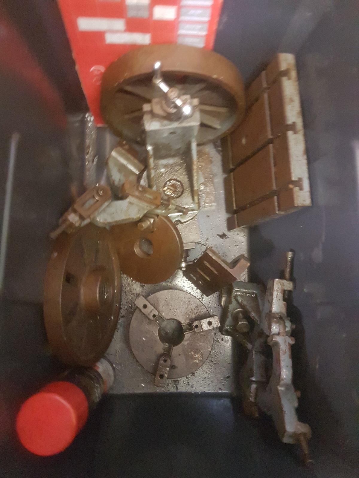

Two face plates, a catch plate, fixed and travelling steadies, a vertical milling attachment and a boring table. A nice little cache

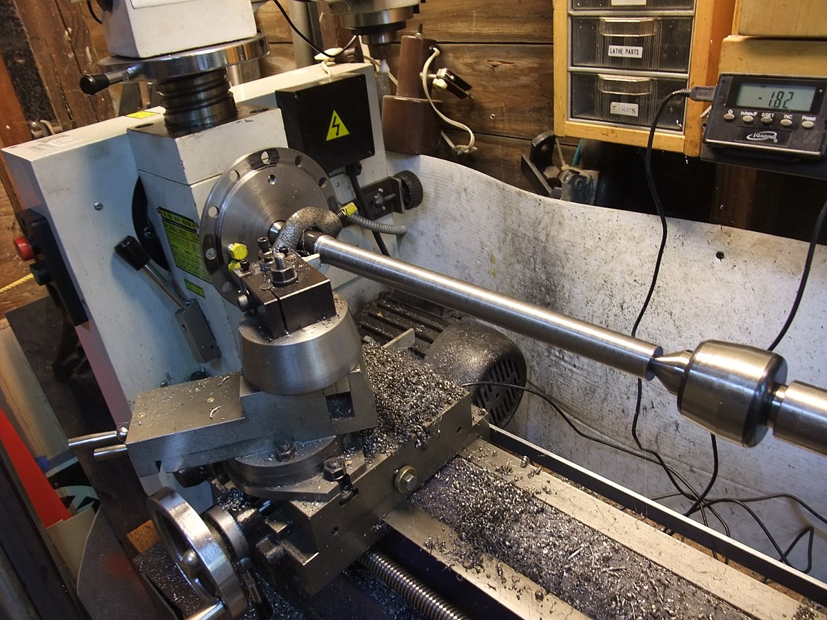

Catchplate is used to drive drive dogs.what is the catch plate for and the boring table come to think of it is that to bore irregular shaped stuff
Found with milling and turning often deciding how to mount or hold the part is harder than the job itselfOh they are. Limited only by your imagination

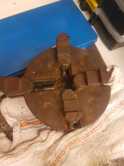

There's the technical words i couldn't think of. Dowel, retained and concave haha.The plain section on each screw is how it is retained in the body. There's a dowel with a concave end that locates around the plain section.
Yes i saw.that. that is the part that needs punching outThe plain section on each screw is how it is retained in the body. There's a dowel with a concave end that locates around the plain section.
