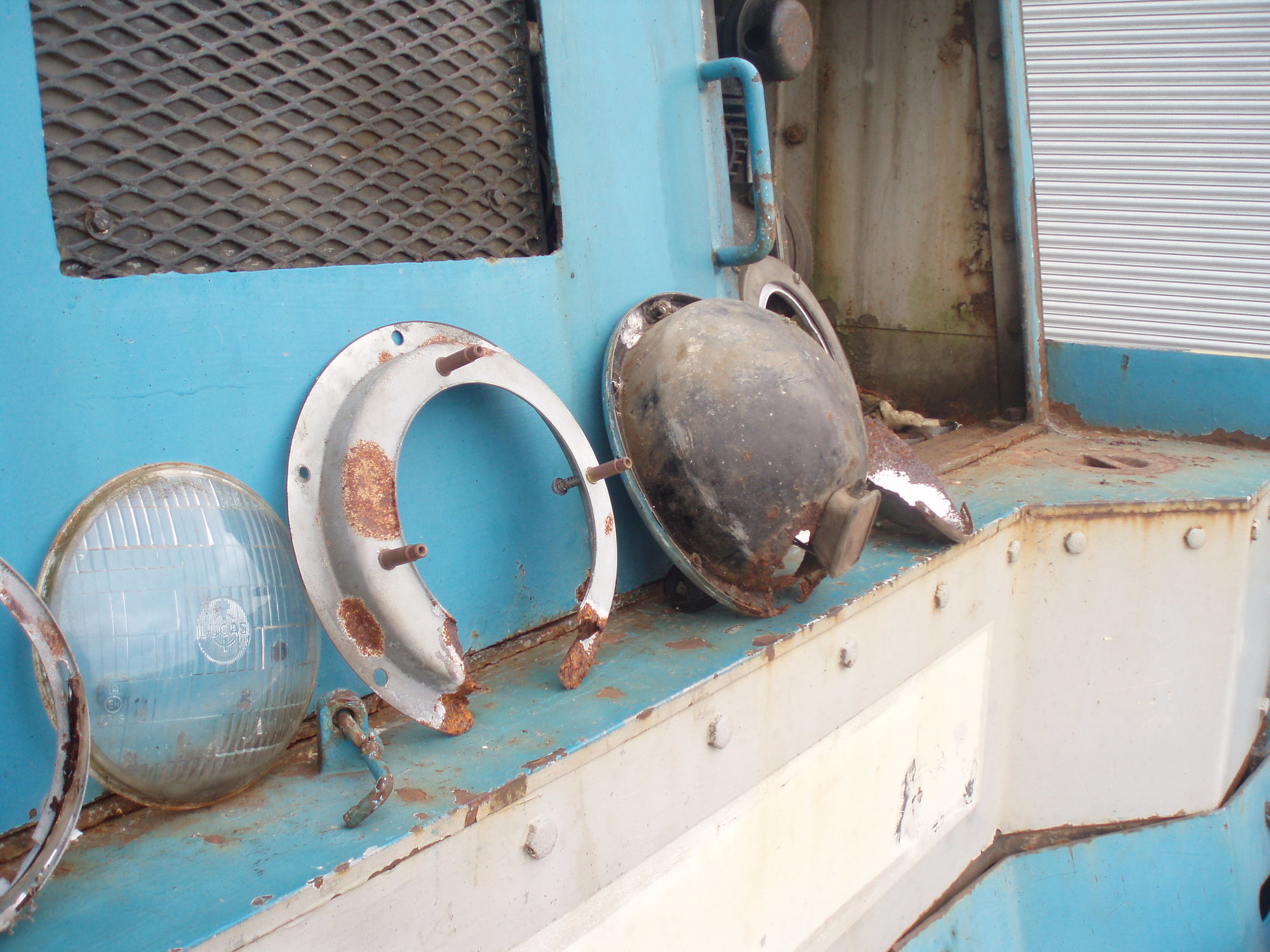

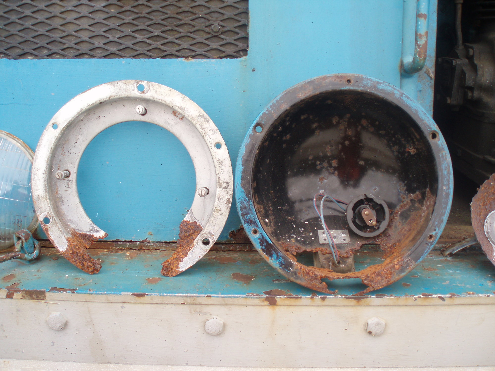

    I need a couple of headlights for the loco, looked at a few places on the net but find the nearest seem to be old Land rover, could probably fit them but the original would mean no faffing, there're Lucas 7 inch old sealed beam type, as the pics show a little bit of pitting here and there. And the guy from the dark arts is coming to sort the charging problem tomorrow. P1010159.JPG P1010160.JPG P1010161.JPG P1010162.JPG

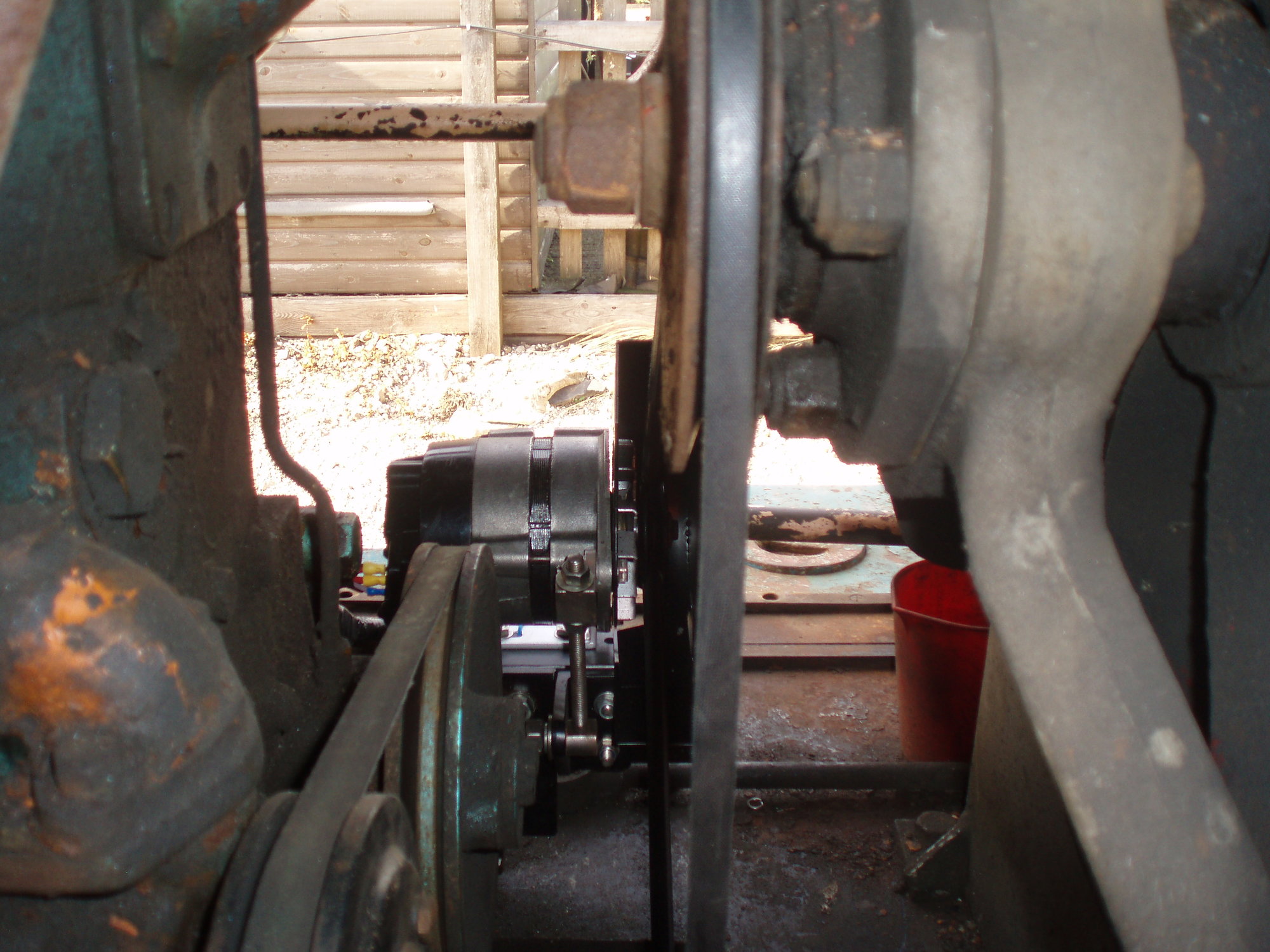

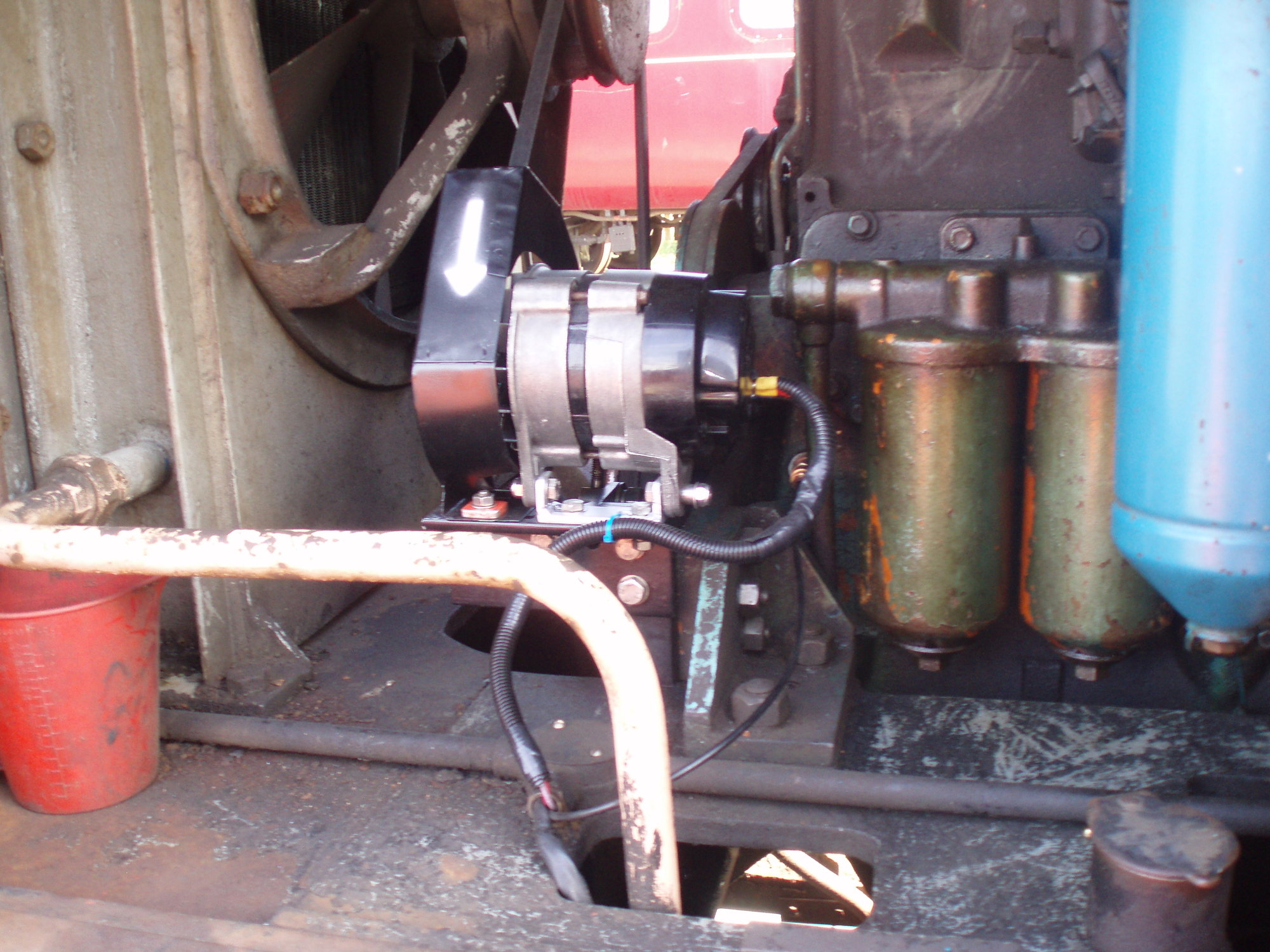

    P1010173.JPG Been off the net for a while ( not paying twice for it) so on it where and when. Sorted the charging system out, Left the old dynamo in situ and fitted an alternator at the front. On with the brakes now as everything is seized solid. P1010171.JPG

  16. slim_boy_fat
    slim_boy_fat Forum Supporter
    What was the thinking there? Was it to preserve originality or is the dynamo fulfilling another function?
    Dieselkid 63 likes this.
  17. mechman Member
    Messages:
    1,682
    Location:
    great britain n.e.lincs
    The dynamo is gear driven and fits in to the rear of the block, so rather than make a blanking plate it's been left in situ.
    slim_boy_fat likes this.
  18. slim_boy_fat
    Ahhh, I see. So, what's the belt from it driving?
  19. colnerov
    colnerov Member
    Messages:
    3,237
    Location:
    Nr Gatwick UK
    Hi, The engine looks like it's driving a compressor in the foreground of pic 2 (seen better in the pics in post 67) and possibly a jack shaft below out of sight, a belt from that is driving the alternator and the cooling fan for the main radiator. Perhaps mechman can confirm or deny.
    Colin
    Edit: A pic in post 39 shows the original set up.
  20. mechman Member
    Messages:
    1,682
    Location:
    The original belt was only driving the rad cooling fan, so that seemed the best place to try and fit an alternator, took a while but got there , brackets lining up etc . I used a link belt to get the belt size required and took it from there. ( £ 28 with discount)
