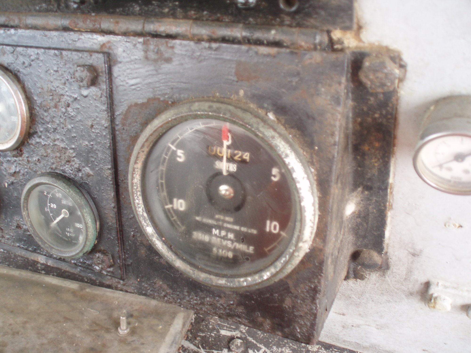

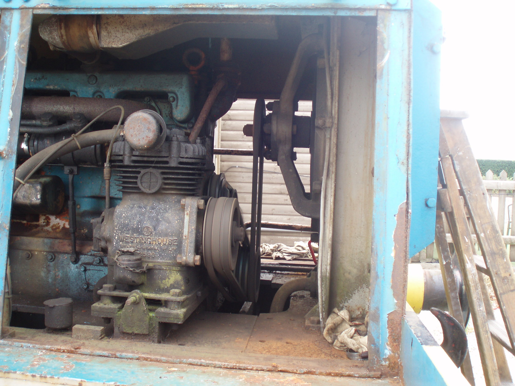

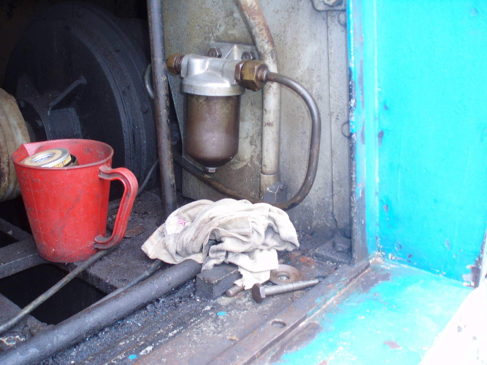

    P1010151.JPG P1010152.JPG P1010153.JPG OK Lads the latest on the Hunslet.
    Fixed the first fuel filter to find the fuel lines blocked, blew them all out. next up to the fuel filters on the block to find the first bleed screw was held in with PTFE tape no threads in the filter body at all. So tapped out to 3/8 BSF. Boxed it all up today and turned the Key and the starter tried (duff battery) so another battery and same thing, both batteries checked and both duff, both Yuasa and both 8 year sold so coat on time till next week. In the pics are the 2 gauges, hours and miles, unbelievable eh.

    Love this little project. I suppose the shunter would have been trapped within the confines of a carriage shed/depot or an industrial railway system but those numbers do look low... could it have gone around the clock? :D

    First time I've seen a speedo that show forward and reverse speeds :D

    The zero is exactly right at the moment.

    Also discovered (first time in cab)it is 2 speed forward and reverse, slow and not quite as slow.:)

    Yes I'm sure It's a CAV the injector pump is as well. It engages ok there just isn't enough oomph behind it. Both batteries were showing very week on the battery tester, and that was after charging.

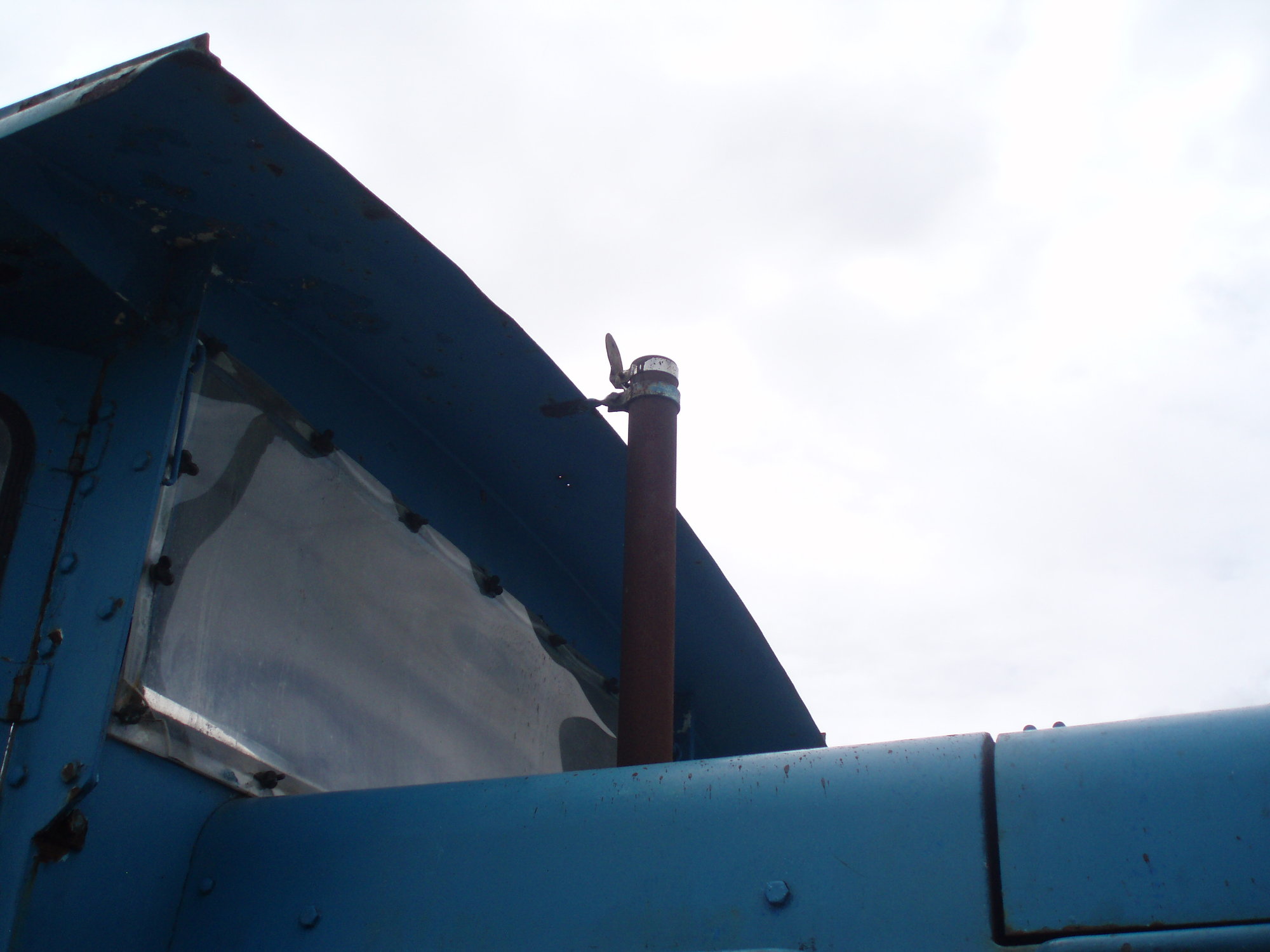

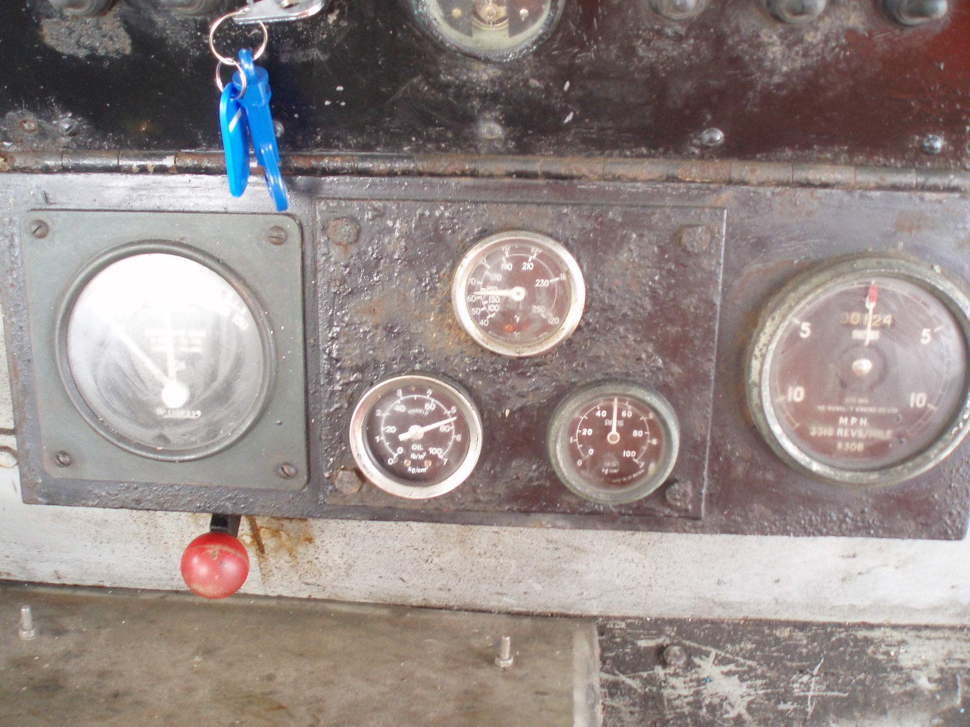

    P1010156.JPG P1010154.JPG P1010155.JPG The latest is It's running (sweet as) a few snags (where's the fun without them) and a few pics, It's running in the pics.
