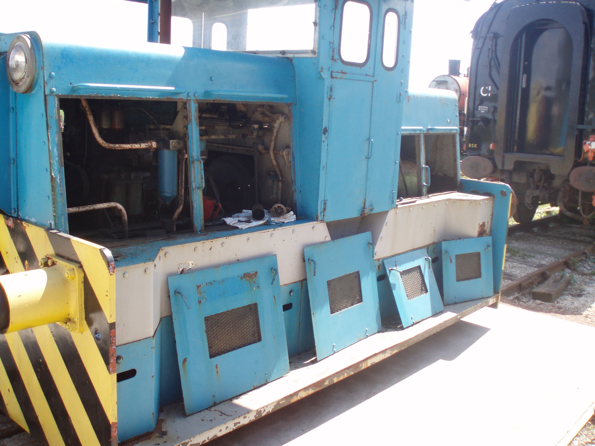

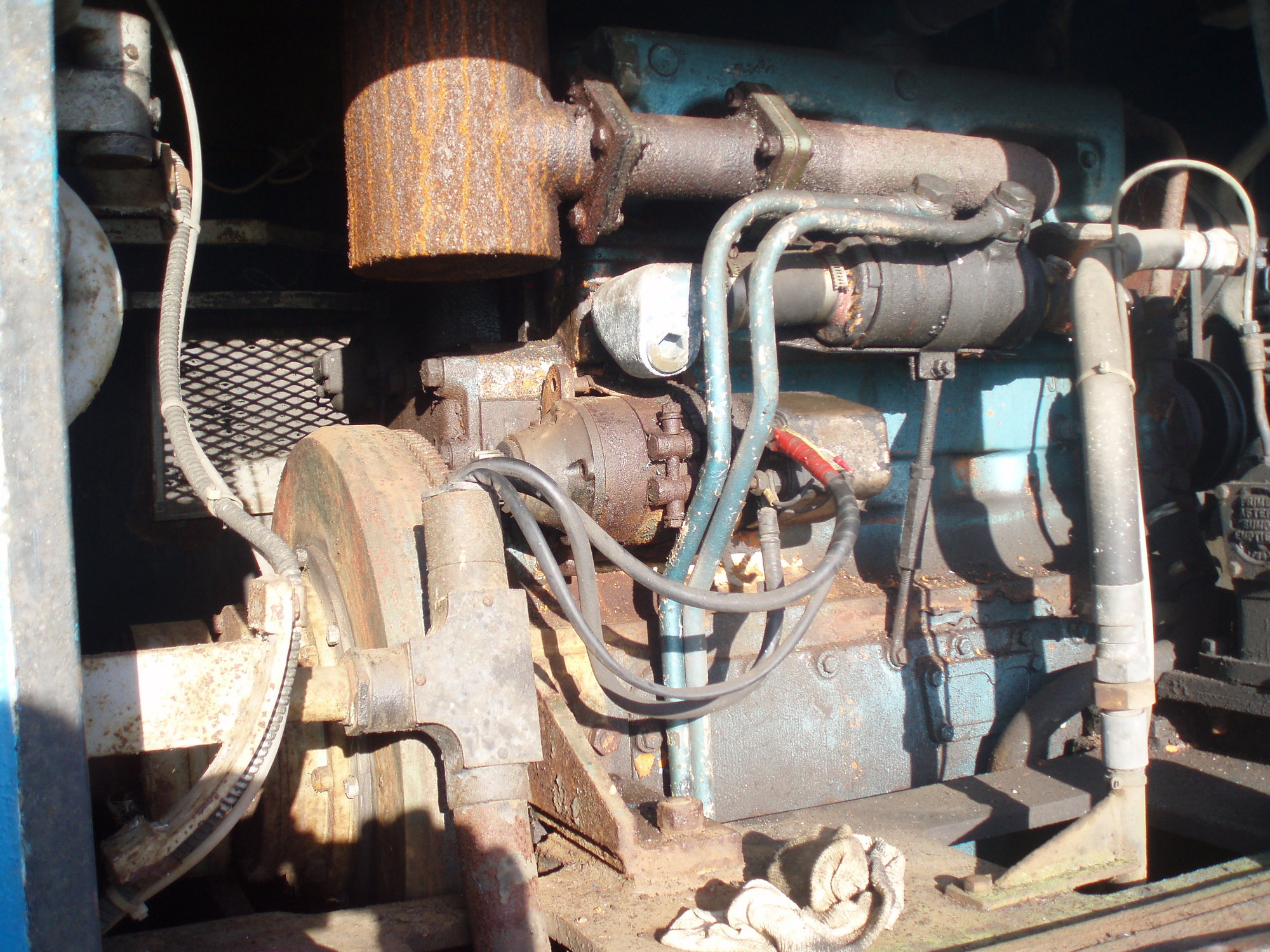

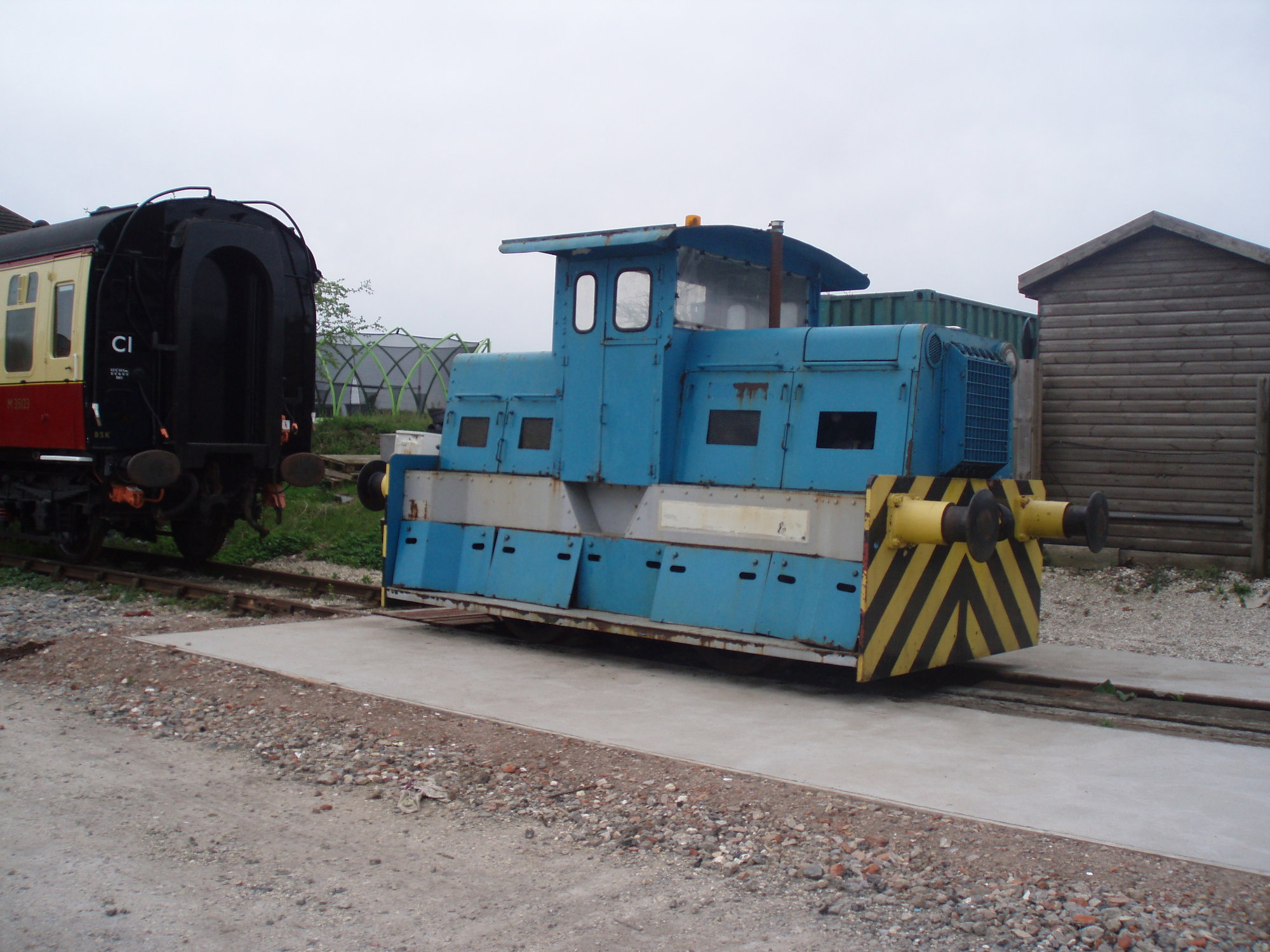

    Bit of a project, I've been asked to have a go at getting this running. It's believed to be the only one left of its size in the country, may be even further afield. It has a 4cyl Dorman engine in it. Built 1961. Gave it a medical today. Smashed fuel filter, water pump shot, and core plug leaking, good news engine not seized. P1010127.JPG P1010128.JPG

    Interesting where is it located atm?

    Birmingham
    Did you get any pics with the covers off?.

    Lincolnshire Wolds Railway.

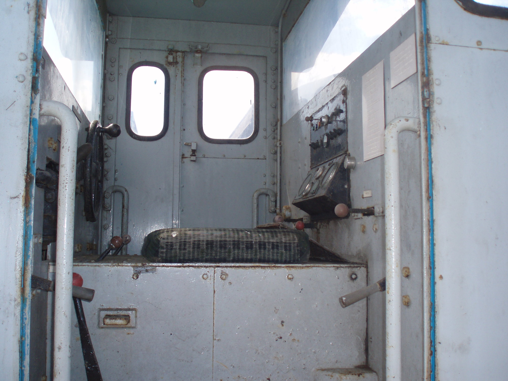

    Forgot to mention that It's controlled by standing on the running boards ( either side ) and using the controls (duel )inside the cab doors ( either side)

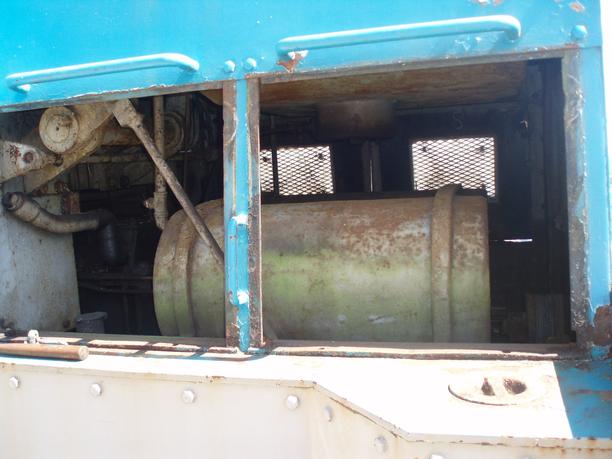

    P1010135.JPG P1010136.JPG P1010138.JPG Here's a few more pics I've taken her topless. one of the pics shows the snapped filter bowl bolt one 0f the lads is knocking one up (3/8"BSF X 4"with a circlip groove in it) P1010130.JPG P1010131.JPG
