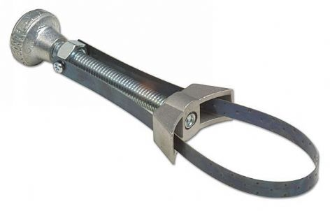

I have one of these and I have found it will grip normal spin on filters that other won't.They work well because they don't focus the leverage in single spot as much as other designs so they tend not to deform the cannister as much. For me the normal issue is doing a vehicle I've not touch before and someone else has goosed it up.
https://www.thetoolacademy.com/laser-3328-oil-filter-wrench---metal-band-1258-p.asp

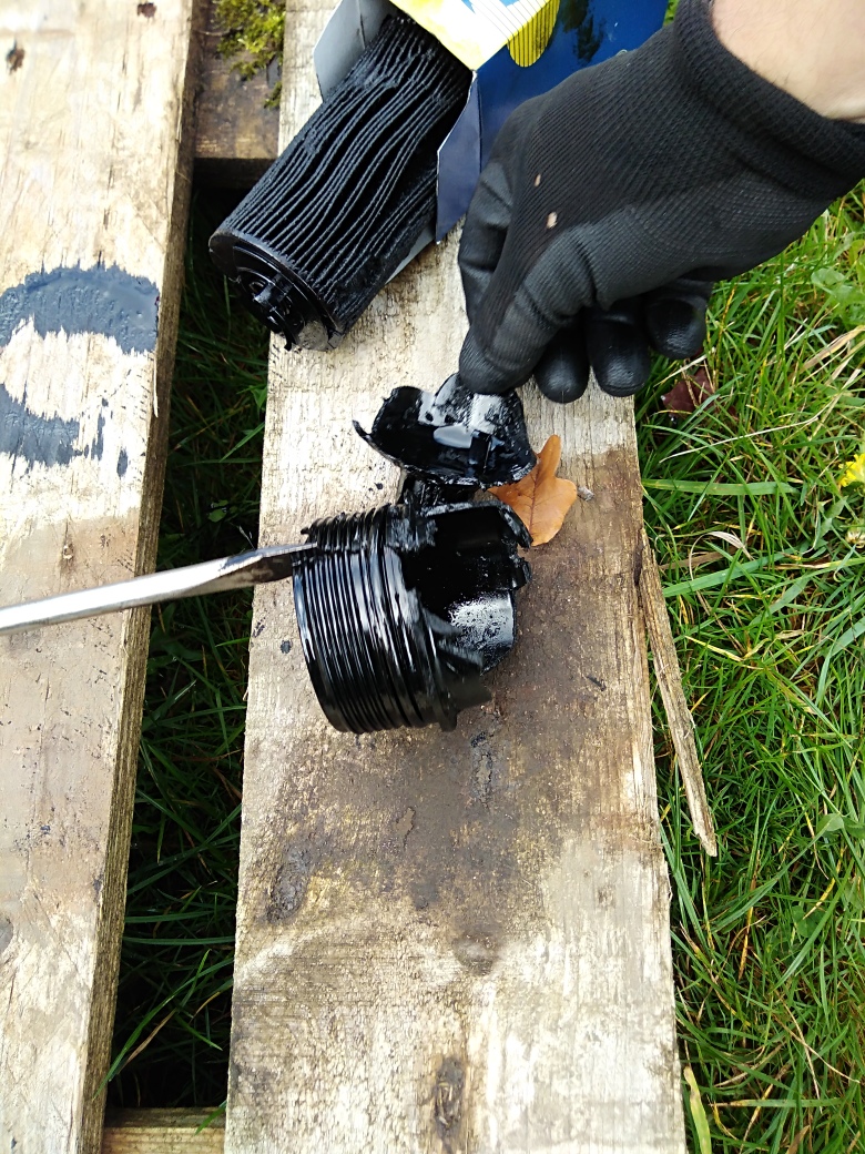

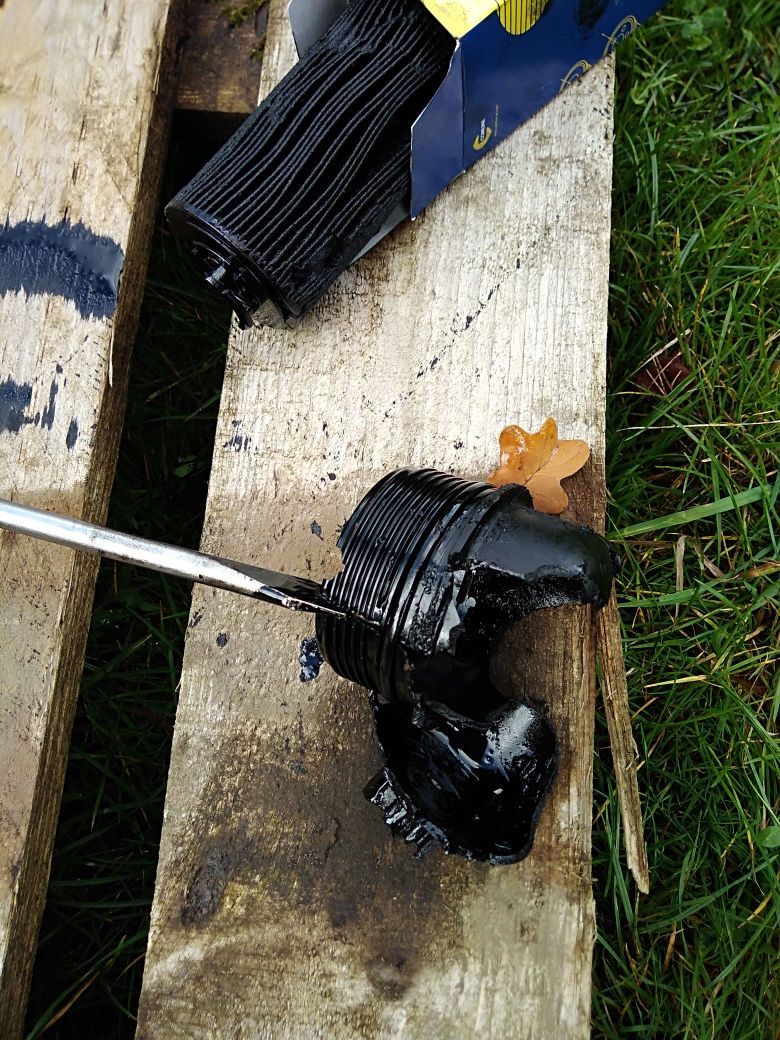

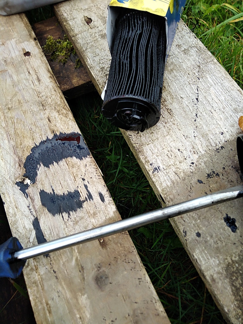

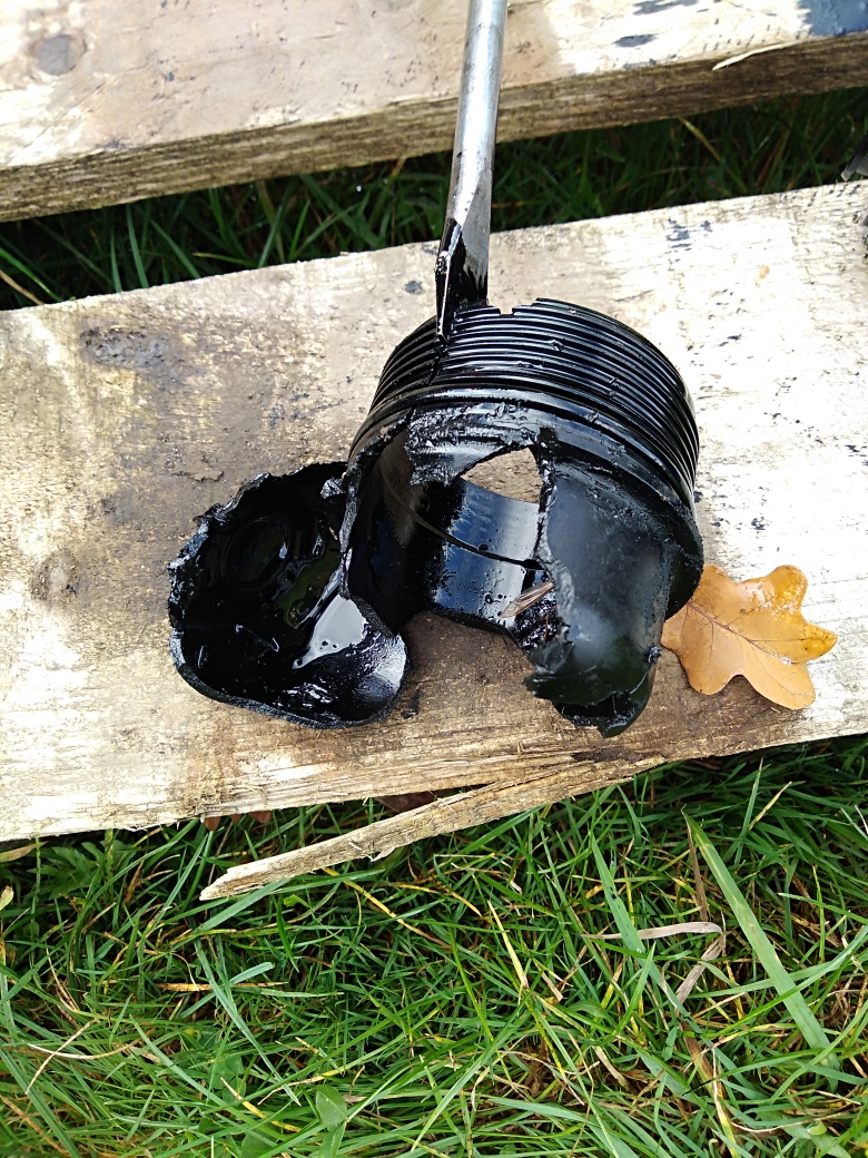

) , then got under to remove oil filter, normally as we all know a two minute job...Ha so yes it might be remove all the front,get the bumper of somehow,remove complete assembly ,then get it apart ,but by taking it of the van you will no longer have it secure enough to get the leverage needed to unscrew the ..... thing, but with bumper off it would be very much more getattable.......07 should be the m9r engine in which case you may get lucky in getting the engine hot hot. The oil filter housing expands slightly and then can release.
If not the hammer and screwdriver to pierce a hole. Snap the rest of the cap off then lever the threaded part off and replace the cap.
,arrived this morning in the post, ordered before I went mad at it..fitted,filled and thankfully running .
