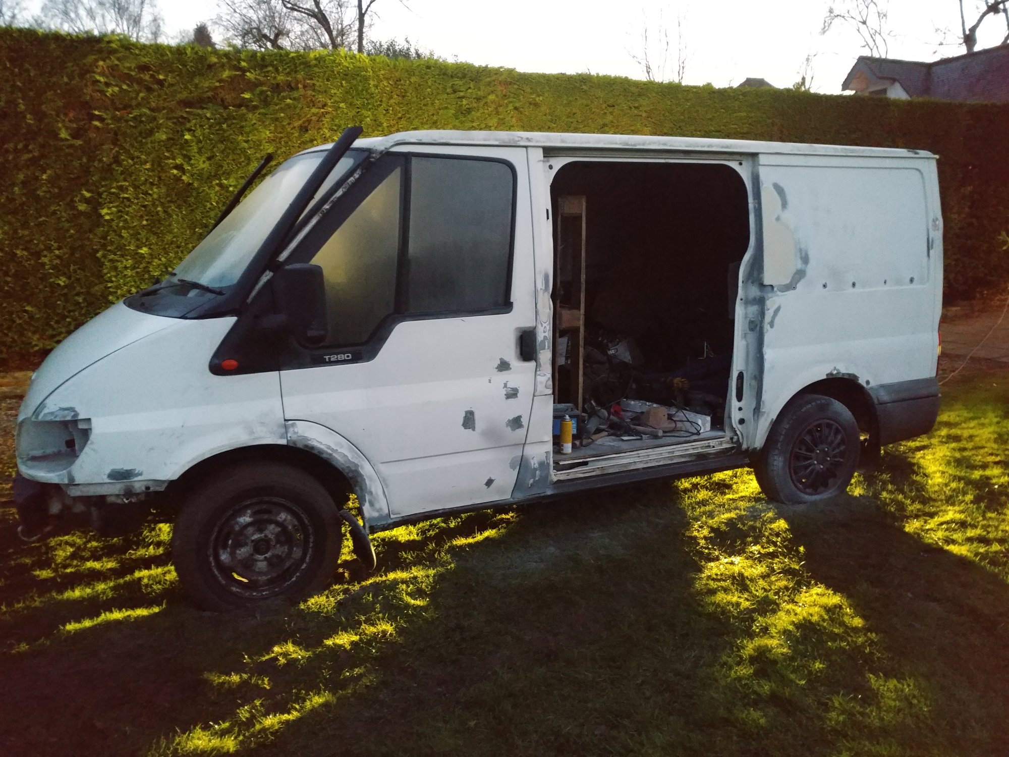

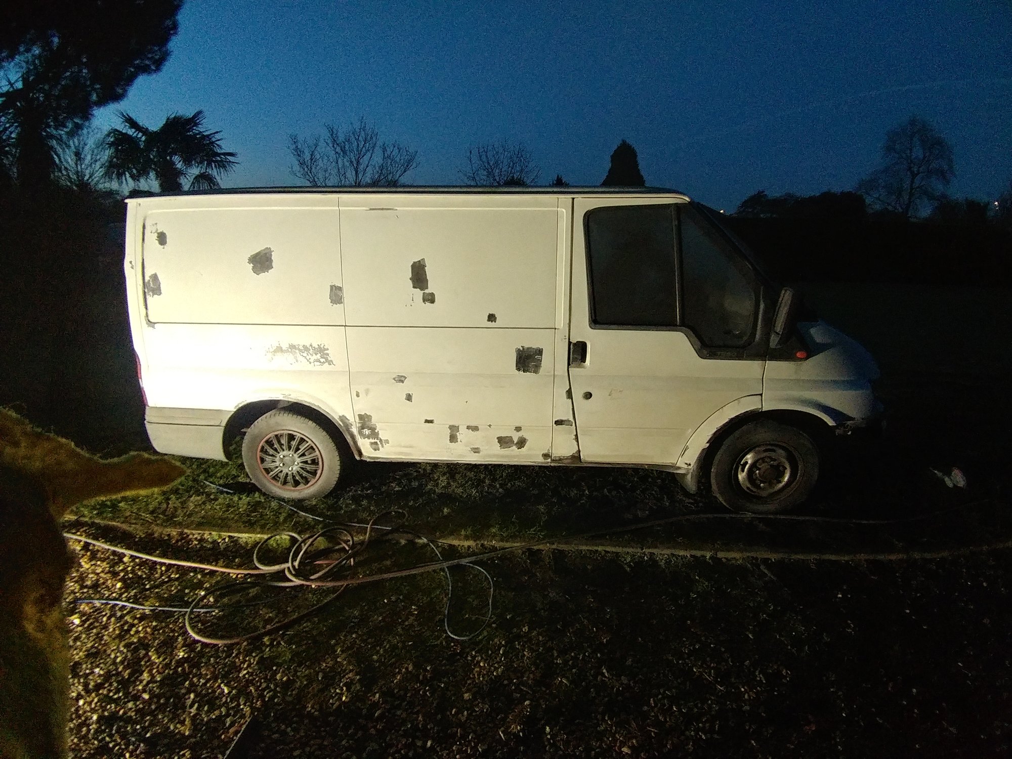

Brush the roof with some Dulux or similar household glossI haven't actually had a good look at the roof yet, but I do know there's a bit of rust on it, and a dent right by the windscreen.
Depends how well it covers and how much body is in it. Personally I'd have used synthetic and blown over one coat. You would have got the coverage and gloss in a single coat. Unlikely with cellulose.I went to a paint shop earlier. I went for the cheapest option which was an industrial cellulose. I bought 2 litres along with anti bloom thinners. At 1:1 that gives me 4 litres. That should be enough, right?
I'll put some pics up soon.
