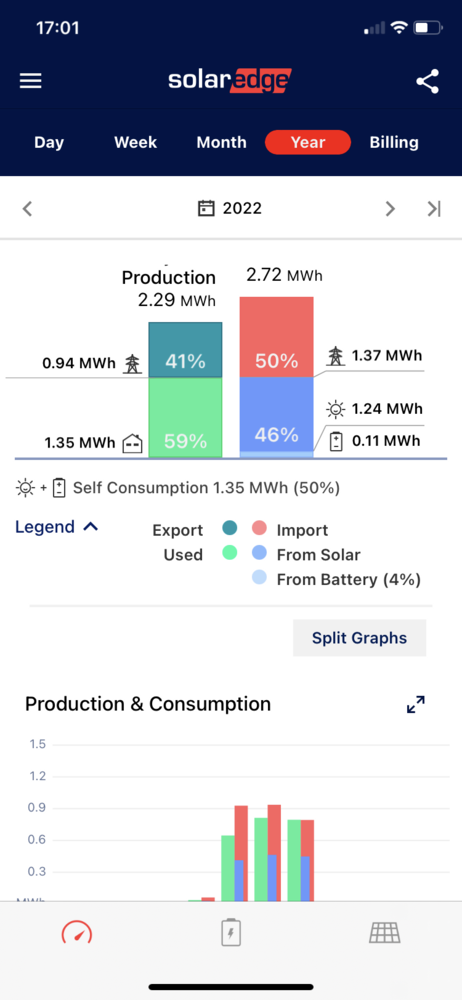

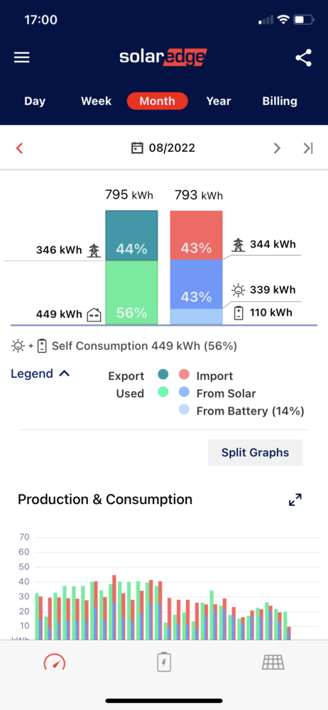

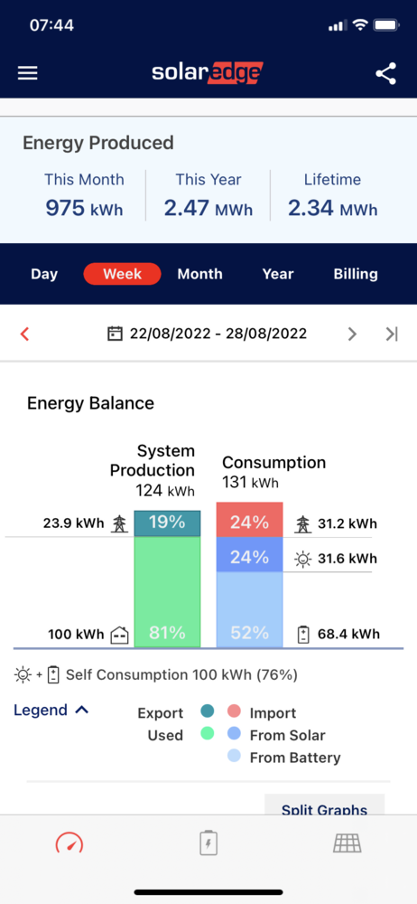

can you give your monthly and yearly quota by any chanceFor anyone needing some real world info for solar panel “effectiveness” to help with decision making here is my latest stats page.
System is 7kw installed panels (don’t remember the brand).
SolarEdge 8000h inverter. Enough headroom to add more panels in future if necessary.
SolarEdge optimisers on each panel.
SolarEdge 10kw battery.
In short,at the moment, solar is providing about 75% of our consumption.

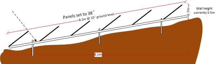

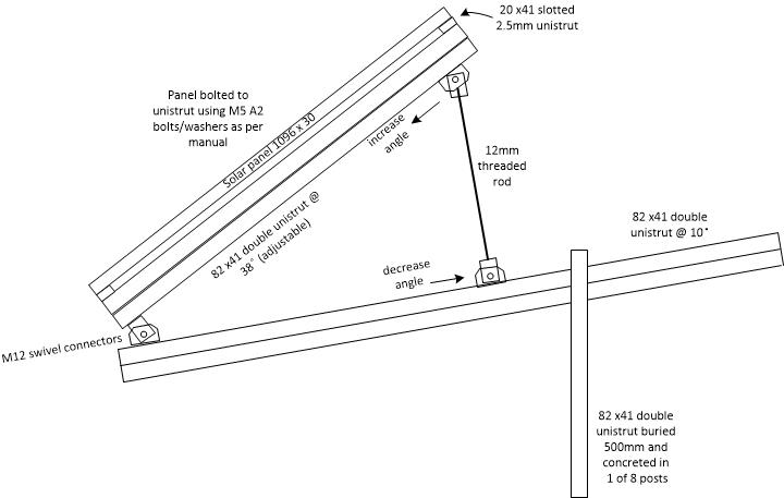

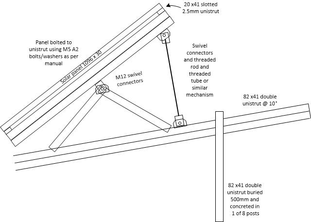

you would be far better off digging in the fronts and using the screwed bar at the rear to adjust the height of them
or you have a middle bar that swivels and adjusts from either the front or the rear
