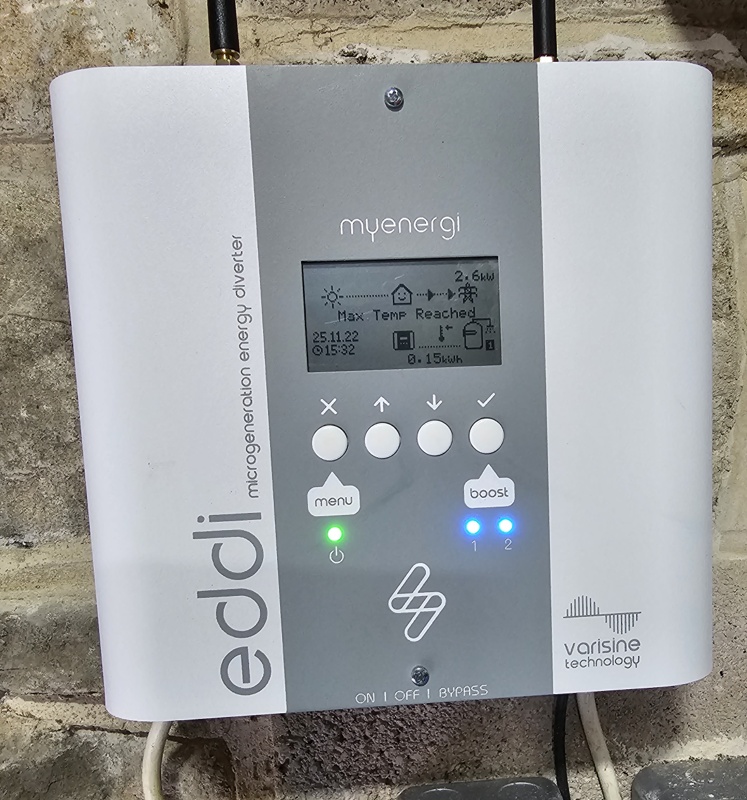

Because I hadn't set the date/time when that photo was taken, it had been turned on moments before. I was the sparks lacky so first job was to load his van up, pay him, then I set the date/time and boost time.Silly question. Why does it think it's November 2022?
You can set up to 4 boost times across the two outputs.You'll have to train the team to shower according to sun conditions!The spark and I fitted the Eddi Solar diverter today.
It was nice and sunny but the HW tank was already hot and the batteries were fully charged so we ended up exporting 14kWh of the 30kWh we generated today.
The boiler is now off and the youngest daughter has friends around for a sleep over so I'm expecting lots of HW usage in the morning so should be able to see how it performs tomorrow.
It did briefly kick in towards the end of the day but we we only exporting about 800W at the time.
The next stage is to fit a Zappi EV charger to replace our current podpoint charger. This will allow us to charge a lower rate when generating solar rather than flat out and import electricity.

Once you have batteries how-is what gets supply first managed?
by default, the Eddi checks if the hot water needs topping up every 15 minutes. If your exporting, then it diverts it into the tank.
The hybrid inverter is checking whether you are exporting much more frequently, probably every few seconds, and if your exporting then it diverts it into the batteries, if they have spare capacity.
So, the batteries get priority, after they are full the Eddi deals with it. Simple so should be effective.
I haven't hooked up the Eddi to the network yet, should be done in the next couple of days, that way I can see what is occurring more easily.
