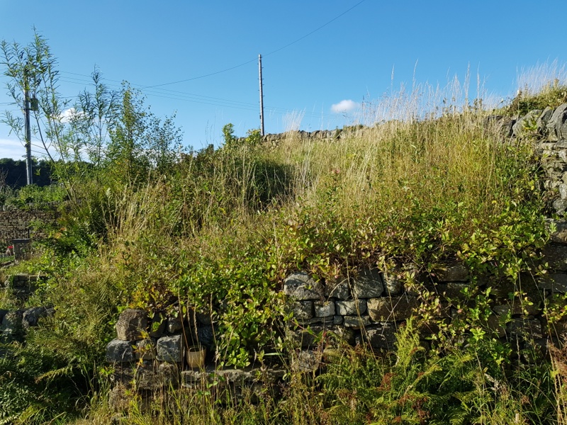

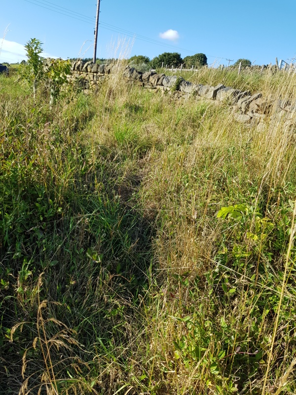

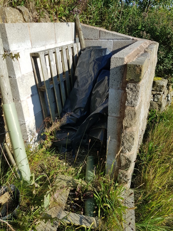

The wife has identified a small piece of land that she doesn't want to cultivate. The good thing is that its bang on south facing. The bad bit is that its a bit of a pig to get to and its next to our boundary. its also a bit small, ideally I would have liked twice the area, but we have discussed this at length. It was the site of the old Calor tank and wouldn't be used for anything else, so its a good use of a rough bit of land.
I'm not going to discuss planning on the forum. This may prove difficult and I would rather French kiss Liz Truss than go through this with our planning department, let's just say its not permitted development and leave it at that
We have told all the neighbours, and none have an issue as long as they are camouflaged a bit.

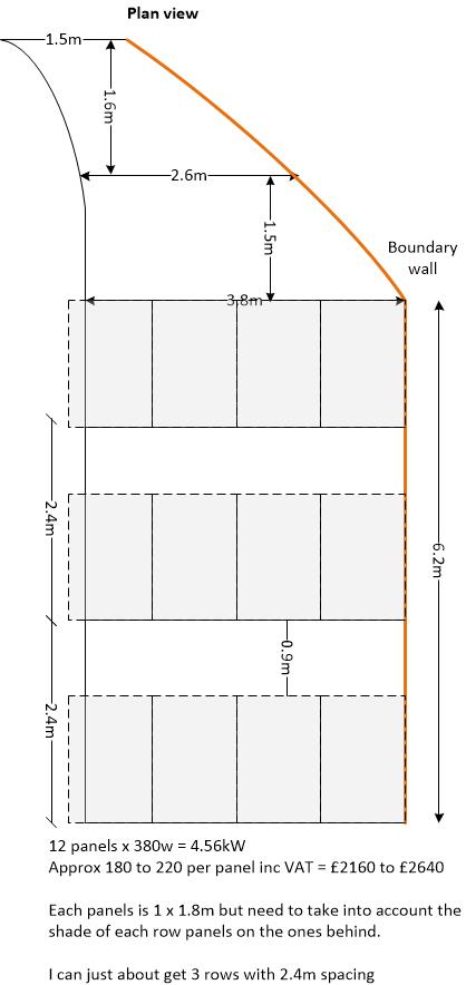

Here's the rough site survey. I'm going to do more detailed one once I get the strimmer out.

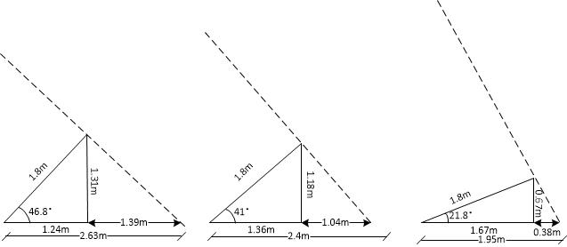

As per the text in the pics, I'm going for 3 rows of 4 panels. I need to make sure that I don't shade the panels behind so worked out the max angle I can tilt at is 41 degrees from the horizontal.
This assumes the panel is right on the floor, no gap, in reality there will be a bit. I'll rerun the calcs once I've done a better survey with a longer tape and somebody to help.
The height is important as I have promised the neighbours that they won't be much higher than our boundary wall. about 1.2m should be fine, the wife is thinking of adding a bit of trellis to make sure.

We have told all the neighbours, and none have an issue as long as they are camouflaged a bit.Here's the rough site survey. I'm going to do more detailed one once I get the strimmer out.
