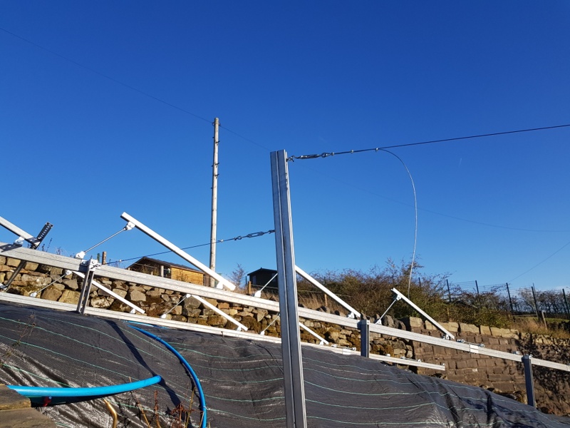

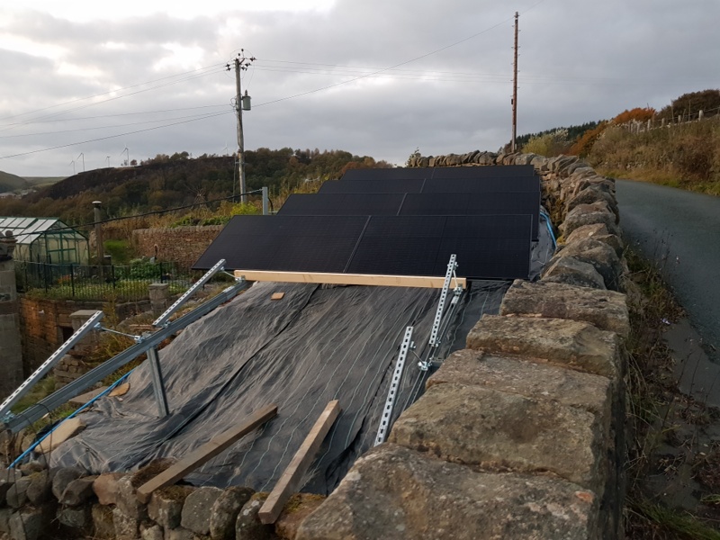

I'm waiting on some M10 channel nuts and some M10 Allen head bolts, so if they don't come tomorrow or if its chucking down again, I'll get the python tools installed and get it sending data into influxdb. I want to get some data in there before I turn on the solar.
Would need something big with windings in it - like a lathe....
), a bobcat, a ladder, rope, some unistrut, beam clamps and balls of steel.
