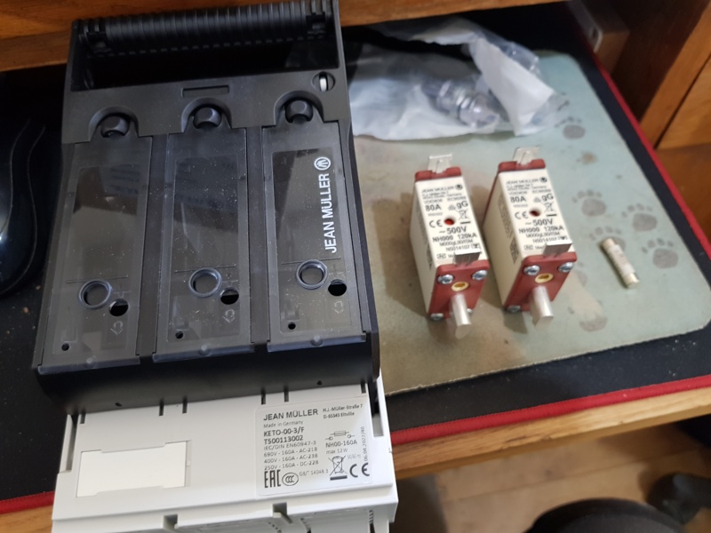

More gear has arrived. Apart from PV cable, the PV fuses/holders and the battery fuse/isolators arrived.

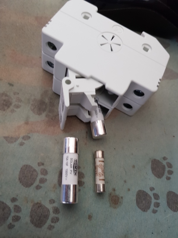

Here's the Solar fuses and holders, they are the same format as a double MCB, Standard 240v plug fuse for scale. I'll get a 4 way DIN rail box to take them, there's one for each string, the fuses are 15A

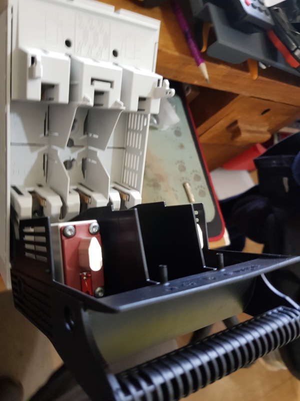

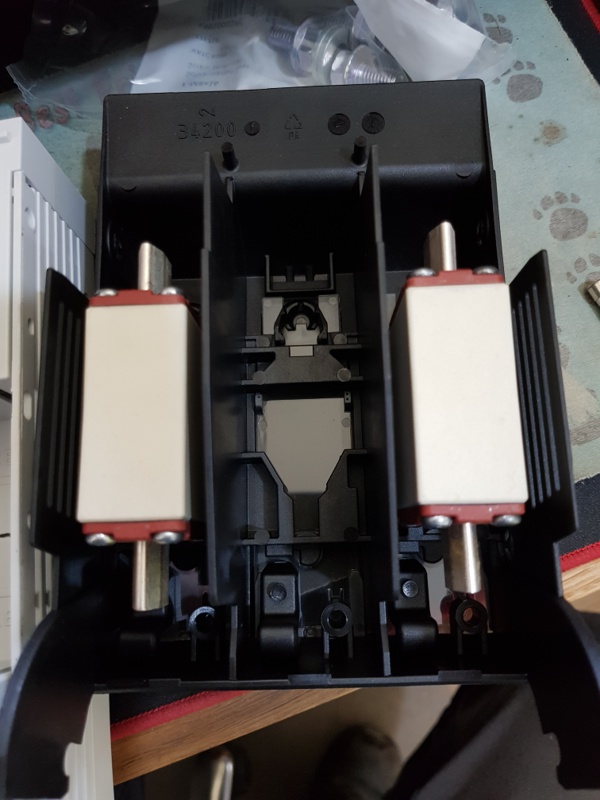

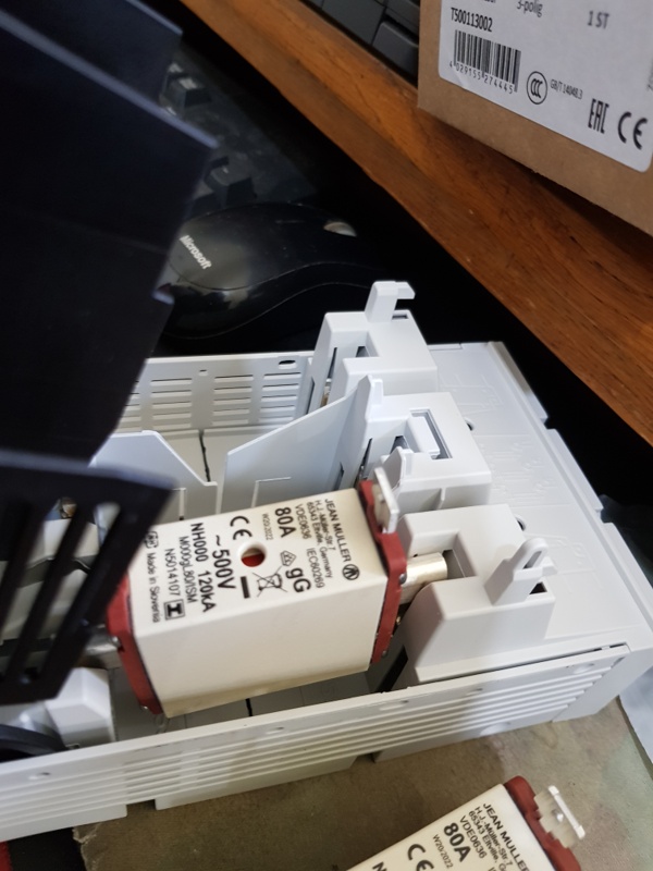

And the battery fuses and isolators. You pull the handle at the top to pull down the front cover, this cover holds the fuses and opening it pulls the blades of the fuses from the contacts
Here's where the fuses go when the cover is closed, fuse removed from cover for visibility,
And the fuses in place in the cover. Its a 3 way fuse/isolator but I'm just using the two.
It's a bit like a modern version of the big switch used in Frankenstein movies

I've seen the top one in lots of kit fed from 16 or 32a suppliesc
