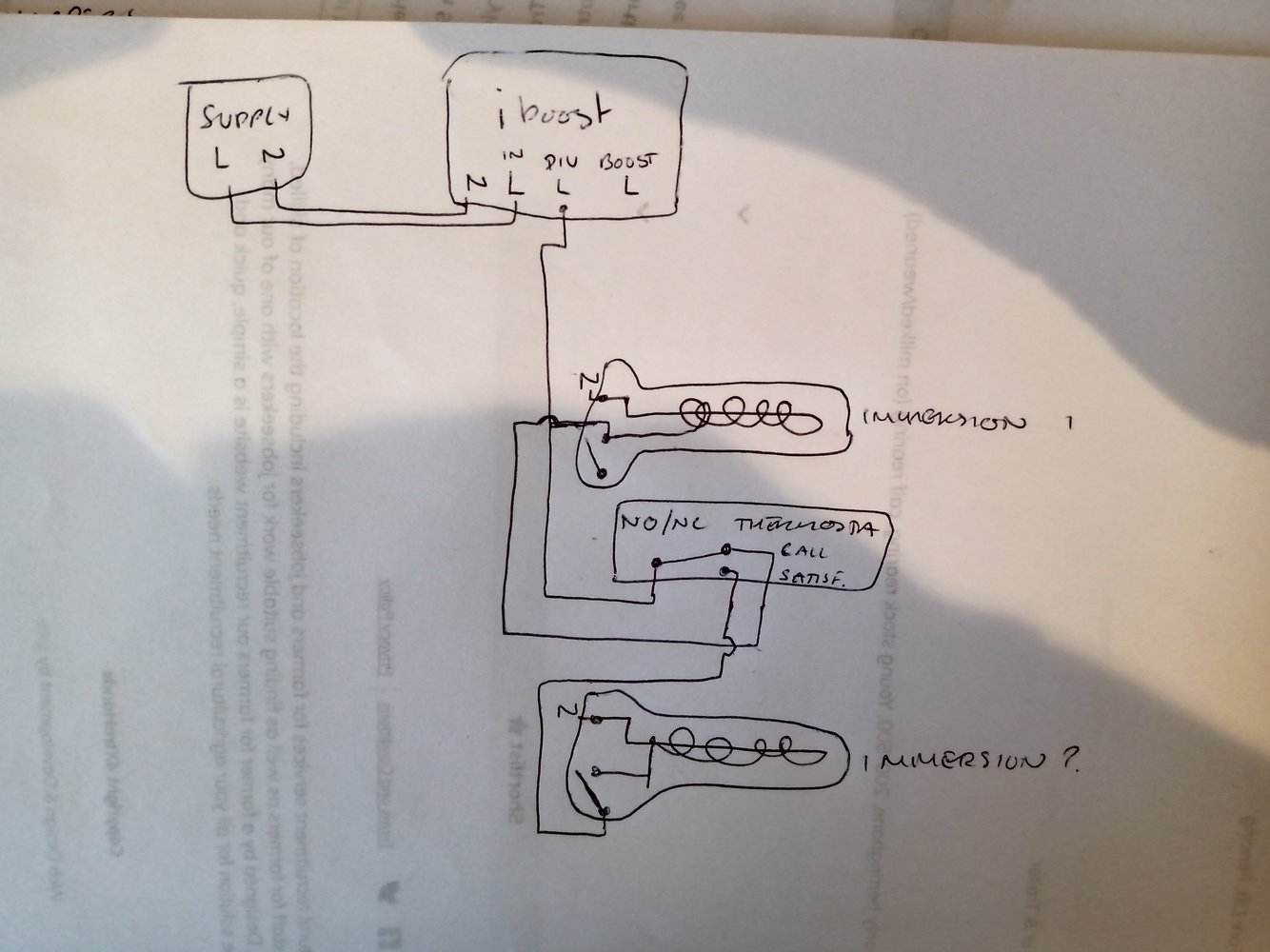

Basically, unless the Tesla route proves compelling, the MCS path doesn't offer me much. As one of my major costs is heating hot water in summer via biomass then using solar to do this would compete with charging the 12.5kWh Tesla battery. Plus my intended 4 to 4.5kWp solar install is a bit small.
So, for me, a smaller battery plus a diverter to power the immersion heater would probably be the sweet spot, avoiding export to the grid, other than a last resort.
But I'll keep my mind open until the last decision point.
I currently have a few solar diverter widgets, it's quite easy to get one to cascade charging from one hot water immersion, to another or a night storage heater. Send me a message and I'll draw a schematic if that's of interest. Am also trying to figuring out/price up assembling some bits and pieces to create a customisable plug socket that works on the principal of;
