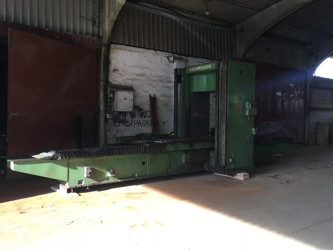

No Devlieg makes it look feebleMakes the devlieg look small, bearing in mind the devlieg is behind the doors!
QuicksandYeah I know, but whats it like where machine going?
We don't have roads that big over here....Yup, detailed up several machine tool foundations like that. Saw cut the concrete, dig down about 3'-4', fully isolate new pour
with resilient material on edges, and then lots' of concrete, rebar, and anchors.
However seeing how the OP doesn't own the facility, might squeak by with a large road plate (if you can find one big enough
to cover the whole machine in one go).
The concrete foundation is to add structural stability to the machine and be rigid enough to be able to coerce a machine better than it was made to ie pull and push off . For example scrape to 0002 then been coerce even closerYup, detailed up several machine tool foundations like that. Saw cut the concrete, dig down about 3'-4', fully isolate new pour
well when you think of weight yesNo Devlieg makes it look feeble

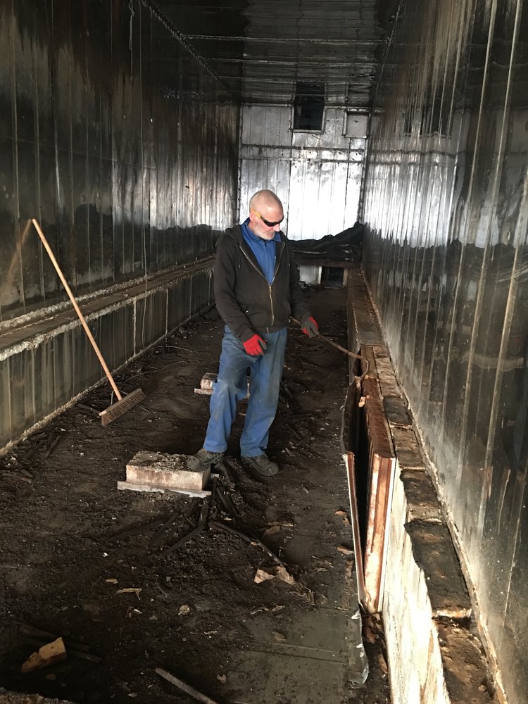

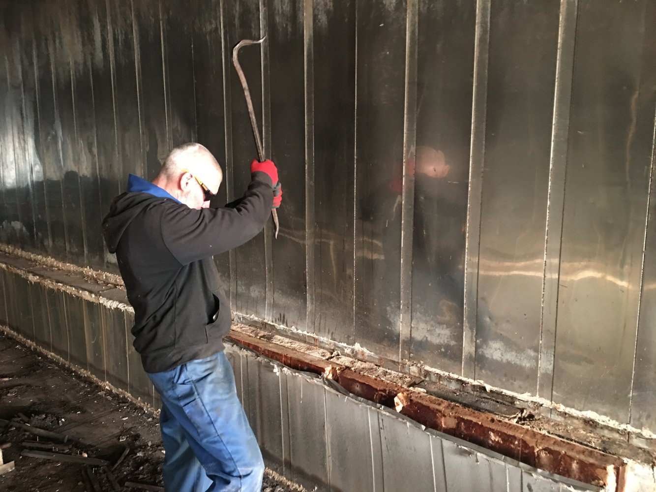

I'm just in total awe!Back at ché misery .
Need to ignore it for a bit and carry on with mini wheels and stress ain’t good on the old strawberry
View attachment 384528 View attachment 384529 View attachment 384530
