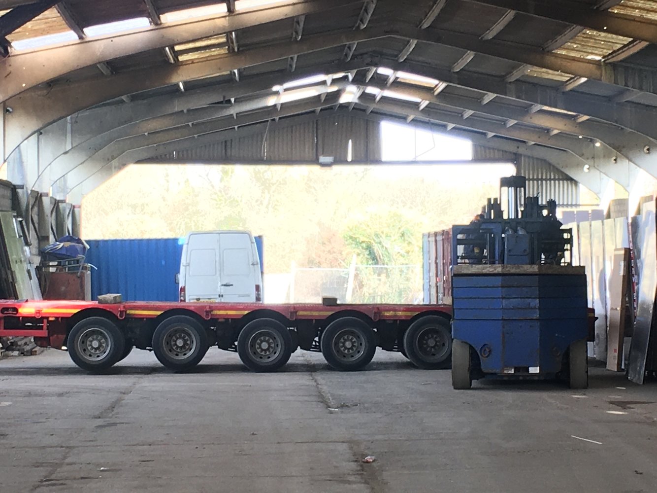

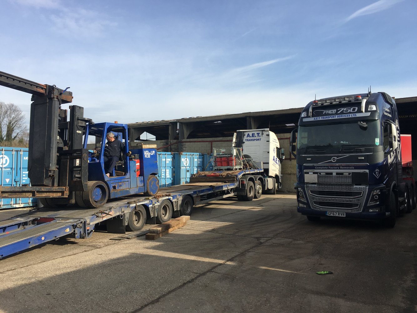

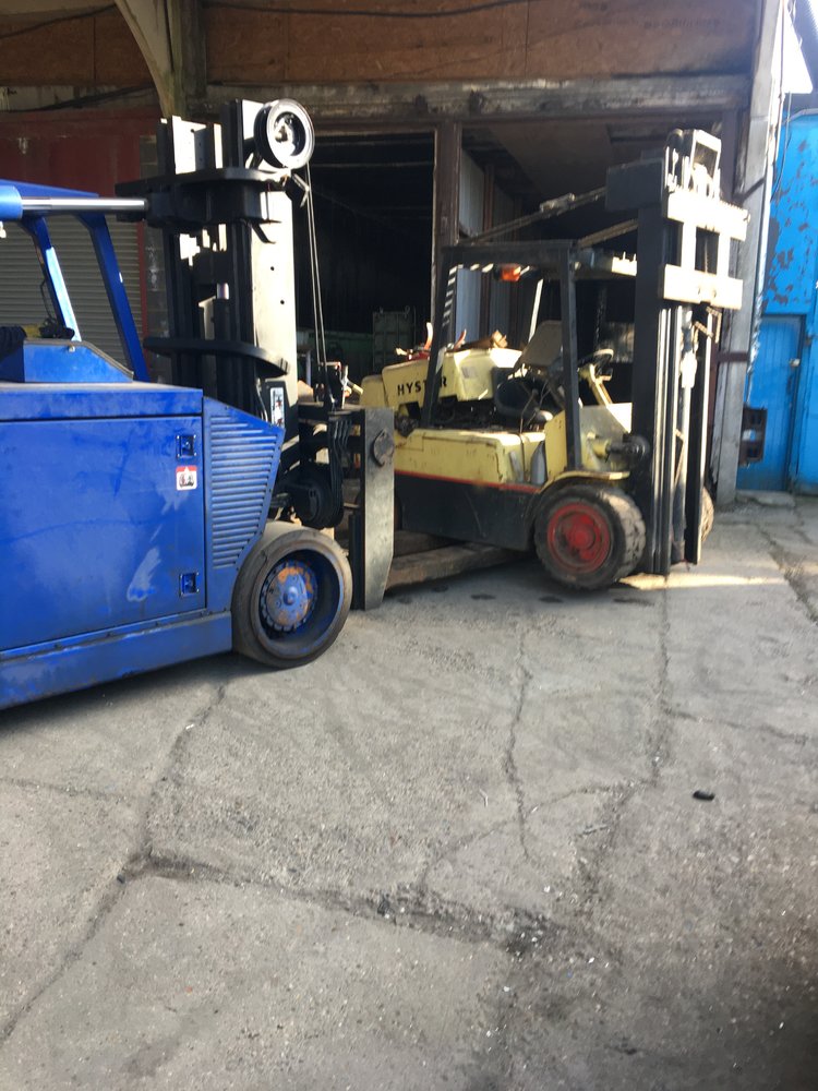

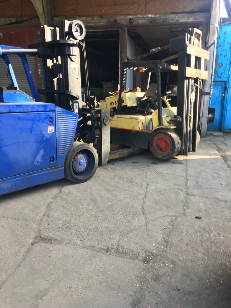

They moved my dead 10t hyster on the end of the tines like it was a toy
View attachment 384512 View attachment 384513
Yes that’s what the Versalift doesWe had some machines moved by PIC they had a 40T FLT which had a counterbalance that could be wound out to match the weight of the lift.

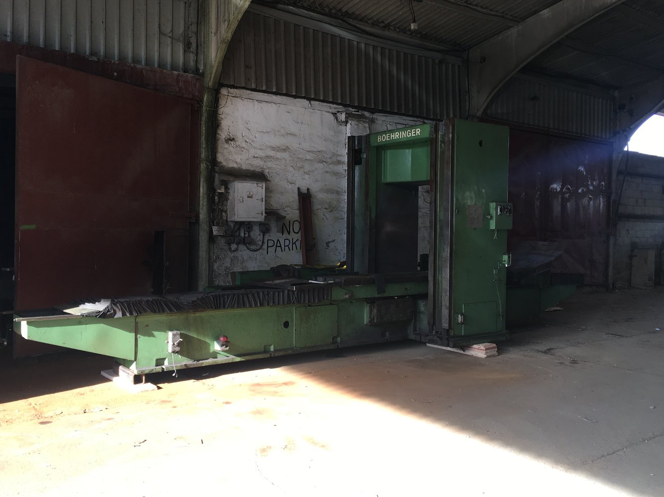

View attachment 384528 View attachment 384529 View attachment 384530
Yes my memory isn’t robustHats off to you @pressbrake1
Move some work out the door before tackling the install, but don’t leave it too long.
That’s the car parkThe floor looks a bit of a state in there. Is it ok where you have put the machine?
Will it matter to the machines accuracy, you don't want it effected it every time a train goes by!!!
I would say a machine like that would need to be on a (large) slab isolated from the rest of the floor slabThe floor looks a bit of a state in there. Is it ok where you have put the machine?
Yup, detailed up several machine tool foundations like that. Saw cut the concrete, dig down about 3'-4', fully isolate new pourI would say a machine like that would need to be on a (large) slab isolated from the rest of the floor slab
What's that, all blue forklifts lift!They moved my dead 10t hyster on the end of the tines like it was a toy

Yeah I know, but whats it like where machine going?That’s the car park
