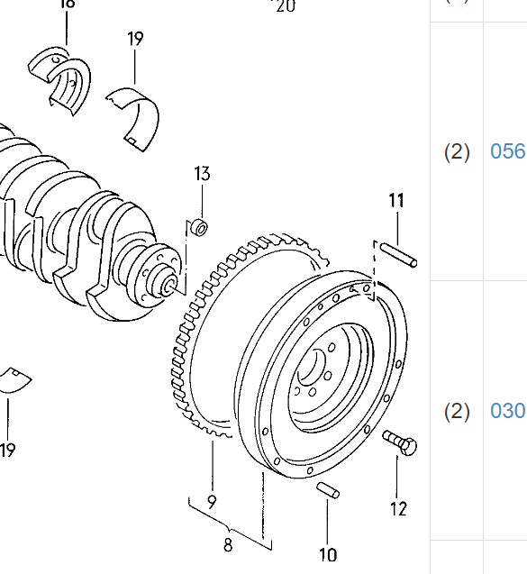

im told there isnt one on these , only the auto has oneThe pilot bearing is not part of the clutch mechanism or flywheel. It is located in the end of the engine crankshaft and ensures the crankshaft and first motion gearbox shaft have the same axis of rotation.
