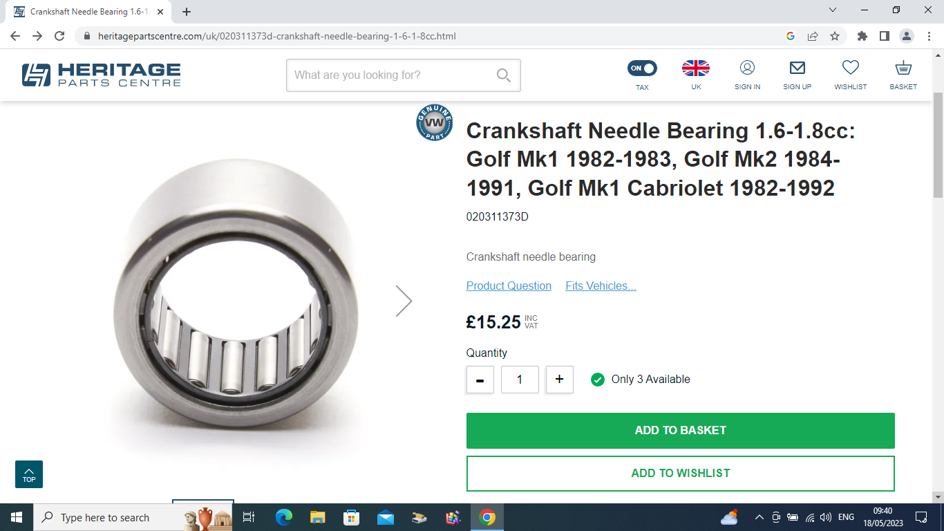

No where on the vehicle in this thread.Does anybody know where this needle bearing is fitted?
