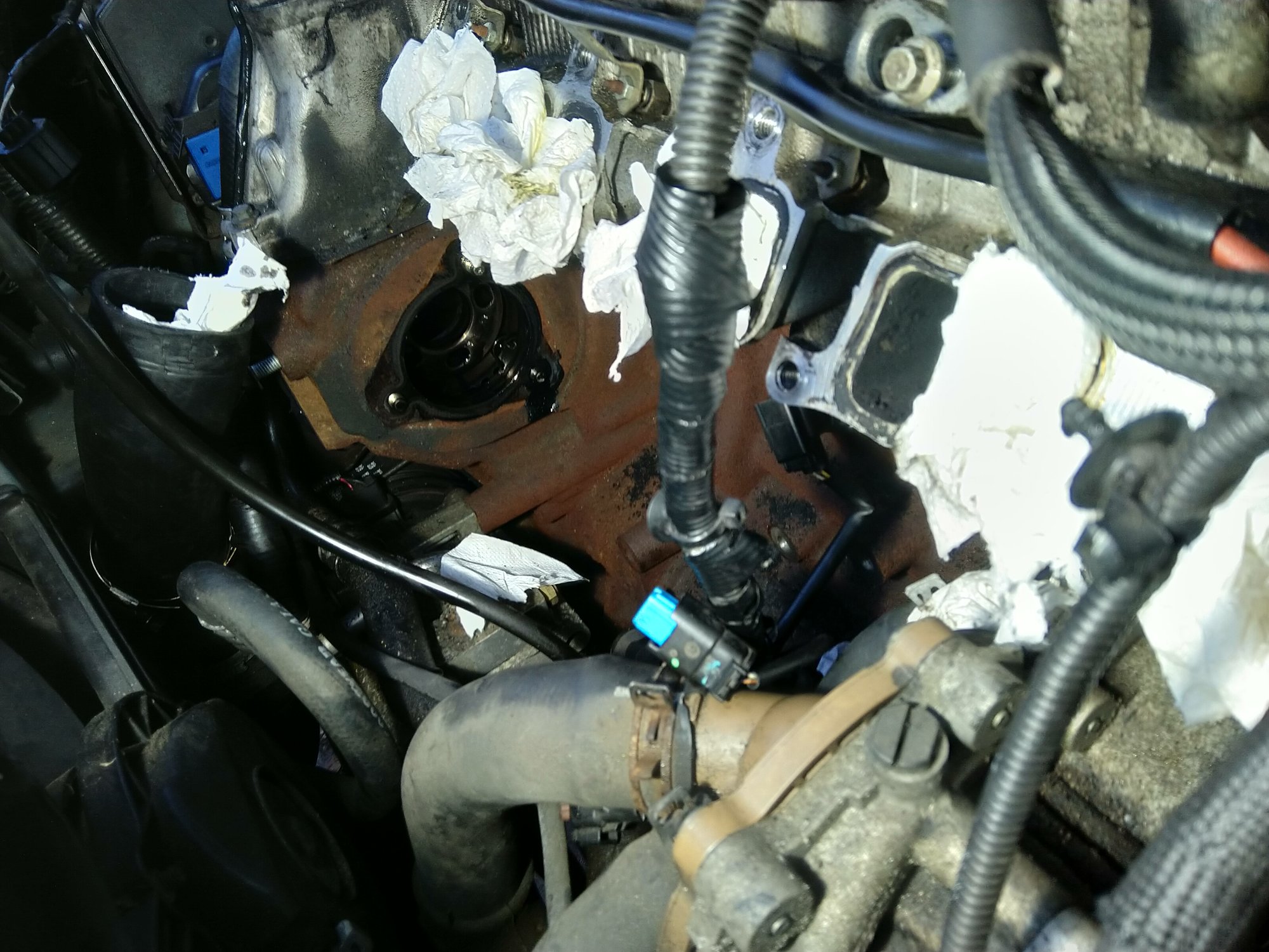

    More (not very) pretty pictures. I disconnected the High pressure regulating valve (commonly called the IMV) and all the injectors. This puts the pump in Max pressure mode. That should be much nearer to 5V
    Live data said max 1,153 Bar. Pretty sure that should be 1,600 ish.
    Looks like the pump is breaking up inside, despite no other evidence. Time to pull it apart and look for bits...

    It's commonly called a IMV, because it is an inlet metering valve (or suction control valve, depending on who's information you happen to be reading). These system regulate the fuel pressure by controlling how much fuel enters the pump, not by regulating the high pressure.
    That fuel pressure is more than enough for the vehicle to run, and I wouldn't expect it to hit max pressure at cranking speed anyway. Even with a good pump and a failed/disconnected IMV, it normally takes a couple thousand RPM for the fuel pressure to get high enough to cause the fixed pressure relief valve to open.

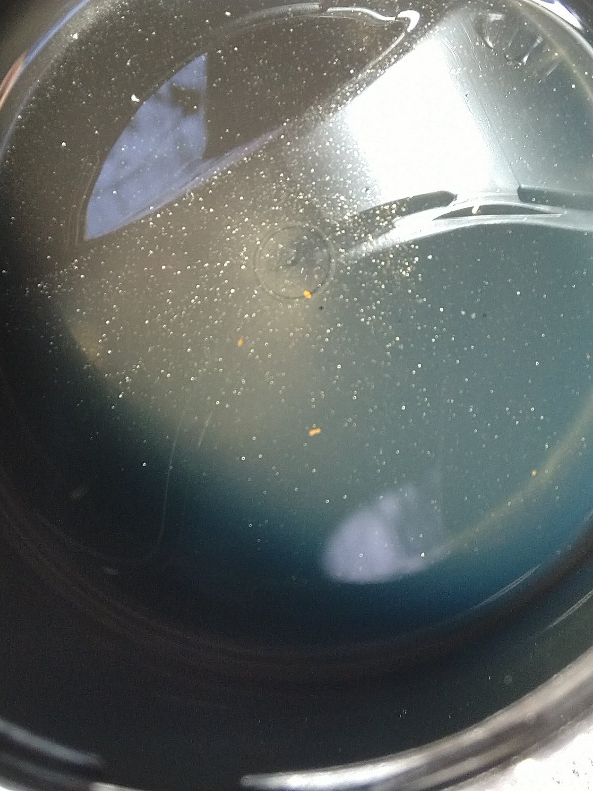

    So the bad news is in - Drained the rail into a black spray can lid and shone a torch in - apparently the only real way to check as in a jar it looks nice and clean, and the bad news is
    Lots of shiny little bits of fuel pump. :(
    Need to look at the costs (and the sills) and see if it is worth saving. As the injectors will be just clogged and not worn they might be cleanable - though I might also be able to pick up some low cost new injectors. - The pump is the question

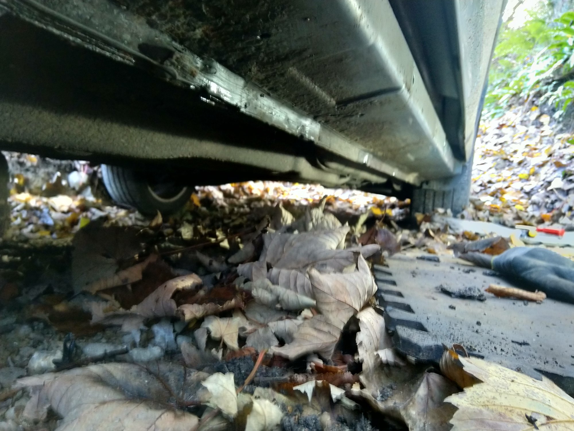

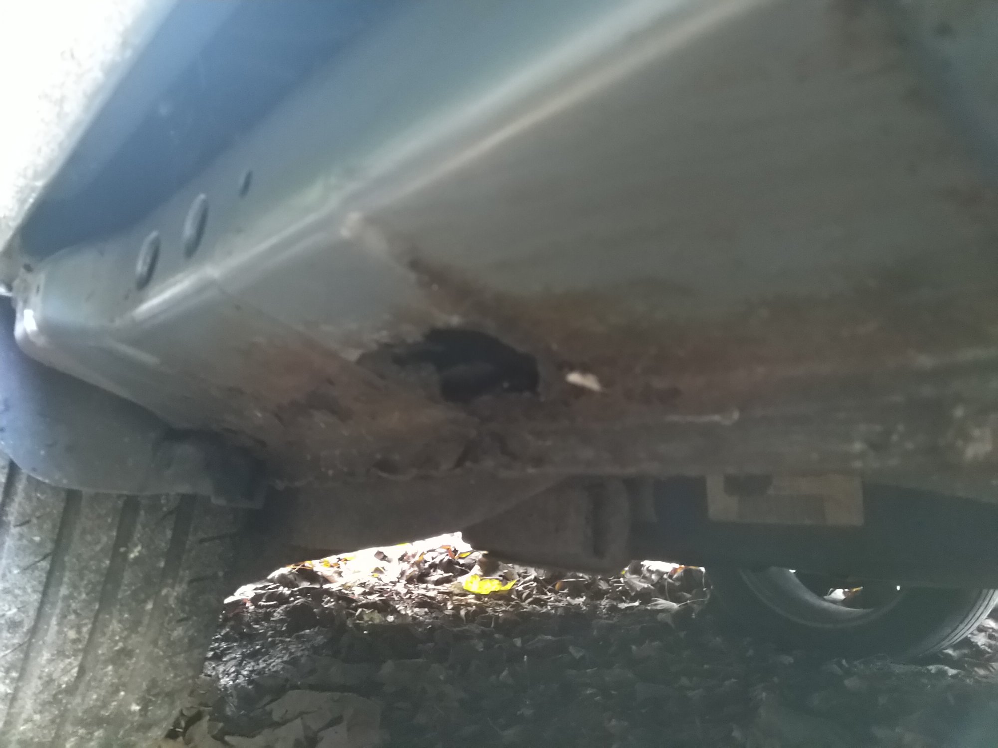

    Well the maths results are in.
    Getting all the parts used and compromising by cleaning out and blowing out with the air gun/atomiser everything up to the filter (ie tank and lines) and replacing everything after that keeps the parts cost reasonable. Will also whack a couple of neodymium magnets round the filter as well.
    Just had a good look and a tap around the sills, I have one hole to patch with and the rest looks ok with the snake cam.
    If I scrap this one I will only have to buy another one as I am actually looking forward to driving a Jag now. Since they are 1.5-2k I have a bit of budget as I bought it for not much more than scrap money and have £72 of parts in it so far. Plus, I am stubborn!

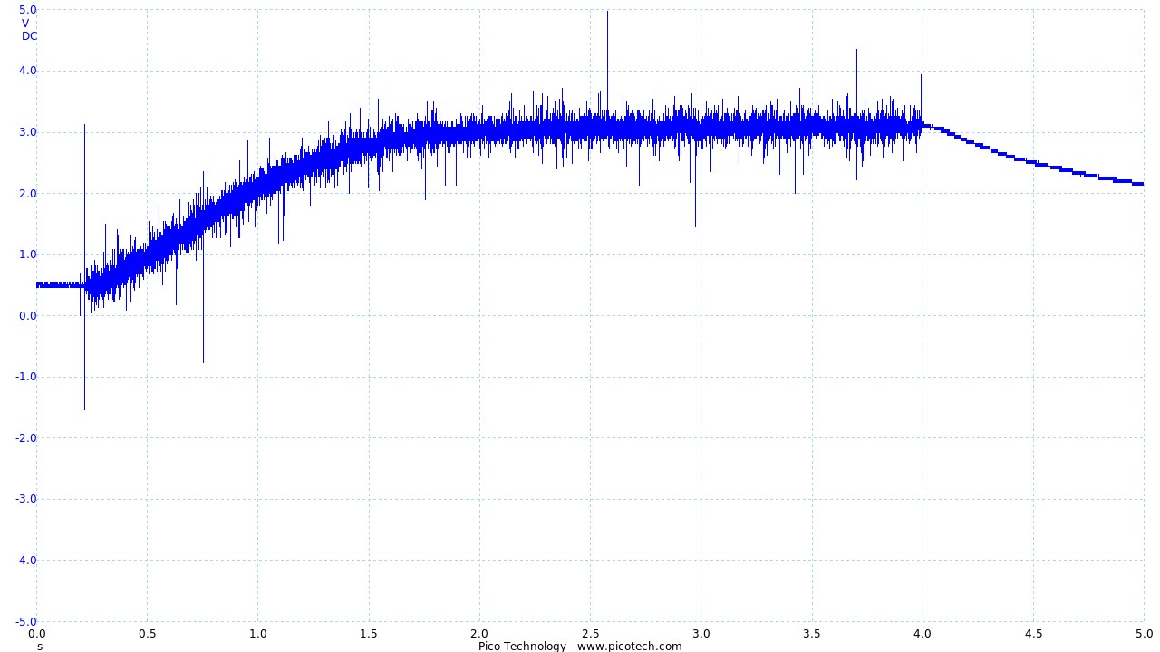

    To start, visual checks - the usual loose pipes/egr issues, stuck turbo actuator, fuel in the tank. I found the Crank sensor not secured and cracked. Fixed but no start. No codes showing
    1st check - Fuel flow? New filter is easiest and prudent. No start
    2nd check - injectors firing = no, why ? - Not enough rail pressure due to huge injector leak off so ECU not commanding. Swapped injectors, now have fuel pressure so injectors firing but still. No Start
    3rd check - relative compression - slightly down on 1 cylinder (- this was probably one of the injectors that were not tight prior to above exchange)
    4th check - Are the injectors firing at the right time ? Check timing Crank vs Cam, two nearest "known goods" for this model engine put timing 1 tooth/20 degs off at crank - these "known goods" not being correct for exactly this car were the reason I went down the timing route. Though it was a data error it is a good job I did as the tensioner was badly installed, the alternator bolts were loose, the idler was about to fall off and the crank pulley bolts were at about 50nm.
    5th check - scope the rail pressure - dropping out due to air ingress from faulty new fuel filter. Fixed.
    6th check - scope Injector Vs rail pressure - This is when I saw that only Cyl 2 firing was causing a rail pressure drop, which led me to wonder how 3 out of 4 replaced injectors could be not passing fuel.
    7th - Swarf test = bad pump.

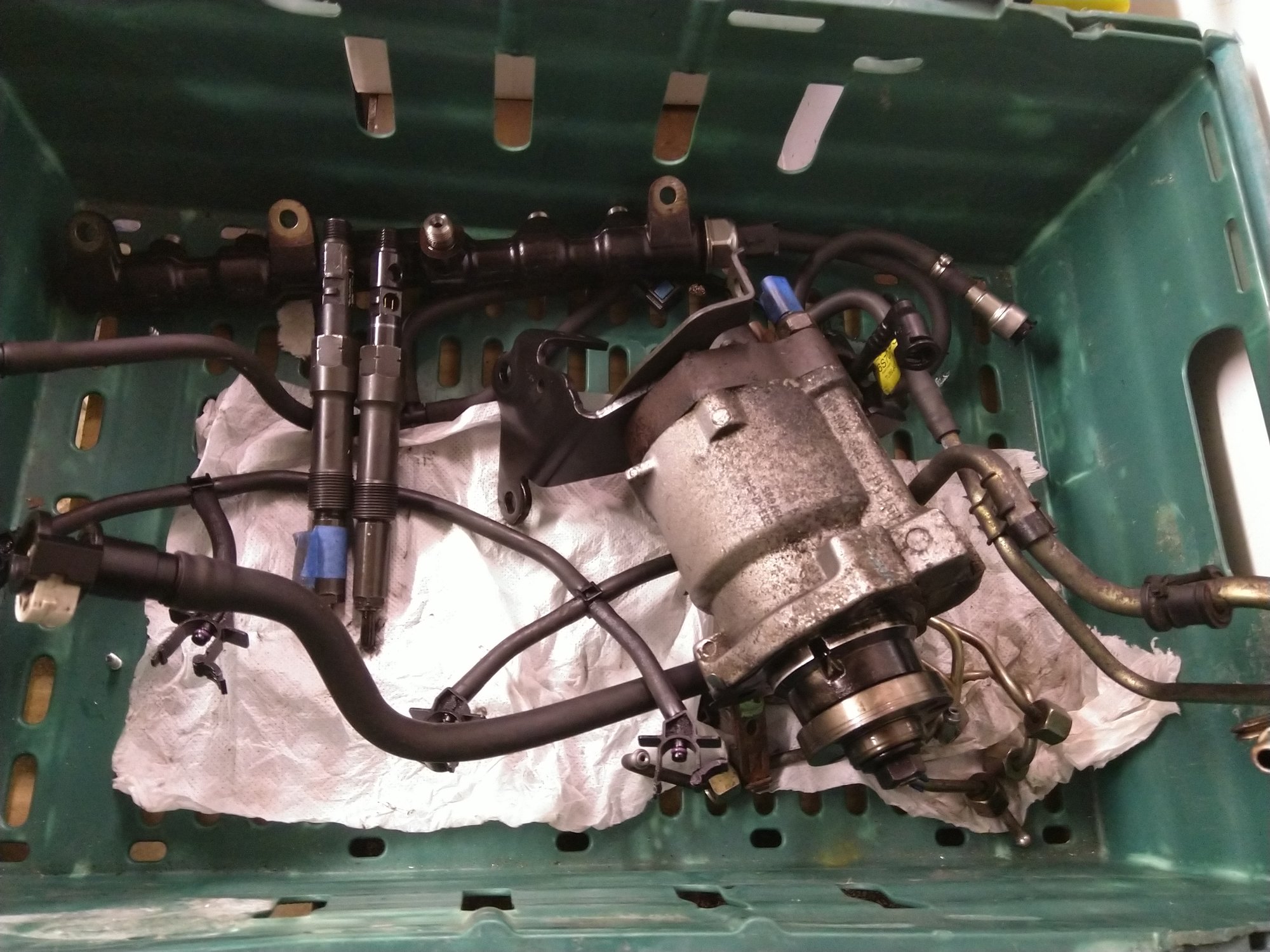

  17. Wightsparks
    Wightsparks Forum Supporter
    Messages:
    1,368
    Location:
    Wight

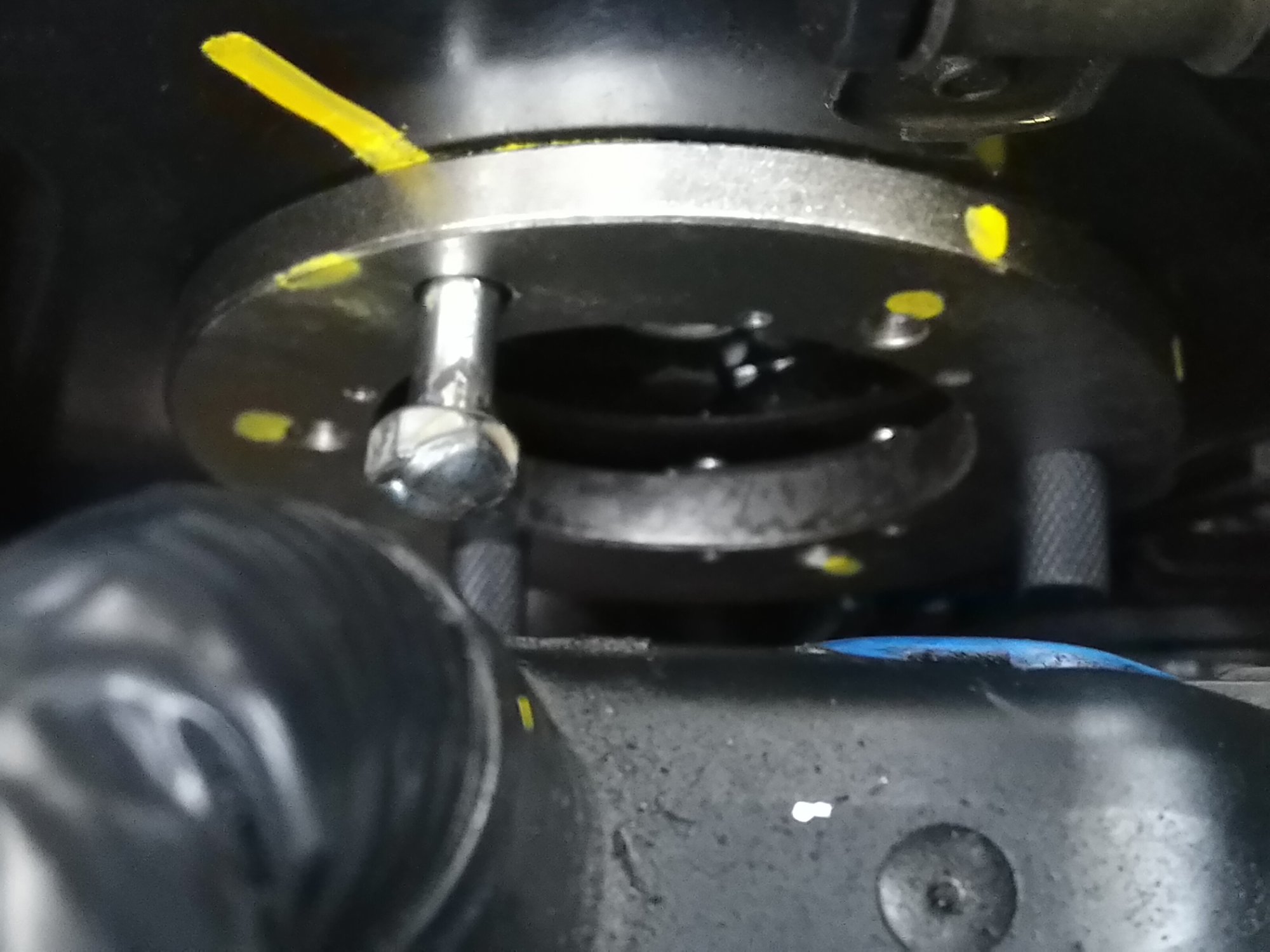

    Crikey what a job getting the fuel pump out. Technically it's only 7 bolts, but the amount of alignment (that you can not see) and lack of space to work is a nightmare! I made a removal tool by welding a nut to a chopped off T45 - but by experiment and measuring it had to be 56-58mm long as any shorter and it would not reach and any longer it fouled the body work.
    Anyway after much swearing and blood the front bits are out.
    This metal disc (ebay special tool!) clamps on to the timing cover, and the pins stop the sprocket from dropping. First align the holes in the sprocket with the pump Torx heads behind it (with a snake cam!), then align the disc with the holes in the sprocket, then pin the lot, removing one at a time to get to the Torx heads. Bit tight as you can see - and no, that is the ABS pump partly in the way and I'm not moving it!
    Out at last
    All junk, more to come!
    slim_boy_fat, eSCHEn and stuvy like this.
