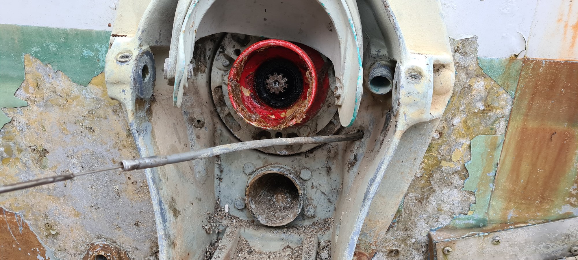

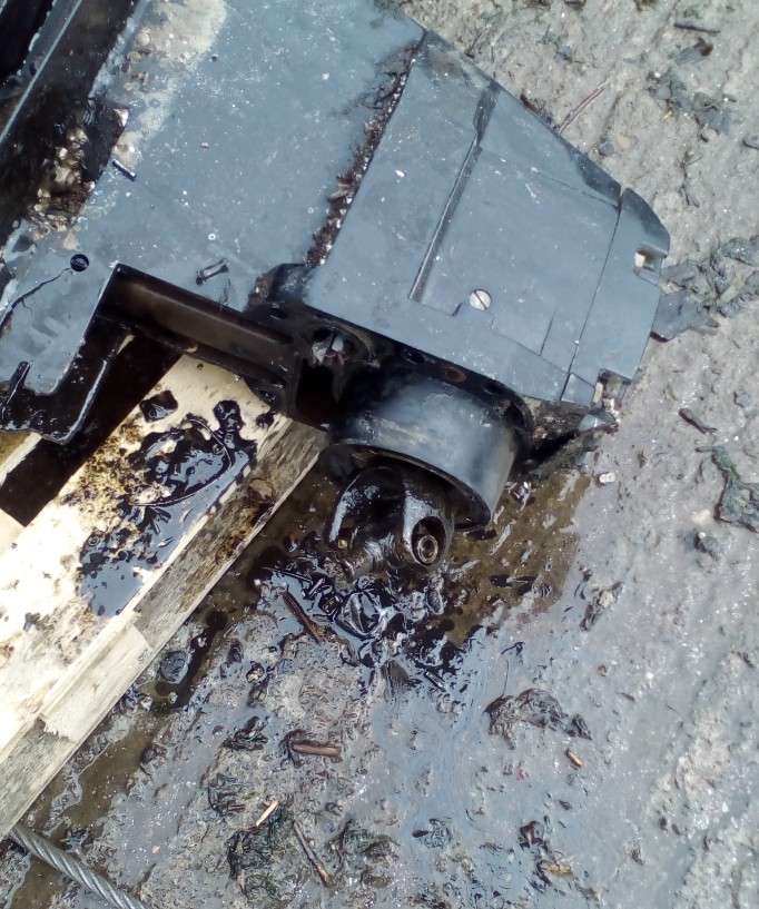

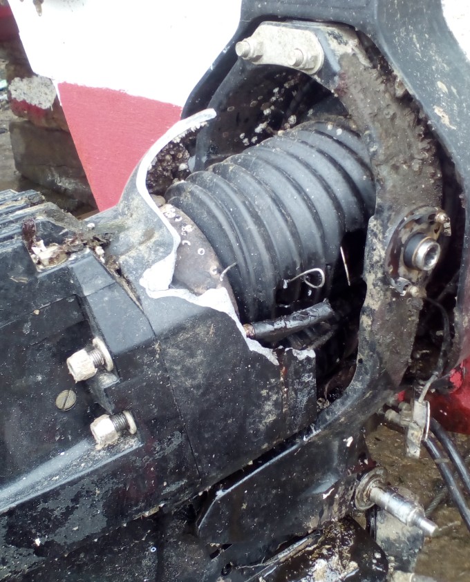

Never worked on the Pentas but the Bravo ones are a real PITA, often get the inner bearing collapsing and seize up and they are a real pain to remove.Okeydoke, had a quick faff tonight, sods law i dont have the correct size Hex to remove the selector cover, going to get a new set tomorrow.
Now its not the engine at all i am 100% on that.
I got SWMBO to rock the remote lever back and forth a few time while i turned the engine by hand in both direction. now intermitently it moved in the correct direction but i had to stop due to me being a frickin cripple.
It hits solid still with no noise of crunch etc. i reckon the problem is between the UJ in the drive and gear box.
The propellor goes into gear though ( locks up ) when selector is put in forward or reverse and neautral.
so my thought on kit being between the UJ and gear box.
