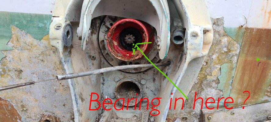

thats the plan kida, i will sort the gantry out get them outWell, pull the engine apart then, still can't think of any reason an engine would only turn in one direction, keep us posted.
Pull the rocker cover off - soon see if anything is amiss.Well i removed the drive leg so as to have the engine in.
So that leaves just the engine in there.
Somebody here said it could be a stuck valve ??
so engine out and strip down and what not![]()
Dont thé Volvo engines have cam belts?I was thinking an over stretched chain dropping back on to the sprocket and jamming ? that would be on the non tensioner side tho![]()
It has two timing gears, no chain or belts. The larger gear has a fibre centre which can shear, suggested earlier in the thread to check this.Dont thé Volvo engines have cam belts?
