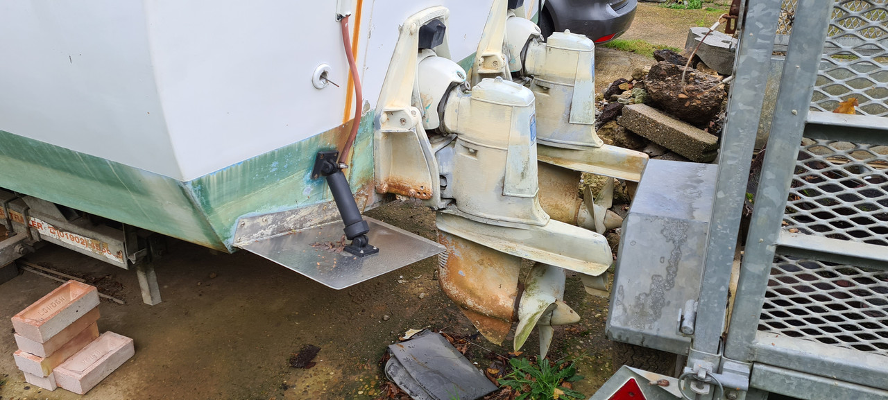

but the engines still rotate in same directionArnt the legs directional on twin screw outdrives??
I have a funny feeling you have counter and clockwise engines, if this is the case the starters will be different and you may have repaired and fitted the wrong starter to the wrong engine,pure armchair speculation of course. Jabsco pumps can bind if you reverse them.i thought of that when i went through the outer fitting like alternator and pumps etc. but the impeller is only rubber and you would think there would be slight movement, evena bounce back. but its solid.
i will check it if all else fails though as i sod yo get to..
i only tried to turn it in the correction direction and a very little the other to see if it was seized.Are you getting full rotations one way but not the other, or are you just trying to bounce it one way but finding it wind for the other? If it’s only been rocked one way but solid the other there’s every change it’s FUBAR and you’re only rocking the play out of it
ill look if the VP AQ 130 engines are sold in different rotation.I have a funny feeling you have counter and clockwise engines, if this is the case the starters will be different and you may have repaired and fitted the wrong starter to the wrong engine,pure armchair speculation of course. Jabsco pumps can bind if you reverse them.
Bob
If you’re only rocking it, and it moves one way but locks up the other, I would be pulling the head and sump to see what’s come adrift and is locking it upi only tried to turn it in the correction direction and a very little the other to see if it was seized.
i will but i doubt it as there good engines, i am prepared to rebuild them.They have the late big valve B20 heads I see, nice. They can turn either direction when there are no issues. If by chance you are getting rid of them let me know please would be interested in the heads.
i totally agreeOk I have realised they are basically 240 car engines, Volvo surely would not have made the investment of building an anticlockwise version..
Will it turn a full turn in one direction ? are starters fitted or out, drive shafts off will tell you if gear box problem.
Whats different with the inlet system, on right hand motor is it just air cleaners on 90 bend or shorter inlet manifold
Does not look like it got a lot of love before you rescued it, can see why you want them out, good tidy of wiring, pipes, etc & then some sound proofing, whats the rest like (photos)
well whod a thowt it.@W.olly `s engines may well both turn the same way Jerry , its merely something that needs checking out, reverse starters are available for the AQ130. The B14 and 16 engines are used in cars and reverse cam gears are available for those.
