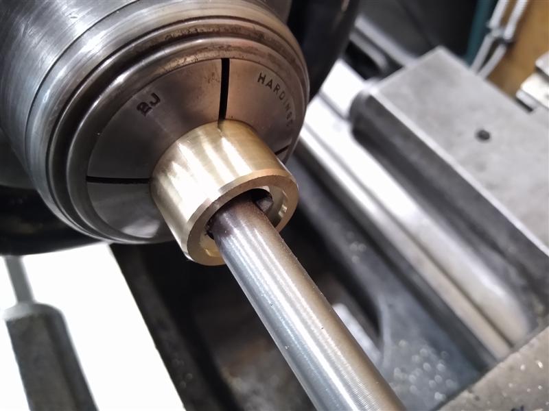

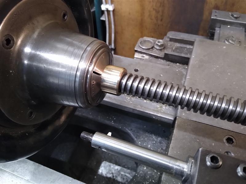

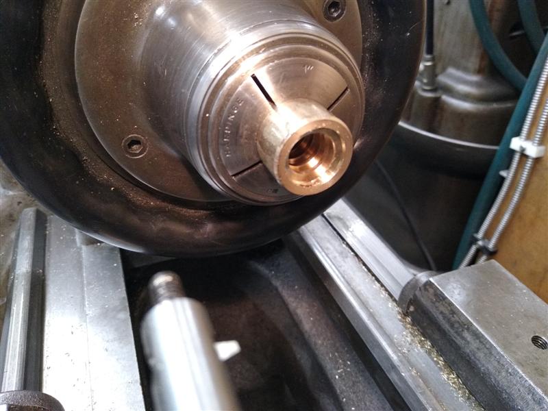

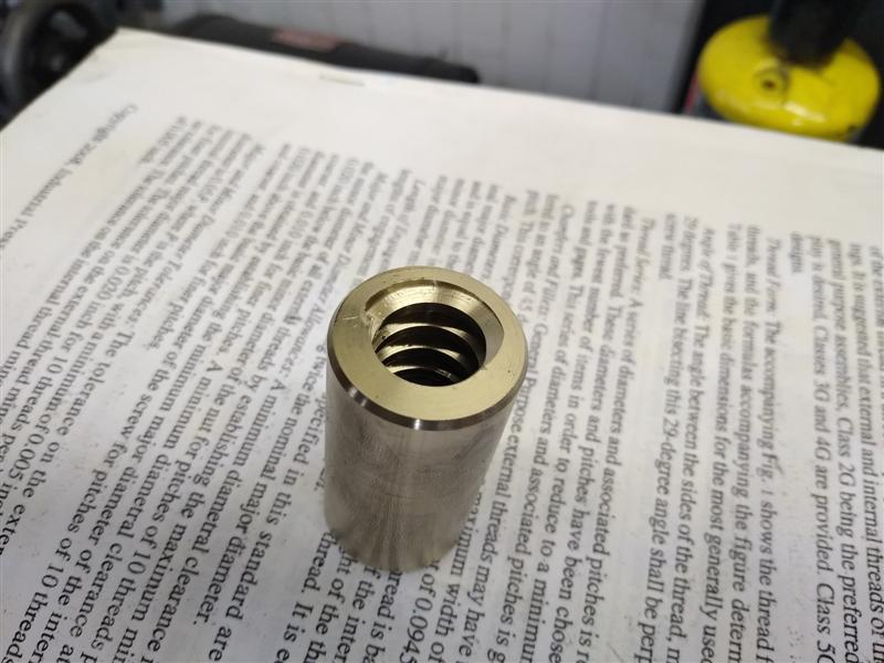

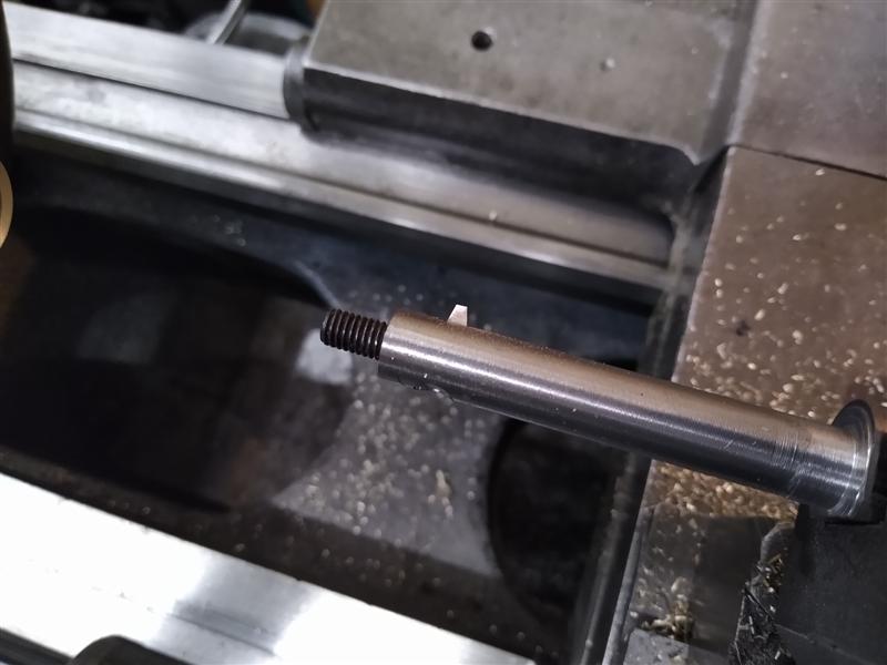

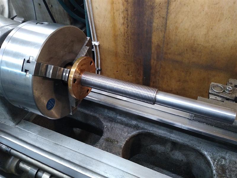

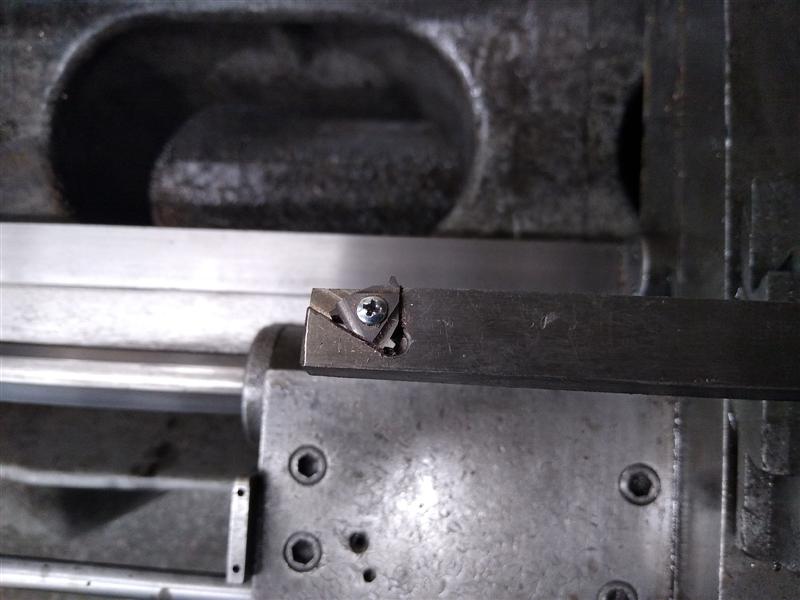

    Cross slide nut is all done. Turned out to be an easier job that I thought it would be.
    I ground a cutting bit from an old 6mm carbide end mill and turned a piece of tough steel down for a boring bar.
    Cut a small relief groove in the end of the nut, just as a visual guide as much as anything. Also checked I had clearance all along. I'd allowed 12 thou (0.3mm).
    Happy with that I cut the thread in 5 thou passes.
    The screw fits really nice and snug, turns smooth too.
    Nut ready to go in the holder tomorrow.

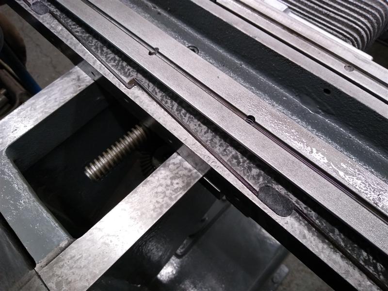

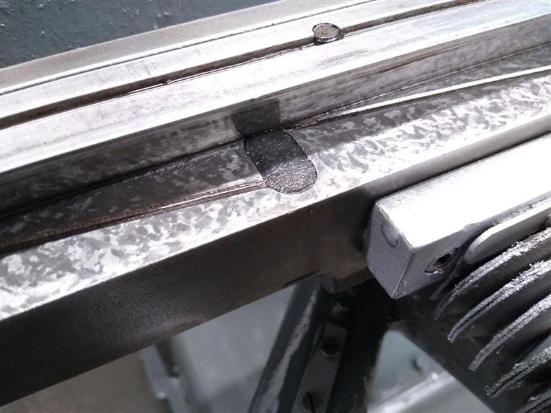

    As I suspected would happen, scraping 12 thou off the bottom of the table and probably 4 or 5 from the top of the cross-slide has caused the table to ride on the gear and rack rather than the ways. Here you can see the gap both sides.
    This might be the reason the machine was taken out of service because of course I only took that much off the ends, the middle was already that low.

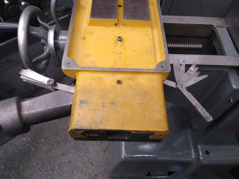

    I put feeler gauges under the table until they were lightly pinched both sides. I did this right opposite the traverse gear that was holding it up.

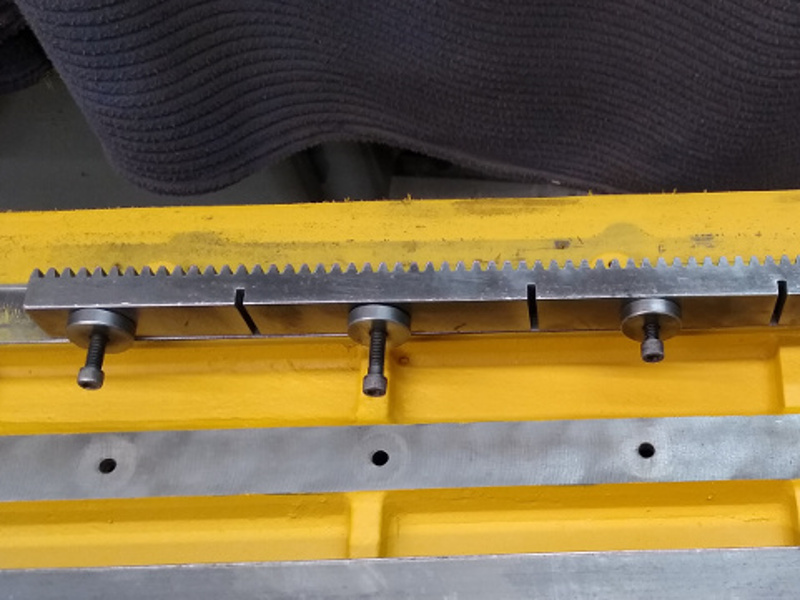

    The fix was simple enough, I just machined 15 thou off the spacers for the rack. Effectively lifting the rack up off the gear.
    Once I did this there was no more constant interference but there was a 'lumpiness' caused by some ham-fisted removal of the gear previously. The corners had been beat up a little by someone using too hard a drift. They had attempted to dress it with a file but not very successfully. I put the gear in my lathe and turned the corners off. After that the table travel was perfect.

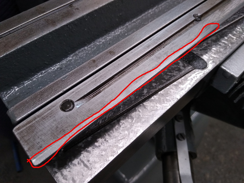

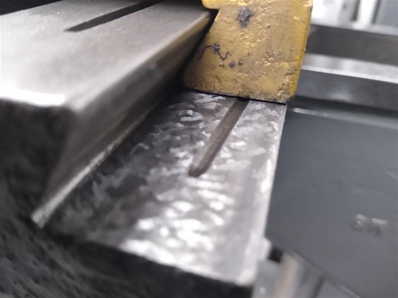

    Did some painting today. I found that you cannot brush paint enamel over yellow filler primer because the enamel paint melts the primer and you get a sickly grey-yellow mix as a result :(
    I also made some new felt oilers for the table. The old ones were rock hard and made a noise like a dropped dice. I only had 4mm thick felt so I had to cut two per well and spilt one in half. Thankfully they peeled apart easily.

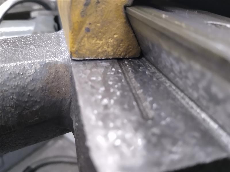

    Then my heart sank when I noticed this:
    Yes, the bloody table is riding on the top of the gib slightly. There's a small lip just above the dovetail and I've used up all the clearance.So sometime this week the gib is going to have to come off so I can mill a few thou off the top (or I'll have to set up the fly cutter and cut the lip some more). Then I'll have to re-adjust the whole lot again. Oh well, onwards and upwards!
