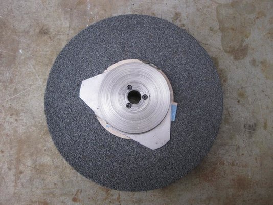

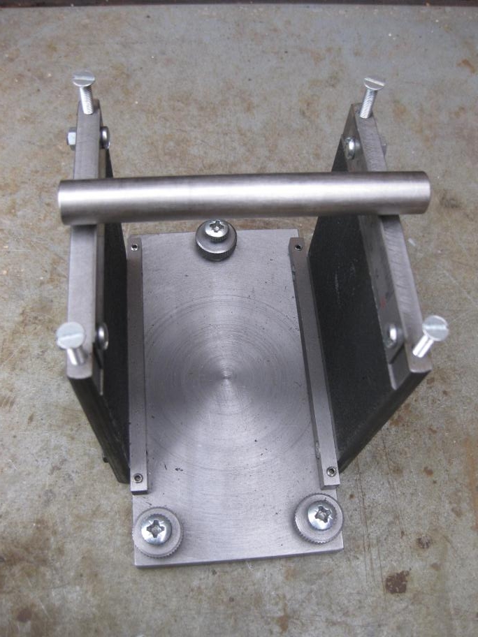

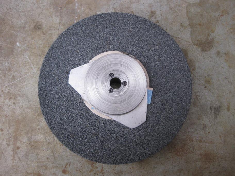

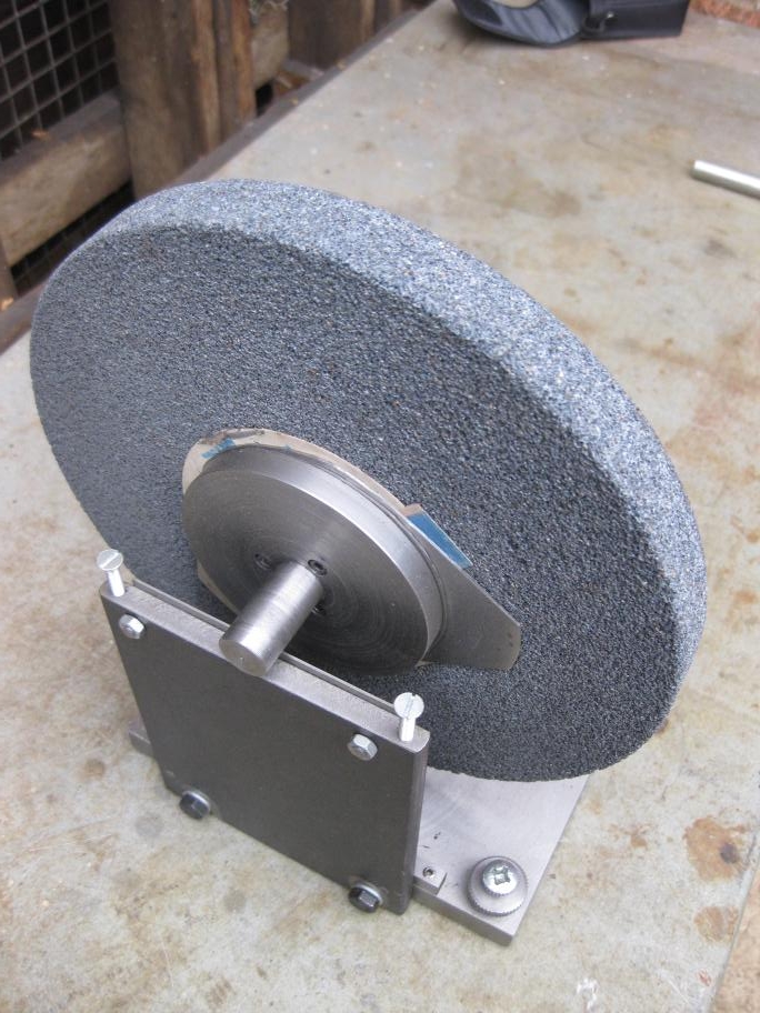

  7. Laurie Tedcastle Member
    Messages:
    37
    Location:
    NW Northants (UK)
    @pete,
    Unfortunately I'm not familiar with the Eagle and you haven't shown a photo
    of the spindle and wheel and flange(s) separated off the machine.
    Many articles and letters in magazines such as ME and MEW lament the poor
    location of grinding wheels on bench grinders particularly when pressed metal
    flanges are employed. In MEW there are articles about improving this and also
    balancing said wheels.
    I have 2 bench grinders and have made dedicated hubs for mounting the wheels
    with provision for balancing. These wheels are normally fitted with plastic
    bushes, so with these removed there is room for my dedicated hubs. I suspect
    my machining capability is somewhat less than yours, but after balancing I can
    stand a £1 coin on edge on the machine with it running. I need to sort out a
    decent dressing mechanism.
    8" grinding wheel with dedicated hub and balancing "ears". The ears are cut
    from 1mm sheet steel and rotated to provide balance.
    [​IMG]
    The simple balancing jig. The "knife edges" aren't quite - I cheated and cut
    a cheap thin steel rule in half! Three screws for levelling & I use the level
    from my M&W combination square set to set it up.
    [​IMG]
    A wheel in position and reasonably balanced - well it hasn't rolled against the stops.
    Perhaps you could do something similar although you might need to find a wheel
    with a larger bore.
    Laurie

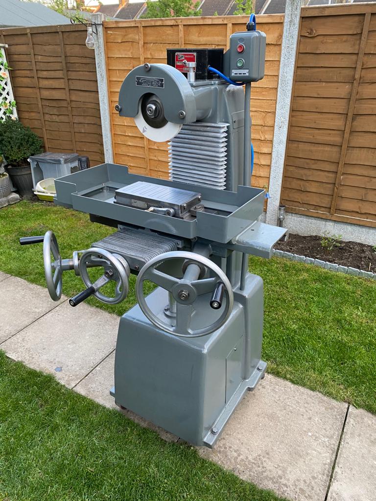

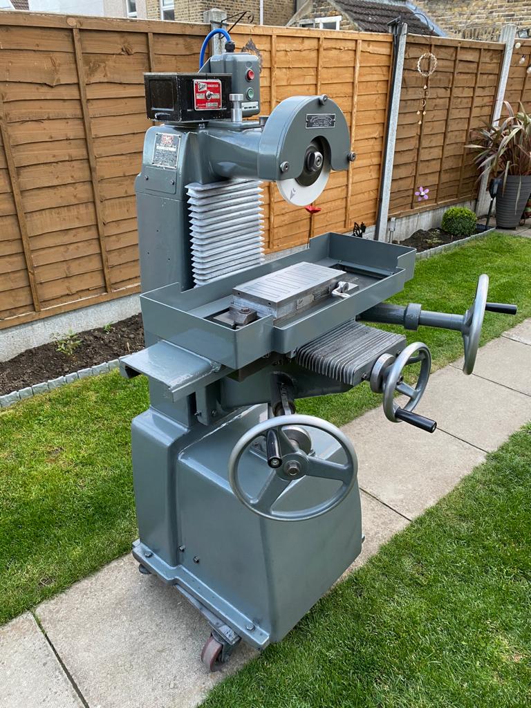

    Well, I'm calling this done. I do have to fit a tall end guard and one day I'll get around to hooking up coolant but for the time being I'm very satisfied with how it's come out. I wheeled it outside for some daylight pics.
    Funny that Rob Cox and I both finished our rebuilds of the same machine on the same day!

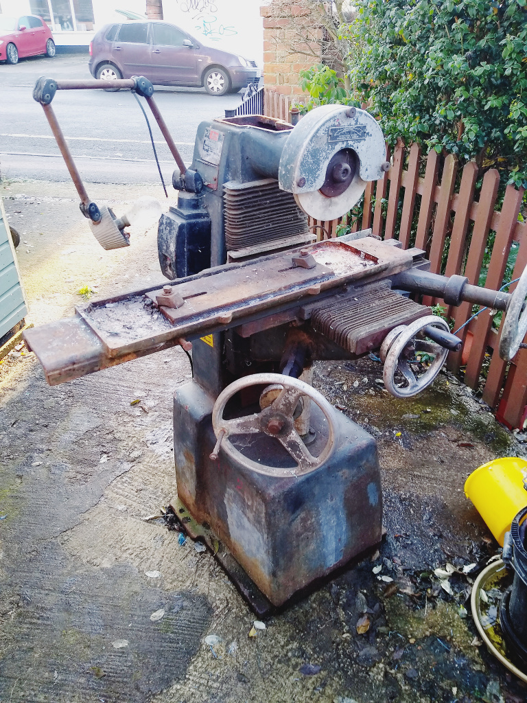

    Thanks mate. Bit of a difference eh?
    slim_boy_fat, Shox Dr and Parm like this.
