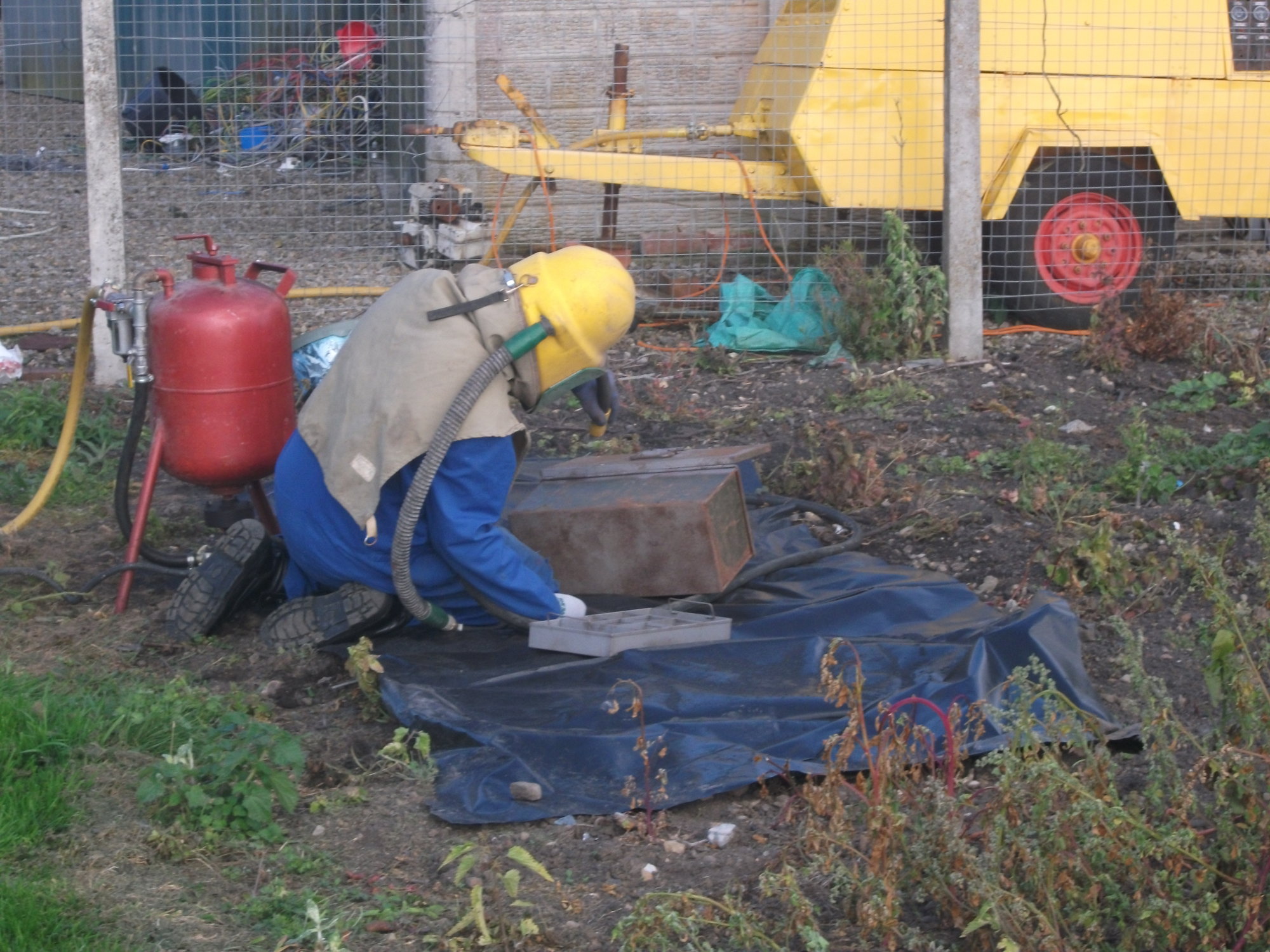

put some kiln dried sand in its more abrasive but still wont have much power even on ally being a suction gun run it through a pressure pot at 90 psi and it will skin you alive a steel car wheel can be done in no time
I wouldn't due to the silica production
was just doing a test here with new bigger grit valve I cast and made for using heavier 1.5mm grit
