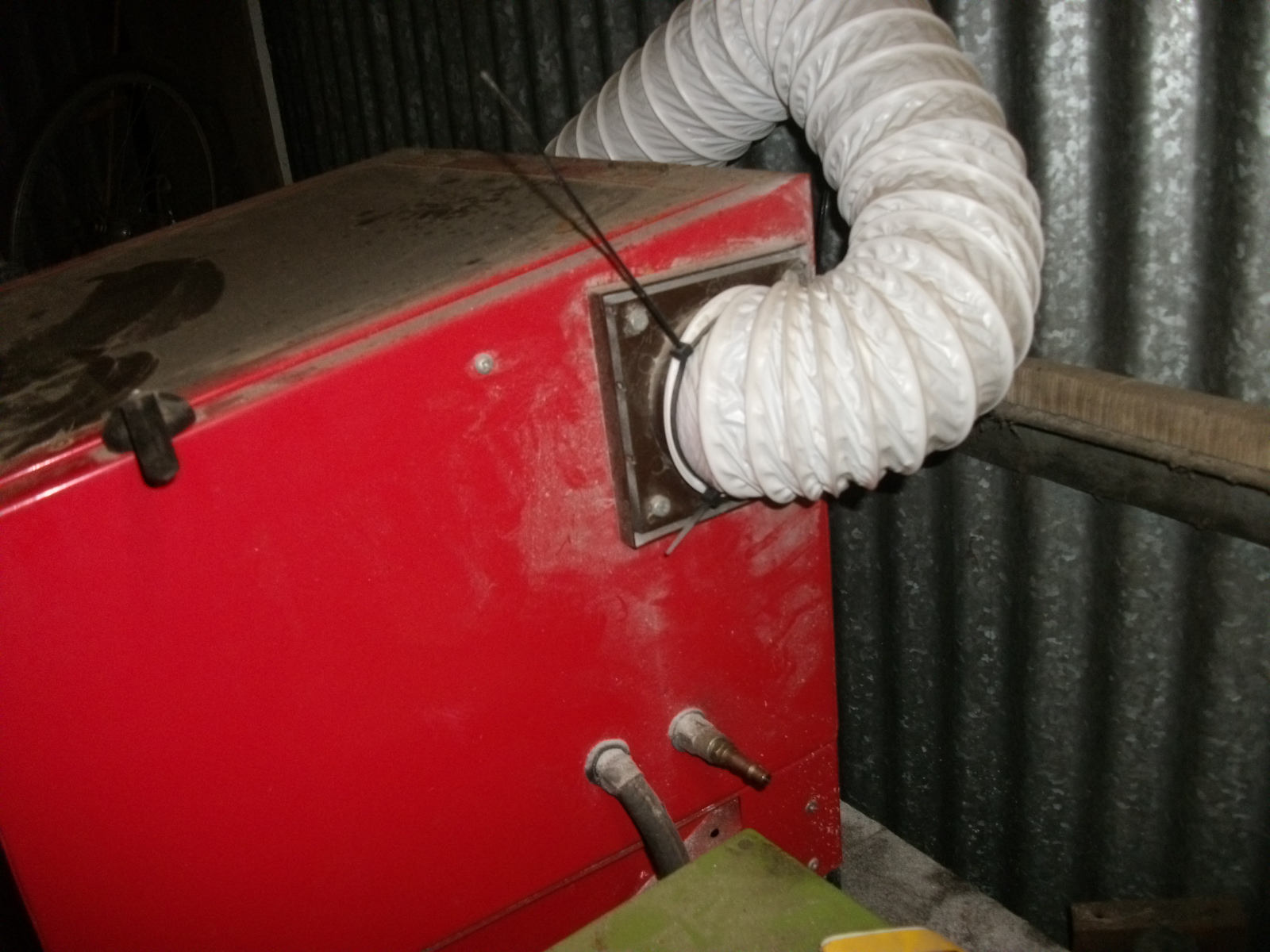

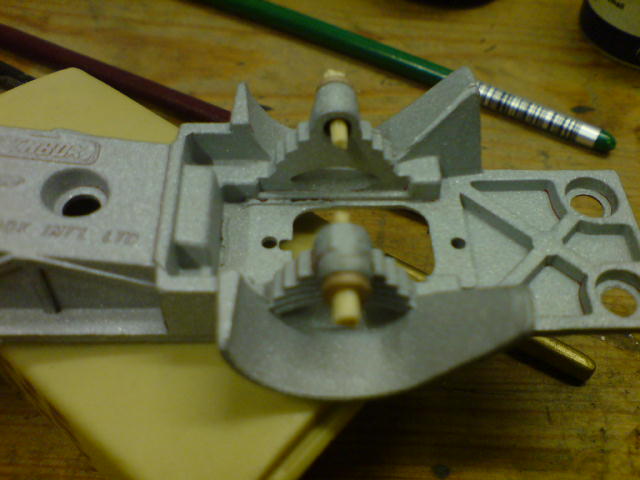

Throw the filter away, use that hole for a vacuum cleaner and cut another hole in the opposite corner with a filter externally so you get a flow of air across the cabinet. Does it have mesh in the bottom?

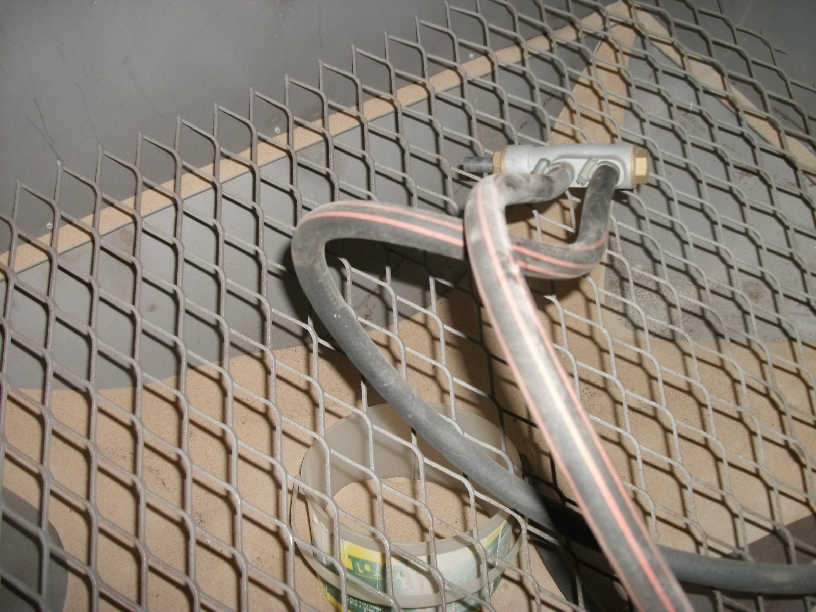

Yes it has a mesh in the bottom.

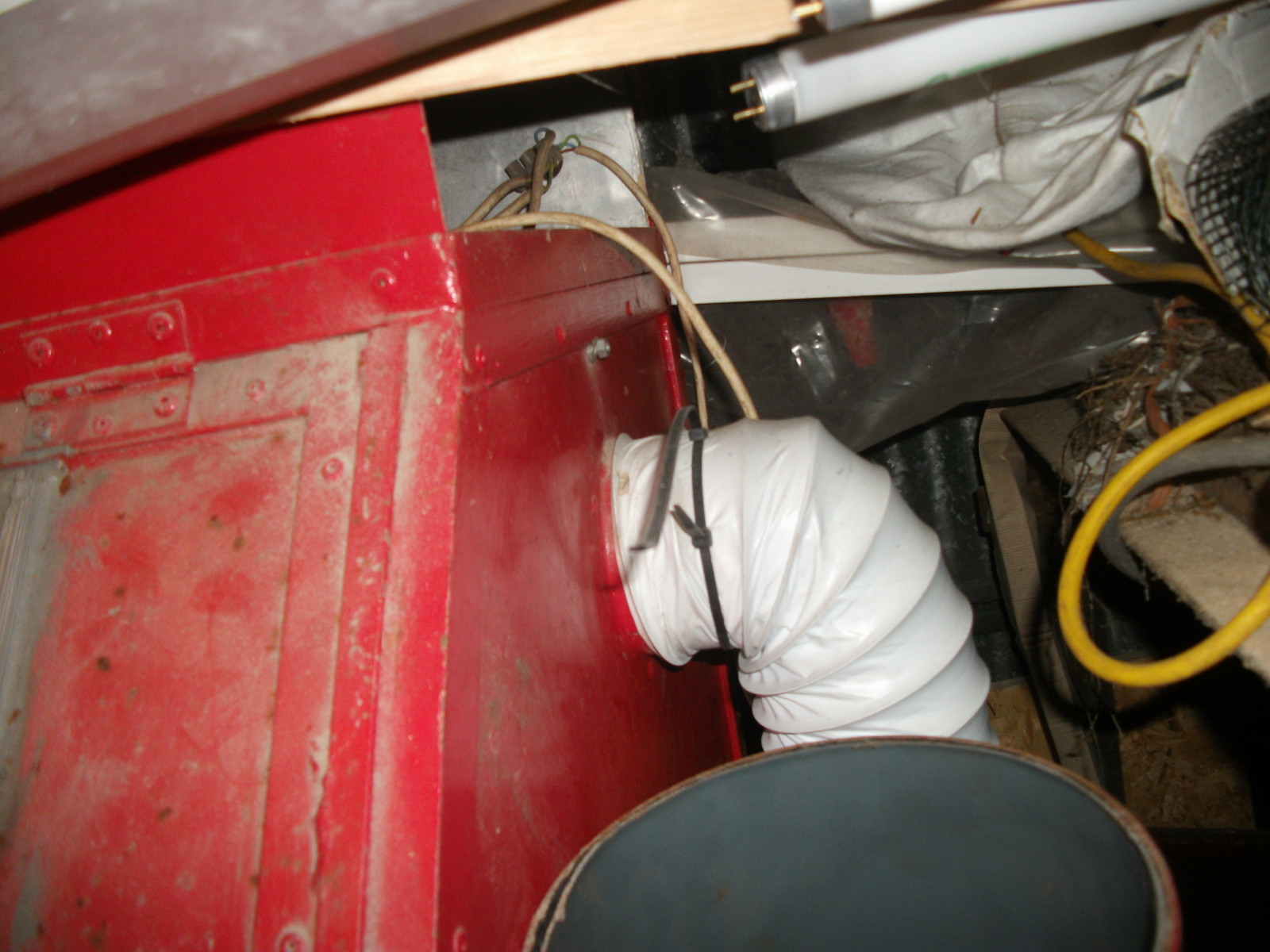

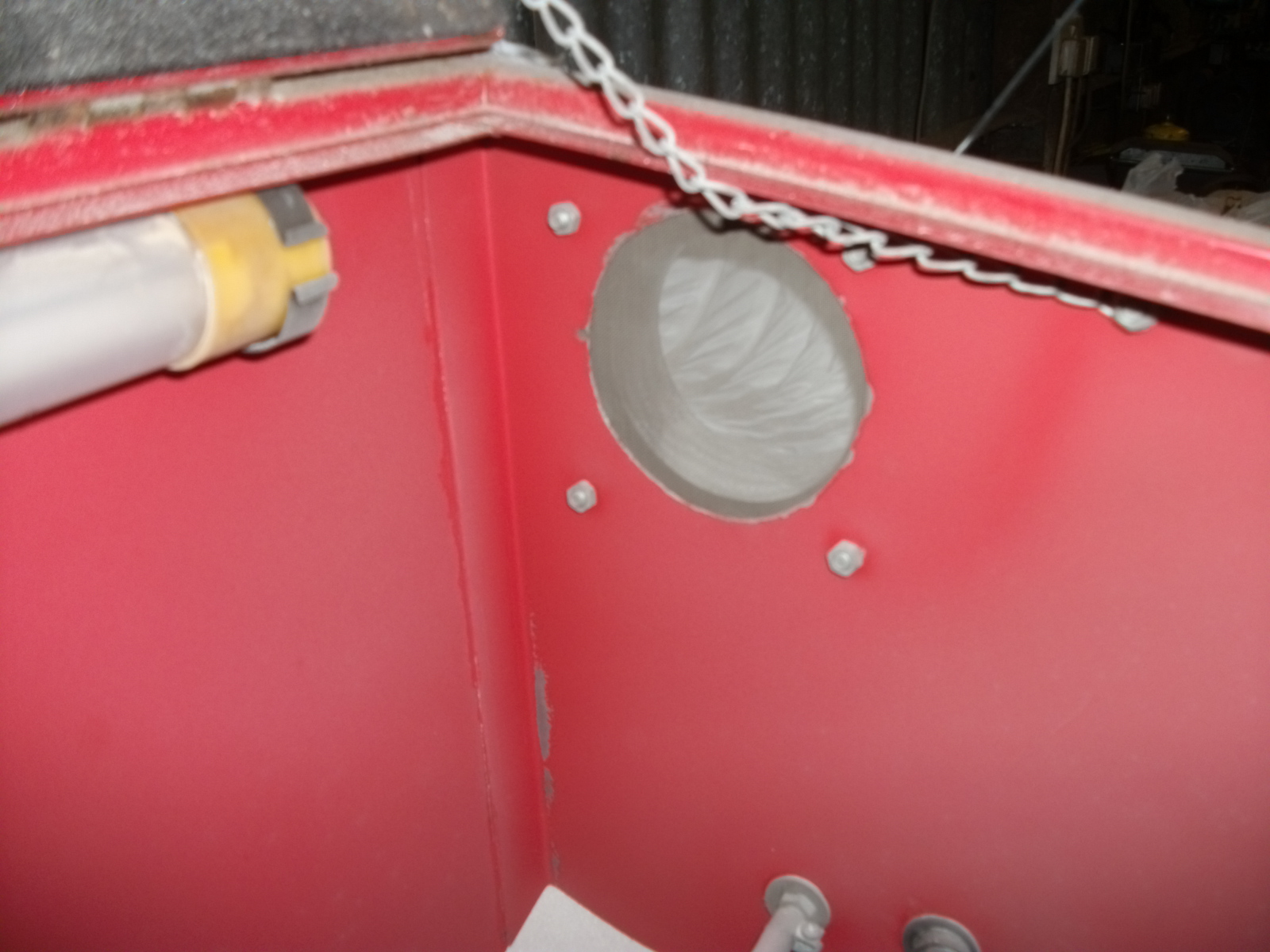

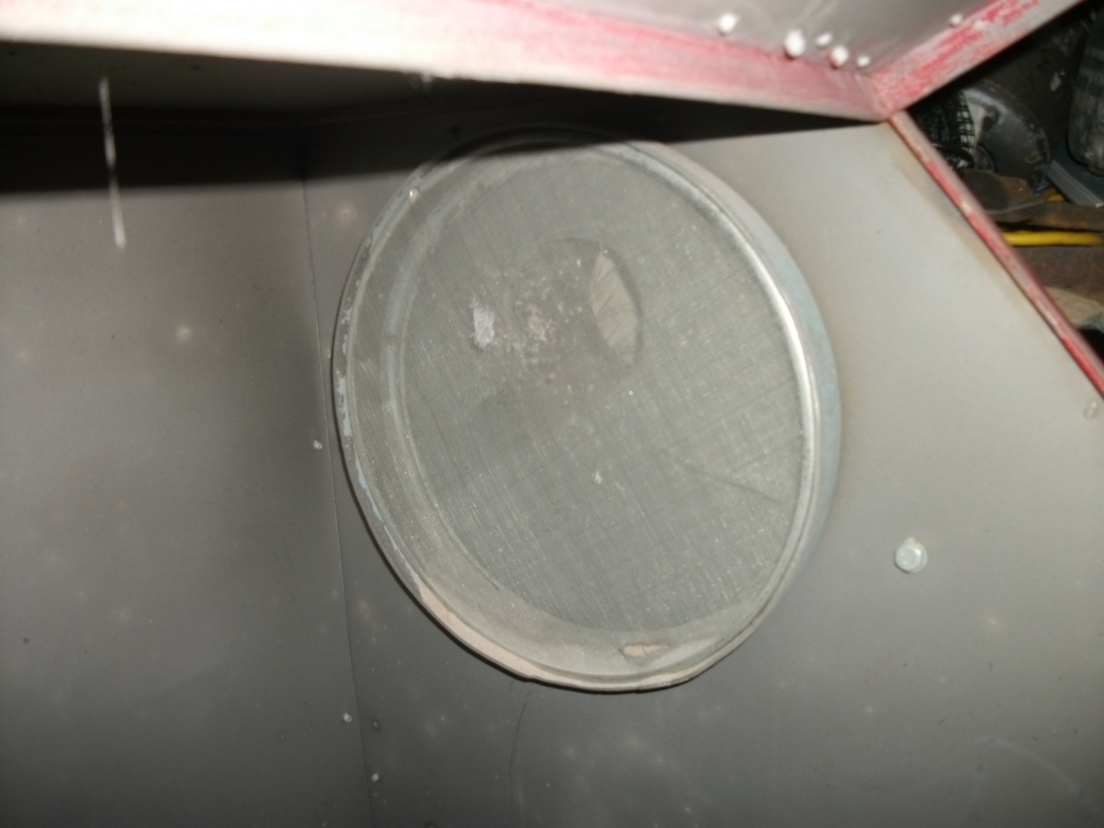

Any pics to see what you mean?without a mesh those cabinets are a bit small and it will pull all the media outI put a 4inch hole in mine and ran a flexible duct over the unit and put a cheapo 4inch fan on the end outside . it works real well takes the dust out but not the beads or media
