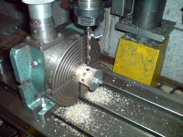

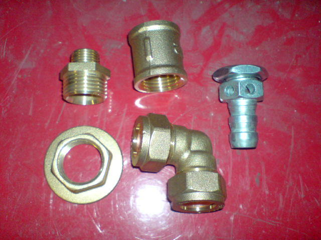

so I got some plumbing fittings and here they are with the original pick up for the grit(the silver coloured item)

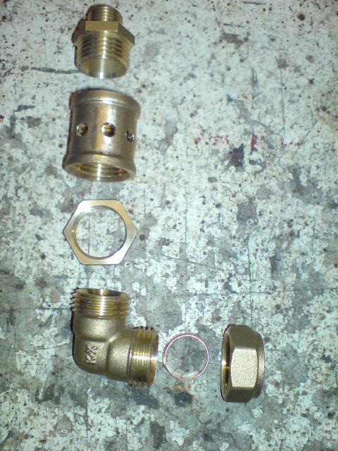

machining the holes in the connector (just because you like pictures of things being made), it was just done on a rotary table as it was the easiest way to hold it,and was just centred by eye.
and the finished parts ready to be assembled.
there is a 15mm to 10mm compression reducer (the tube to the gun is a good fit over the 3/8 bsp thread. this is screwed into the connector with the holes in it, then under the cabinet is a 15mm compression elbow screwed into the connector with a very thin nut to hold it in place.

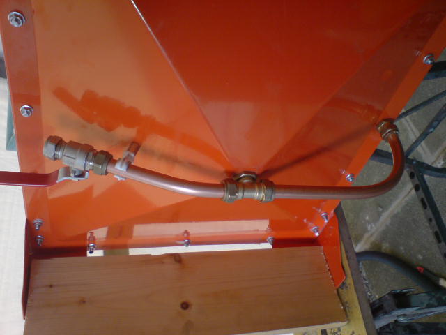

and from underneath with a copper tube to the front of the cabinet and lever valve to allow the air in.
When Brightspark increase the height of his cabinet, he welded on extensions to the legs, I would have done that, but the shelf my cabinet will stay on is too narrow and the front legs would be over the edge so a peice of wood solves both problems.

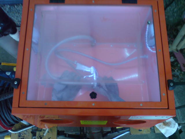

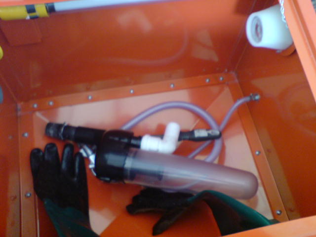

when not in use, I'll need to empty the grit out so I can move, but the tube in the middle gets in the way.
so the plumbing elbow was replaced by a T fitting and the grit hose was moved to the back of the cabinet (using a new connector with the 15mm to 10mm reducer.
not sure how long the brass and copper fittings with last with the abrasive grit, but only time will tell
and from inside the cabinet, it seems like it will be more useable with the grit hose at the back rather than in the middle.

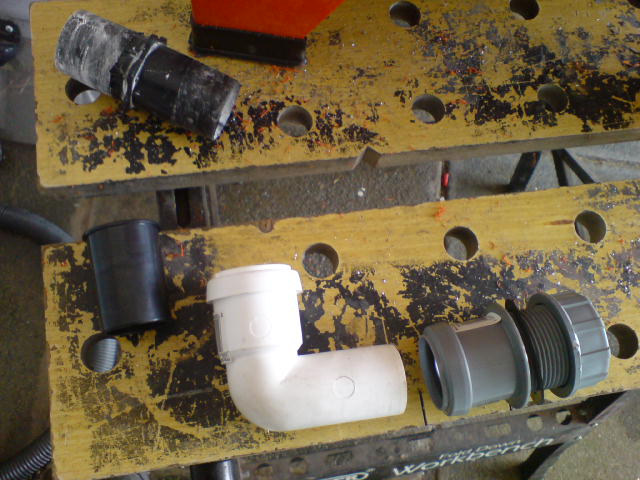

I got a cyclonic power filter for a vacuum cleaner
http://www.ebay.co.uk/itm/381438491108
no idea if it will work or not, but if it does its a neat answer to the dust problem.
so together with an earlex power tool adaptor, an adaptor that came with the filter, a 32mm 90 degree bend and a 32mm tank connector
once you make a hole in the side of the blaster, its all goes together very easily
and is easy to keep in the blaster too for storage

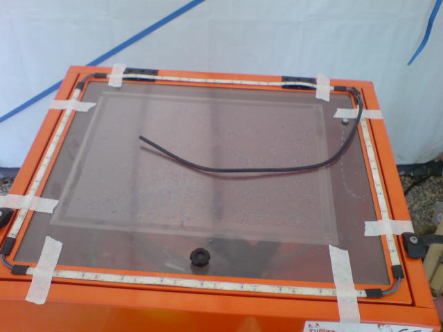

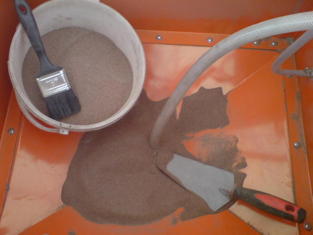

now all I need to do is sort the lighting out, I'm going for 12V led strips using 5630 LED's, then I'll be ready to go.
