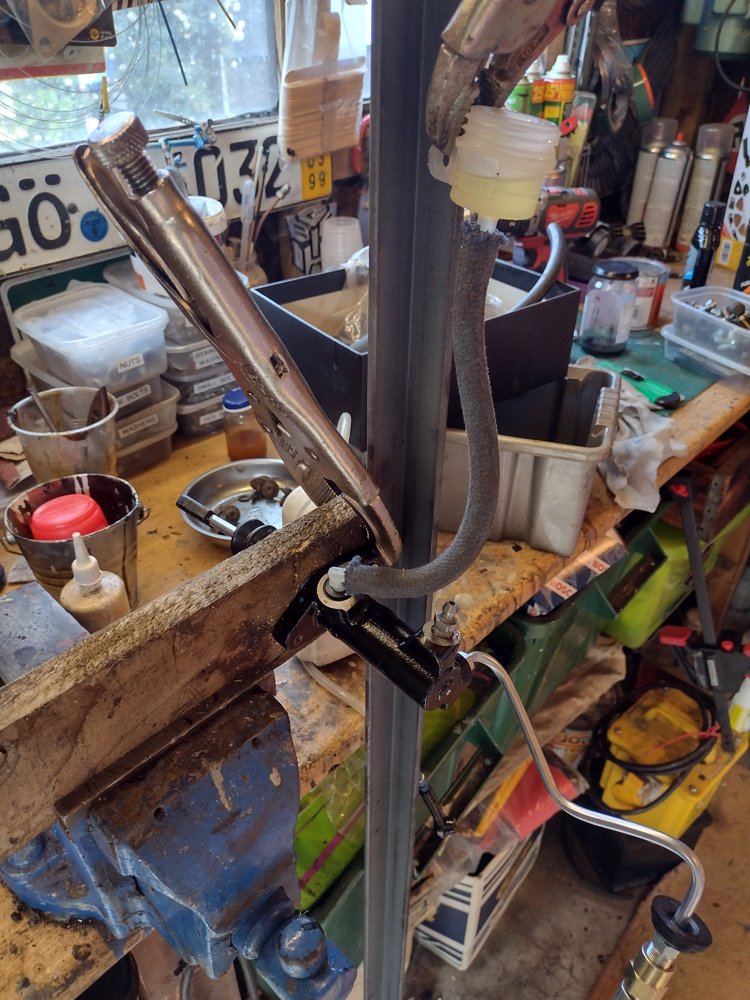

how would air draw in where theres 20psi pushing the other way? not arguing just asking

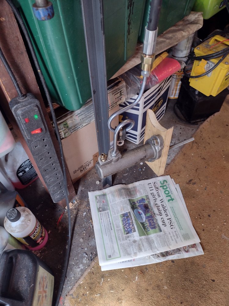

it would have been nice to get one decent glug out of it , fingers crossed .slave is clamped...see piece of wood
with the metal pipes i cant get it higher...i have bled it with as high as i could get it

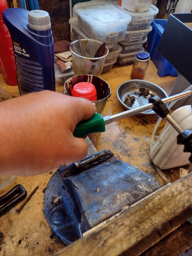

ive hand pumped and bled into a bottle both parts and gravity bled both , got a tiny bubble out with gravity

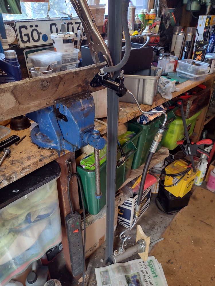

not with that oem style hose , ive got a flexi may try next timeCan you rig it so the slave is higher than the master?
What about slightly loosening the union at the master, so you can rotate the whole affair up?not with that oem style hose , ive got a flexi may try next time
then what when i need to refit to the car? loosen it and let air in?What about slightly loosening the union at the master, so you can rotate the whole affair up?
If the reservoir’s full, and it’s only just loose, you might get away with it. I’d try anything at this point.then what when i need to refit to the car? loosen it and let air in?
why not just use the slave that was bled ,,,,, fit the assembly complete to the car , I thought that was the plan ,fitted the master onto the pedal....more squidgy than by hand as expected

no gravity will leak fluid out , or put a wee bit of pressure on the master , when fluids leaking out air is not leaking in.then what when i need to refit to the car? loosen it and let air in?
