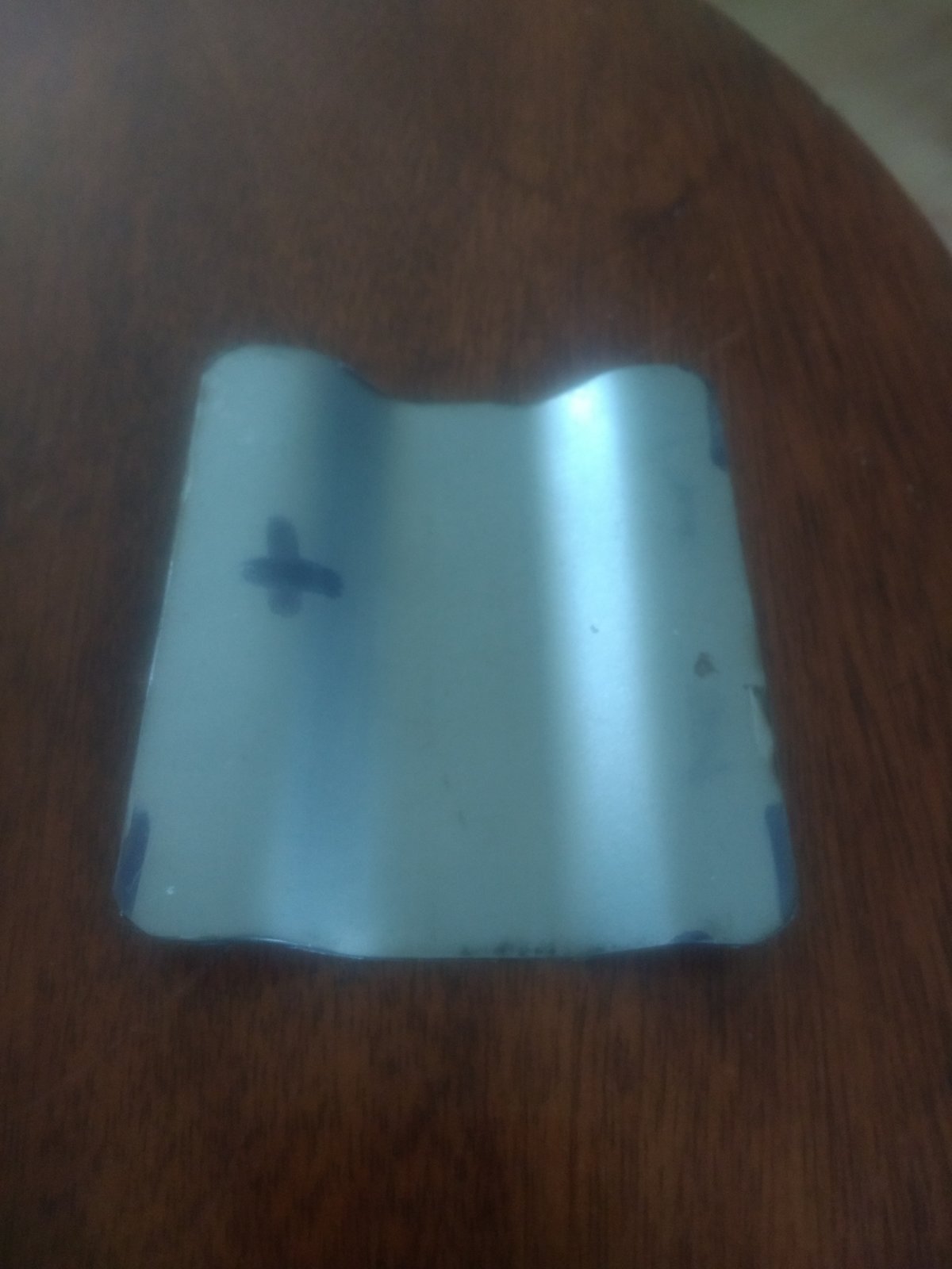

Do you mean two shaped pieces and clamp metal in between mate, to press it into shape?
Probably just the underside and dress the sheet over it into the grooves.
Theres loads of those vans in scrapyards, have you thought about cutting a patch from another floor?
Also, you could make your patch in two half's, split along bottom of trough, and weld together.
This is my best attempt so far. The left side marked + is very slightly higher

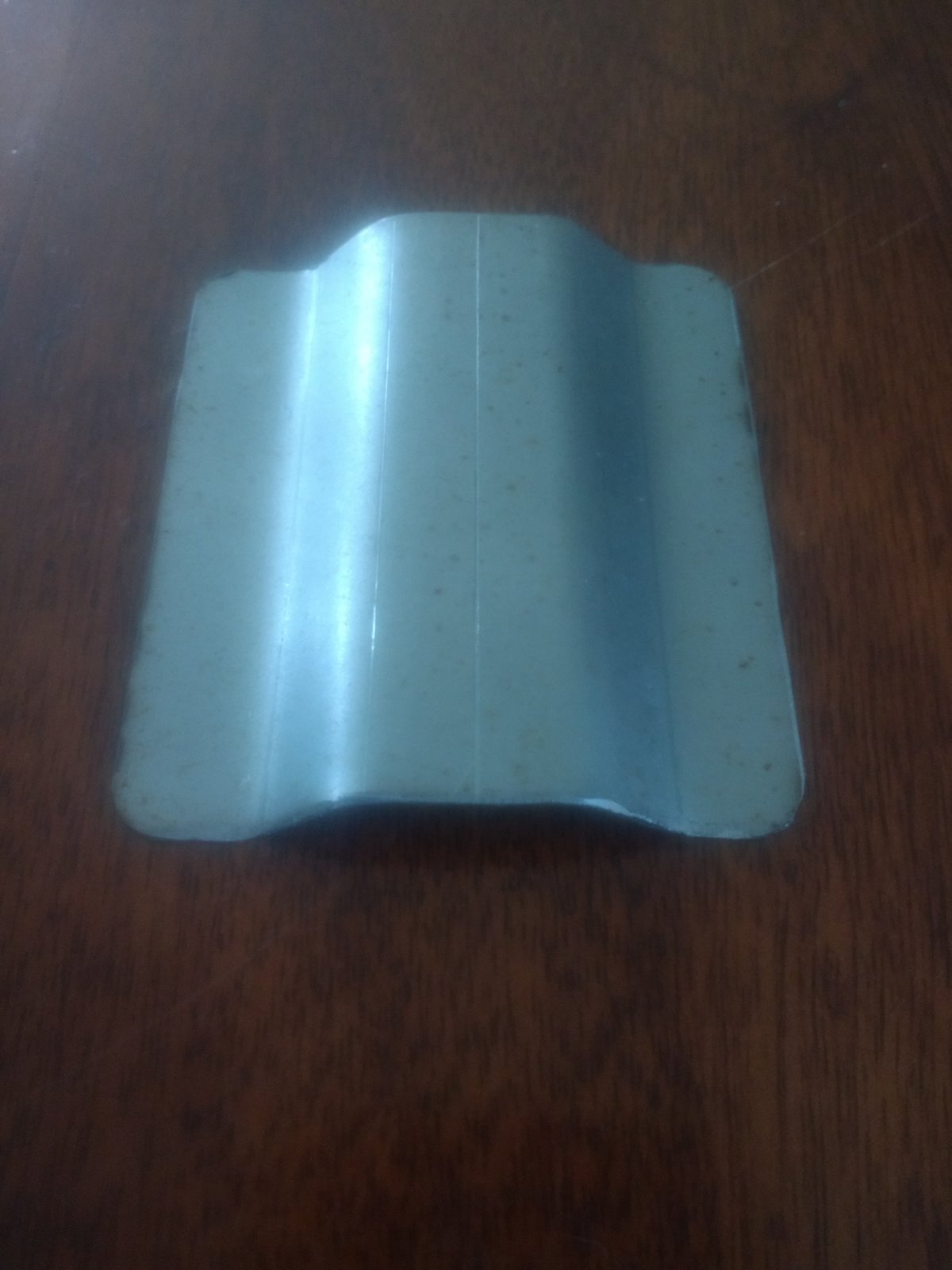

That said local scrappy open til 4, off there now. If reasonable cost going to buy a piece there. Great advice Ton up cheers
I dont think i got the skills or finesse for second tip mate.
But the first method has possibilities for a galute like me haha. Got a piece from scrappy now tho, but half tempted to have another bash as you advised. Cheers
Have a go, it’s how I’ve learned to do most stuff
Just a hammer and bolster on top of a vice.Wow thats awesome, think I'm way off that yet tho mate
How did you form the L shaped raised section above the 20mm hole?
