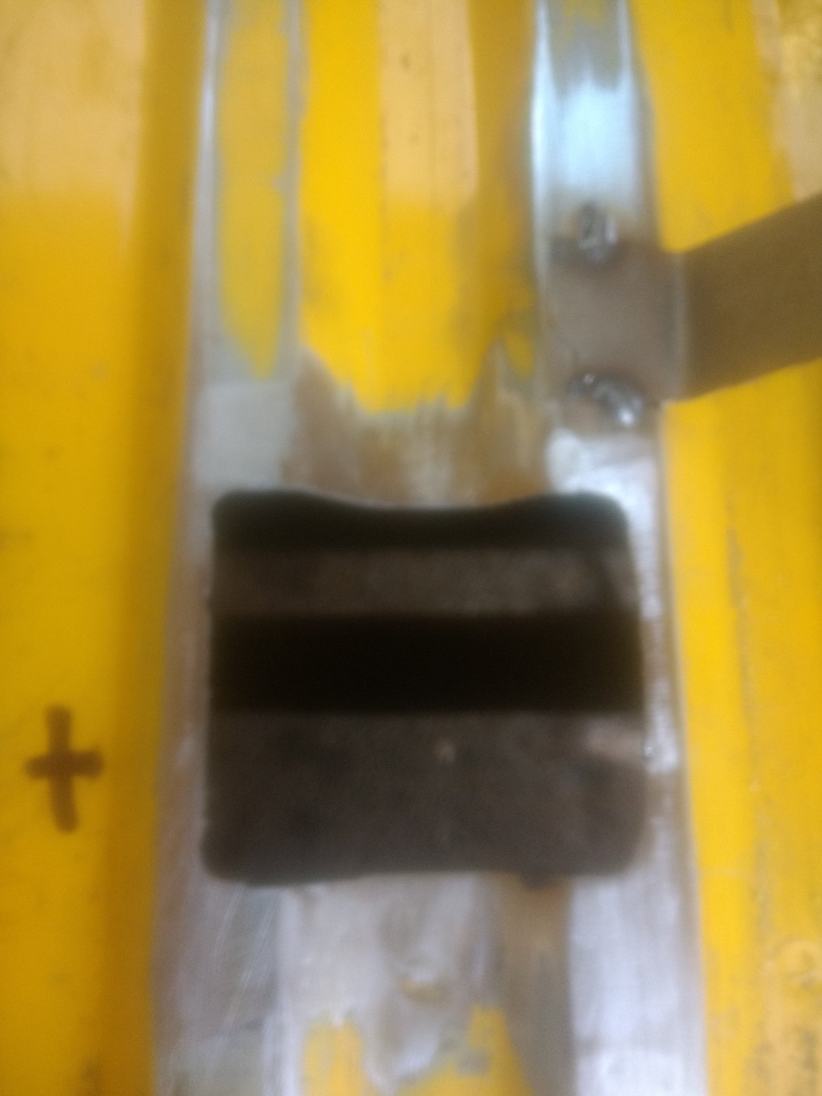

    Well the patch is in, and am happy with it for my first attempt. Others may think otherwise lol, photos to follow
    Slight delay re pics as my phone acting up. Goes flat at 73%. Ordered replacement, that had issues too.
    The replacements replacement will be here tmw hopefully.
    Constructive criticism welcome when i do post pics. Hitting whiskey now to help me cope lol
    Seriously tho, i know alot of experienced and well meaning people on here, any comments welcome :thumbup:
    Oh and i used the piece i made even tho got a piece from scrappy, call it stubbornness :fighting:

    Hope photos load okay.... IMG_20191110_133008651.jpg IMG_20191110_181332290.jpg

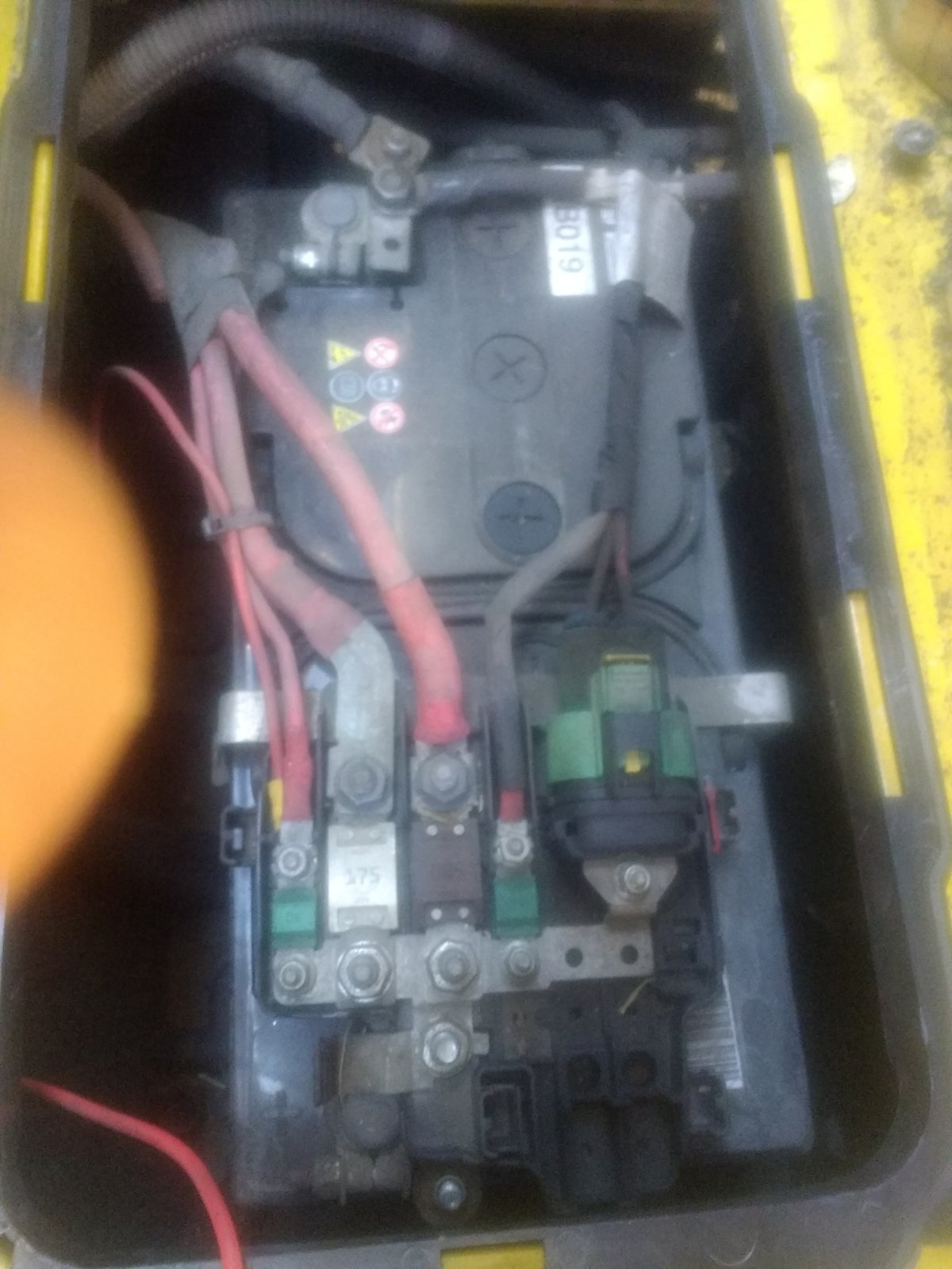

    BTW, this is why I'm reluctant to fart around disconnecting the battery. So welding done with it connected. Did use GYS surge protector.
    If its snake oil i lost £20 and your safe welding with battery connected anyway.
    If its not and actually works when needed its £20 well spent. So overall happy enough.

    Looking good....if you make it over sized then tack in the curved parts to the existing floor you should be able to tweak it when it's half welded in.....then just trim the excess metal off with a slit disc and butt weld the rest in. The 1mm slit discs are ideal I find....I did most of my floor repairs by tacking in part of the repair and working the metal once it was on the car....all that matters is what it looks like when you are done.
    Once the trough is tacked to the original floor it'll have a lot more rigidity.

    No criticisms but surely to disconnect battery it would just mean undoing and lifting negative lead off , 1 bolt ?
    stuvy and Exuptoy like this.

    My floor was all odd shaped with a flange along the edge...I did it out of necessity and then I realised it's alot easier than trying to create a perfect repair piece!
    I sometimes just oversize the patch...slit a couple of inches...do a little tapping...couple of tacks and just work my way along. Works better on thinner steel which is easier to move around....takes a little practice but I found it works well with difficult shapes.

    Agreed. But how many sensitive circuit's will be affected, set back to factory setyings etc. Van past 176,000 miles. IMO not worth the risk if when you reconnect ECU wont accept readings from countless sensors.
    No critisim taken BTW mate, til i bought this van most complicated batrery set up I'd seen was on my 2002 Focus. But multiple posts on here from trade guys swayed my opinion. And after taking the plunge they was right. I'm very grateful for advice given and available on here.

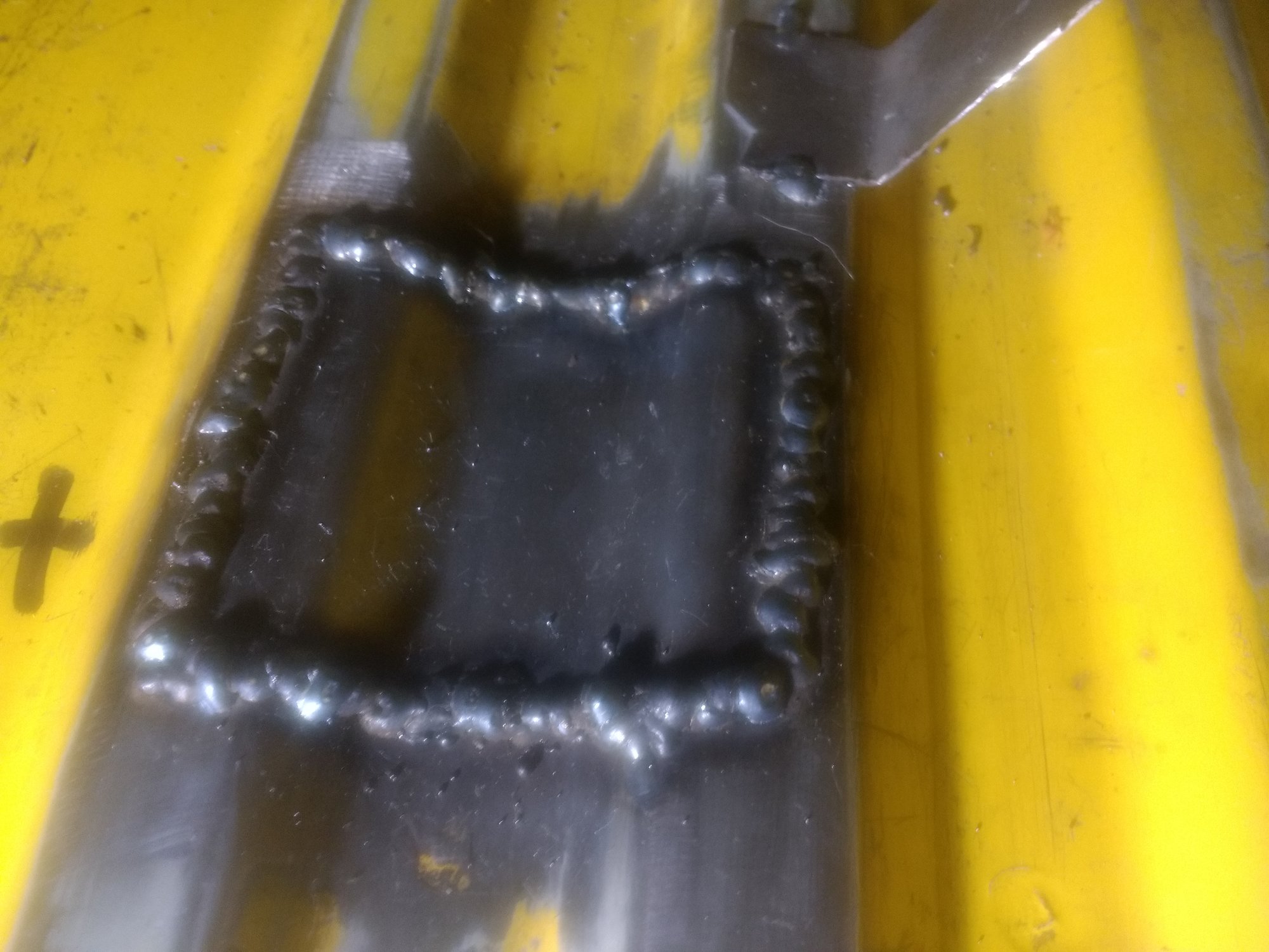

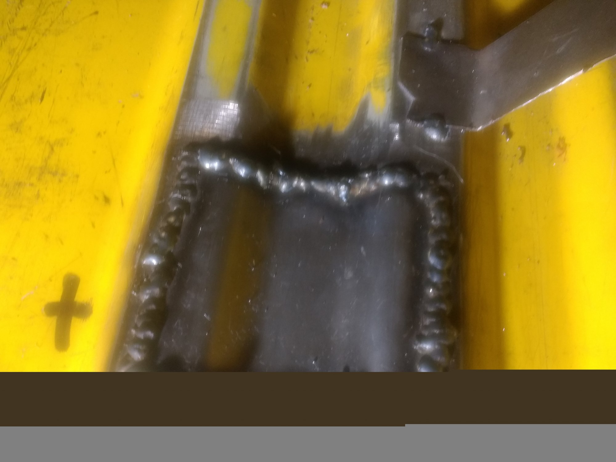

  19. I was gonna mention just removing the earth but if it’s survived intact then all’s good.
    On the subject of your welding I’m sure others more capable than me will critique it, but it looks ok and maybe with a little more heat and slightly less wire speed it would be a little flatter but nothing a flap disc can’t hide. Well done for a first attempt.

    Thanks mate, I'm kind of anticipating some grinder time :(
    Worst part of job was removing underseal. Re heat i went to lowest setting out of nervousness i guess. But your right, bit more heat, bit less wire would be good
    ( Dont tell anyone, but i prefer stick welding really )
