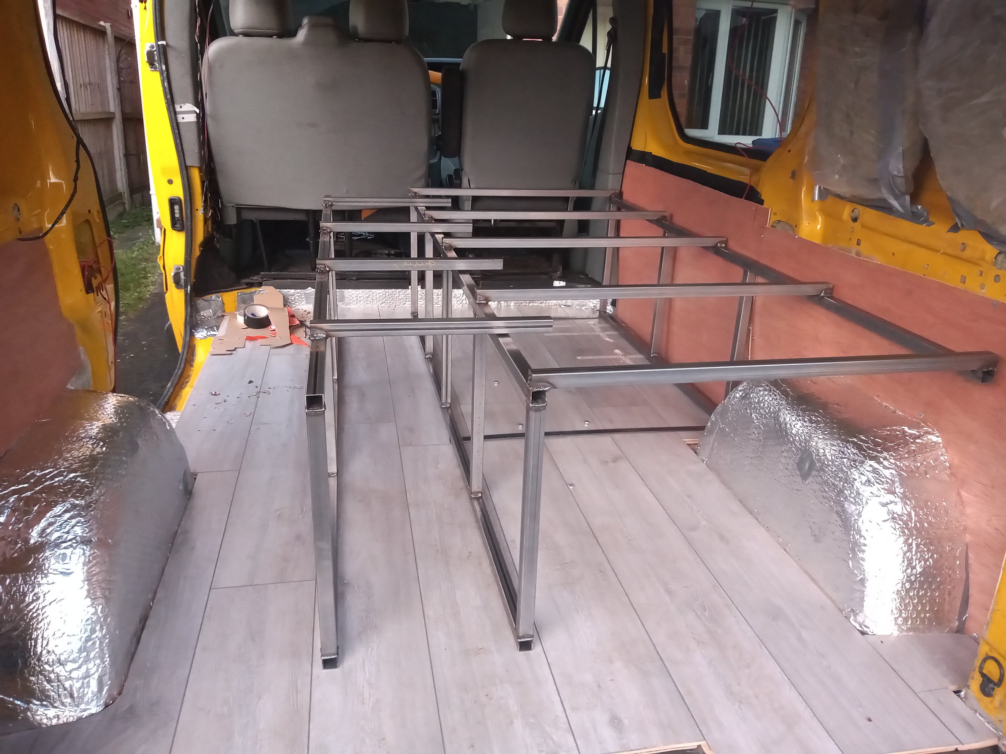

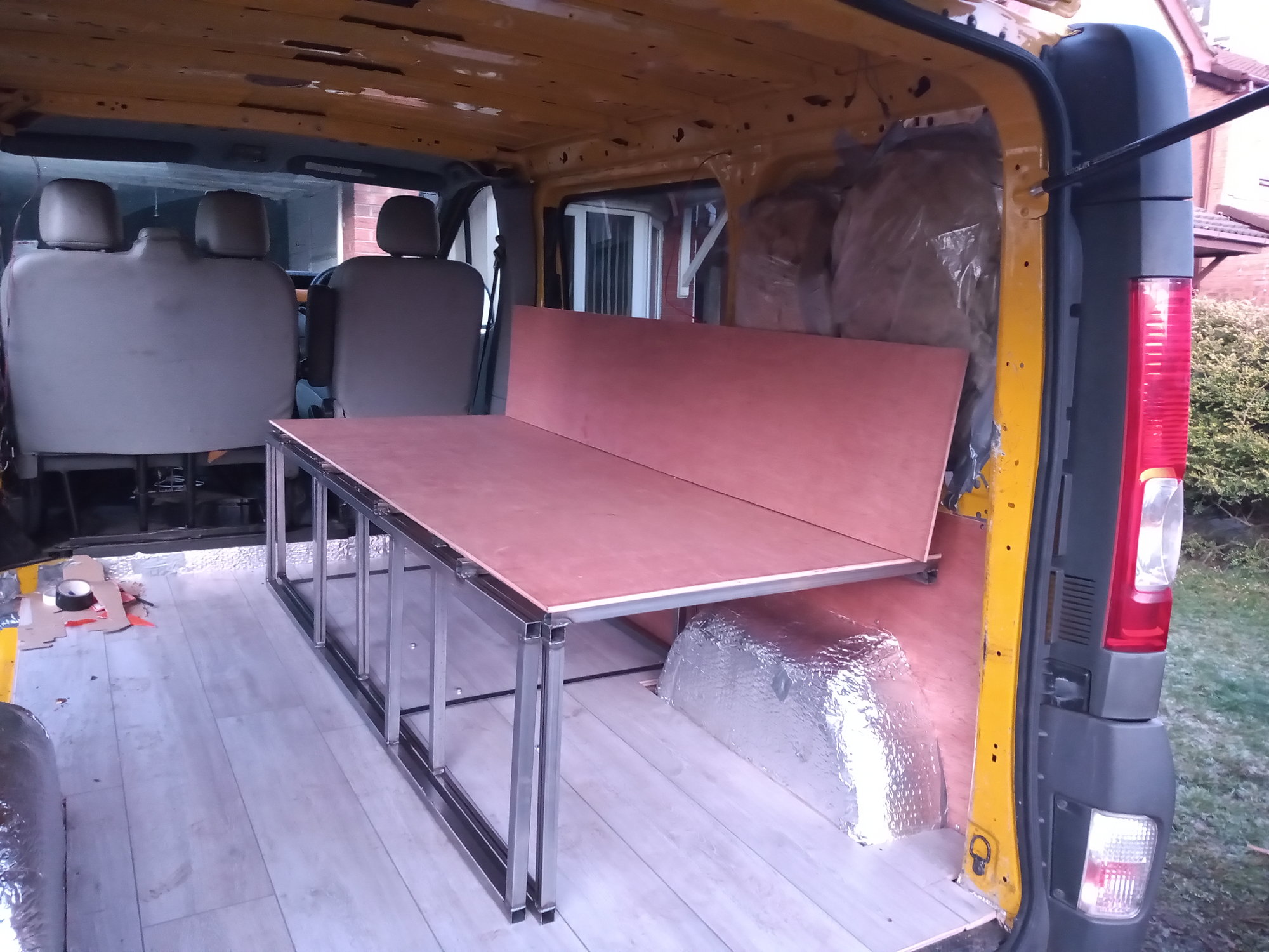

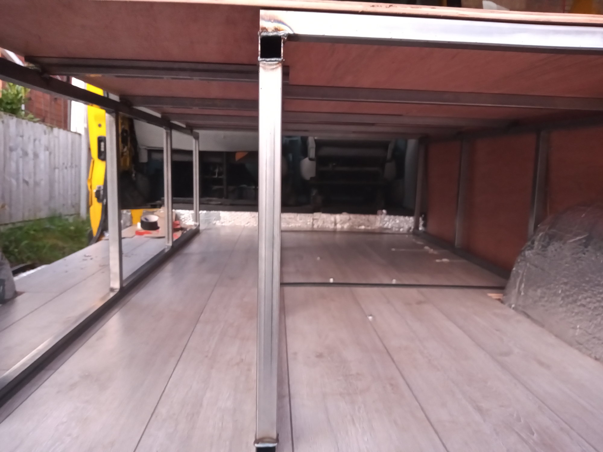

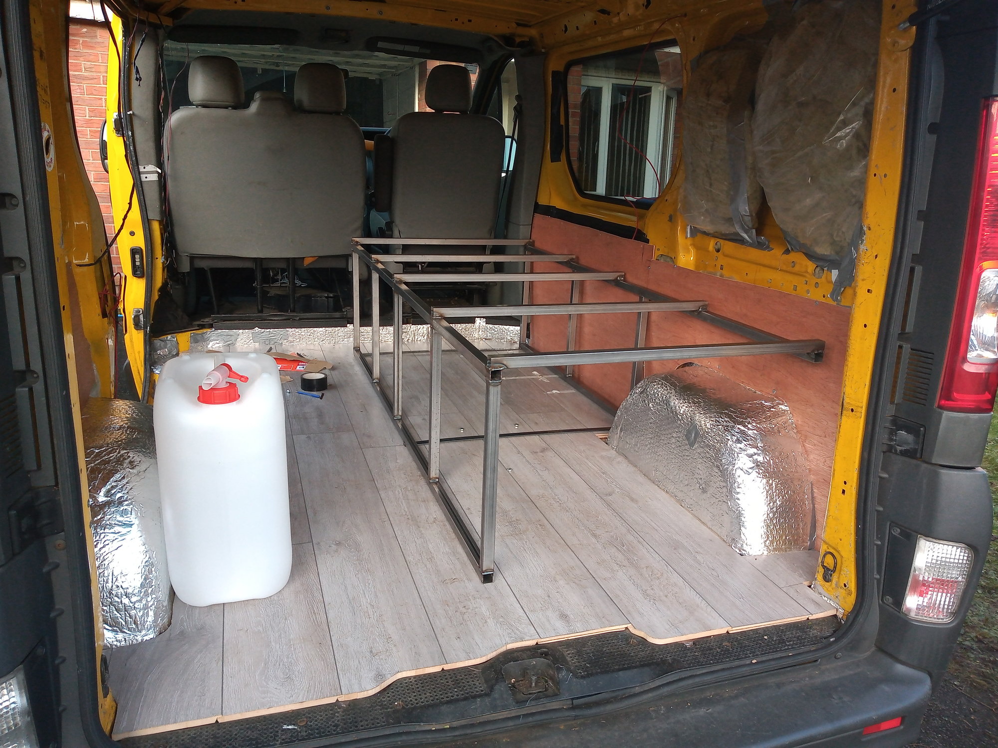

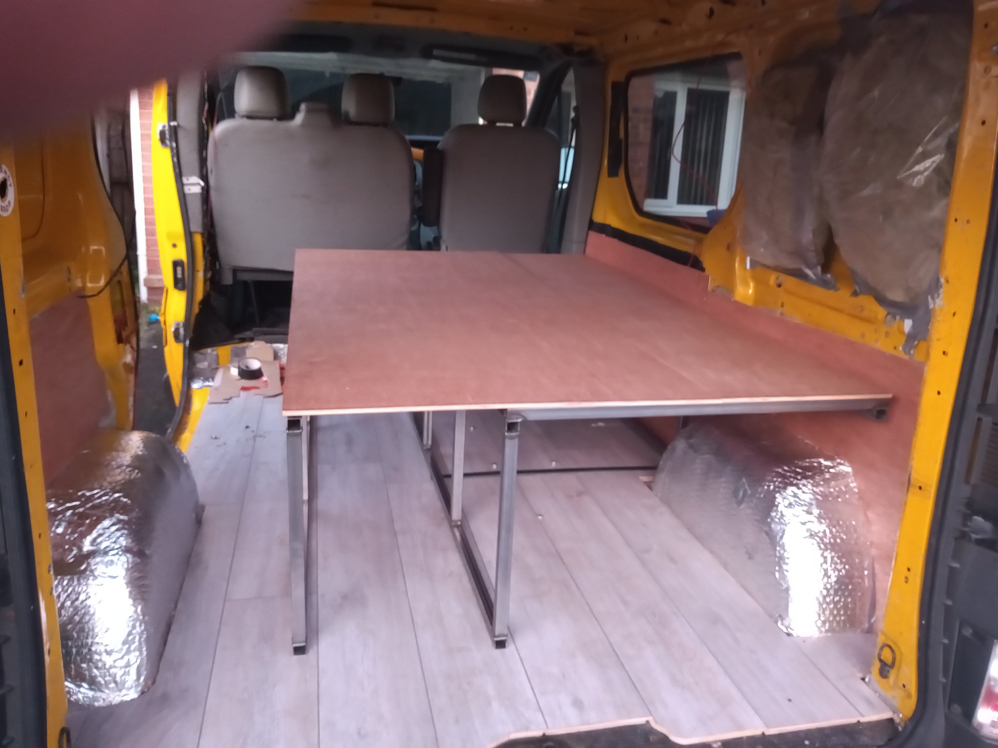

    Spent most of the day welding bed/couch behemoth up.
    Smart meter says used 47p :thumbup:
    Not gonna waffle, too tired. Hats off to guys who do this full time. Its not so much the welding, more the constant repositioning of big metal objects :doh:
    Heres some photos

    Its not finished yet. Its going to get another leg near the wheel arch snd more straps for fixing to the floor. Ran out of steam, and think i may need a bit more metal too.
    Will post finished article obviously.

    Could of made it lower had it not been for wanting space for chemical toilet underneath.
    Not much headroom used as a couch as I'm 6ft, but honestly I'm happy enough.
    In couch form its a decent single bed and plenty of space underneath for whatever you need.
