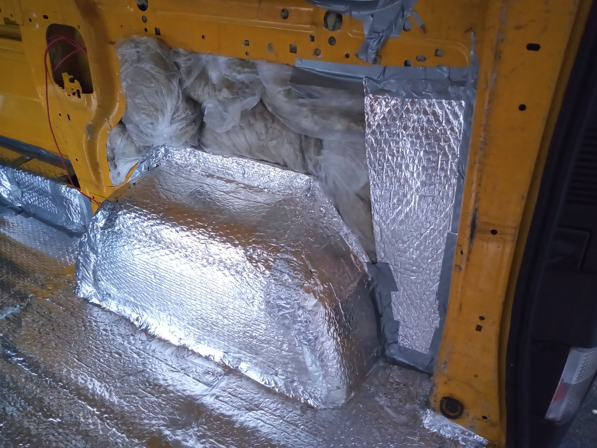

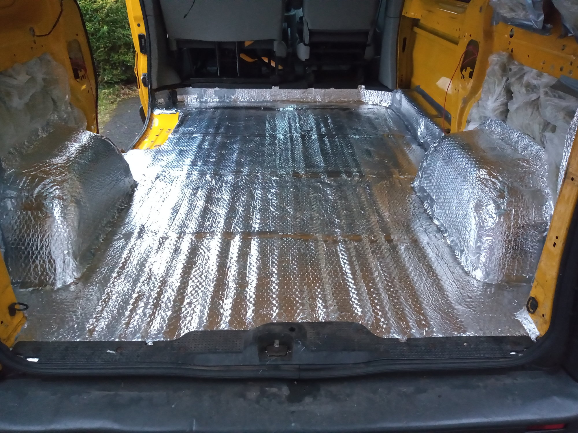

    Sussed out where leisure battery going to.live. and did a bit of planning re bed height. Want loo to fit underneath.
    My daughter and her boyfriend did floor insulation Inc wheel arches. I'm hoping to get laminate started tmw
    Put a decent size cable across floor before this went down, as advised above. Ta :thumbup:

    Oh, and hopefully fixed a small leak where old AA orange lights removed from roof. Plug placed there had failed

    great job...you would be amazed at how much noise you can reduce by filling the top of arches with glass wool before you box them in:thumbup:

    Cheers roofman, they both worked hard putting it in.
    I bagged the insulation,dead hard job lol.

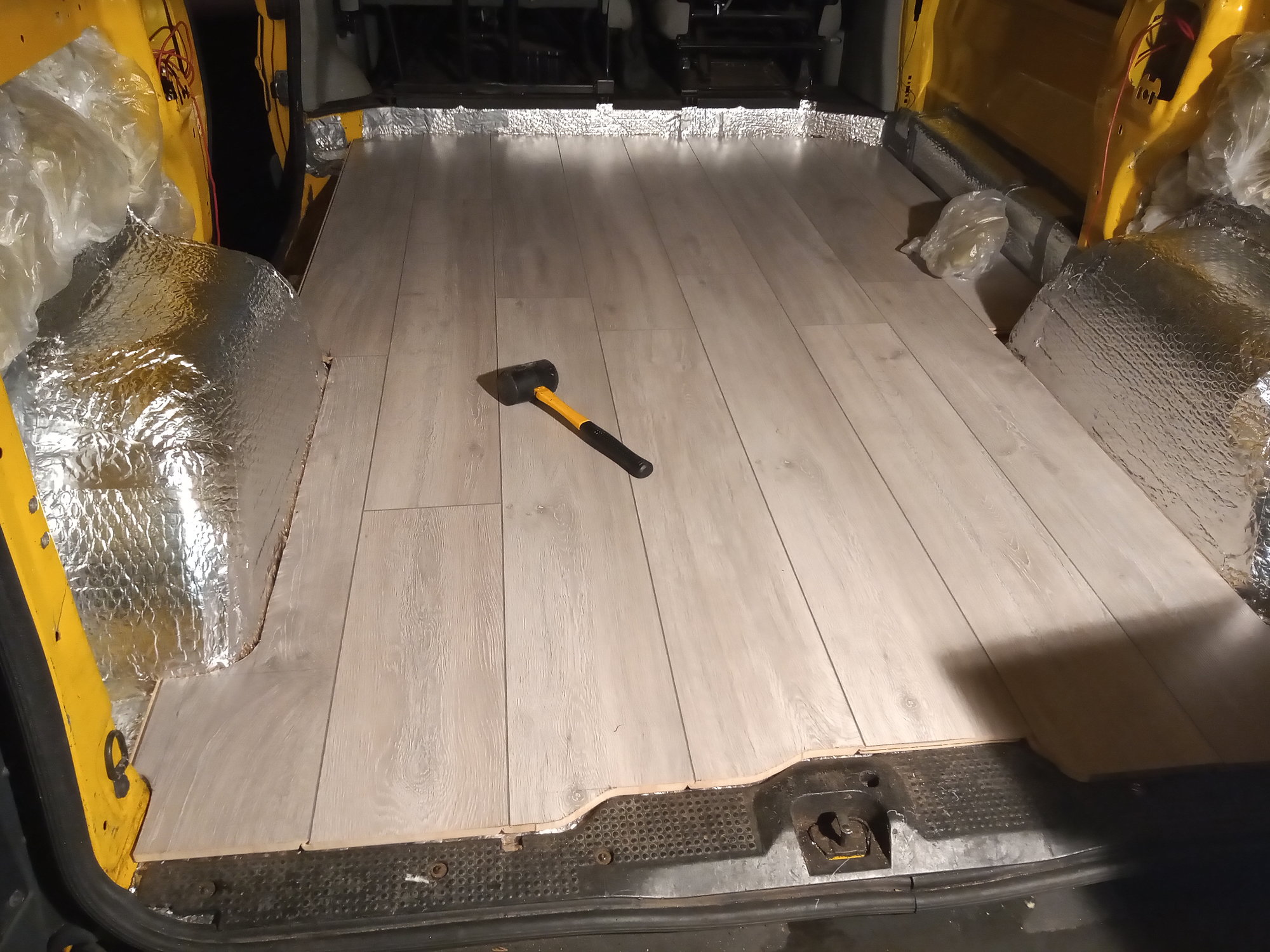

    Got the laminate all but done. Need to decide if cutting round the step recess and maybe gluing some rubber matting in there.
    Or refit the support that was previously under the ply for the racking. Then put a bit more laminate over that.
    Only downside to that is thy higher step into the van. Could affect the dog as he's getting old now. Or me as i exit the van half cut :drunk:

    Keep the step. Keeps water off the floor when it's wet out. Side doors are usually a bit leaky toom

    Ta mate, never owned a van before so experienced advice much appreciated

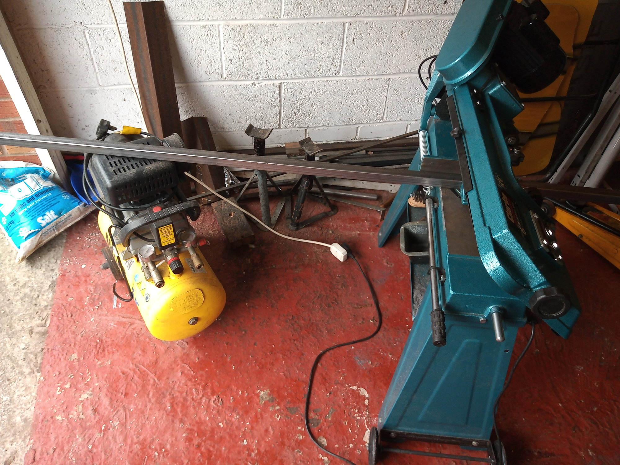

    Sometimes you do have a bit of luck
    Top of compressor exact height for supporting long pieces of steel in the bandsaw IMG_20191127_112958392.jpg

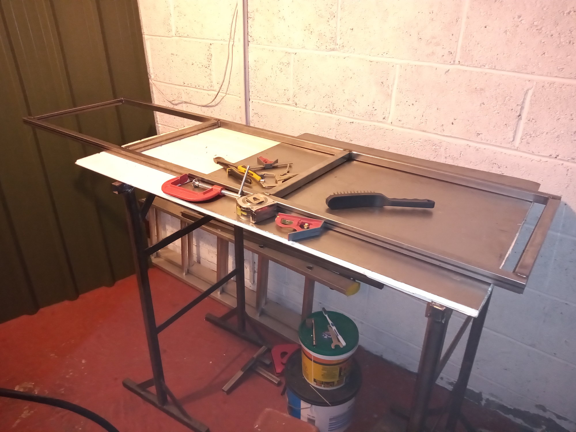

    Had a good day tho, got everything cut for the couch/bed thats going in the van. Got some welding done too. Frame below will be part of the section that pulls out to convert from couch to bed.
    Its made of ERW steel, 25mmx25mmx1.5mm. Was a bit nervous at first cos of thin wall but only time it holed was practicing on offcut. Actually really nice stuff to weld with.
    jimbo84 likes this.
  14. SteScouse
    SteScouse Forum Supporter
    Messages:
    560
    Location:
    Liverpool
    Tacked every single joint with 2 tacks on both sides first. Worked well, stayed square and flat too.
    Know I'm a fan of arc welding, but never had end product staying this flat and square with that. This my best "frame" yet. As its 6ft 2inches long am chuffed :laughing::laughing::laughing:

    What's the reasoning for laminate over vinyl?
  20. SteScouse
    Messages:
    560
    Location:
    Liverpool
    Like it i guess, plus cant feel ridges in van floor at all. Also nice flat surface for adding fixtures too.
