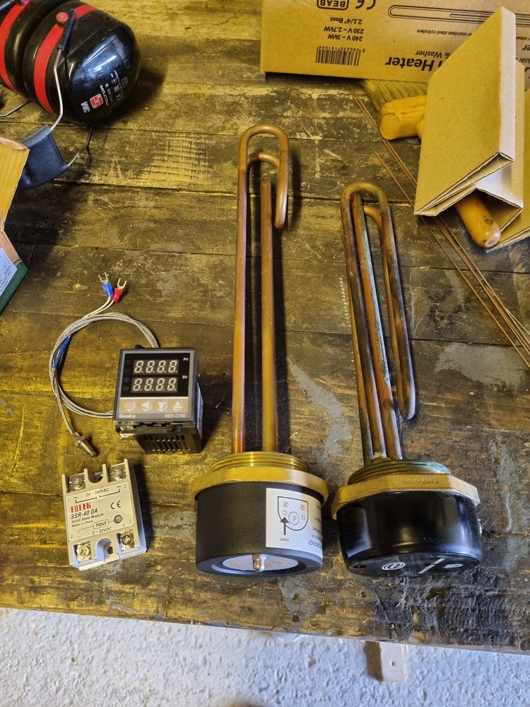

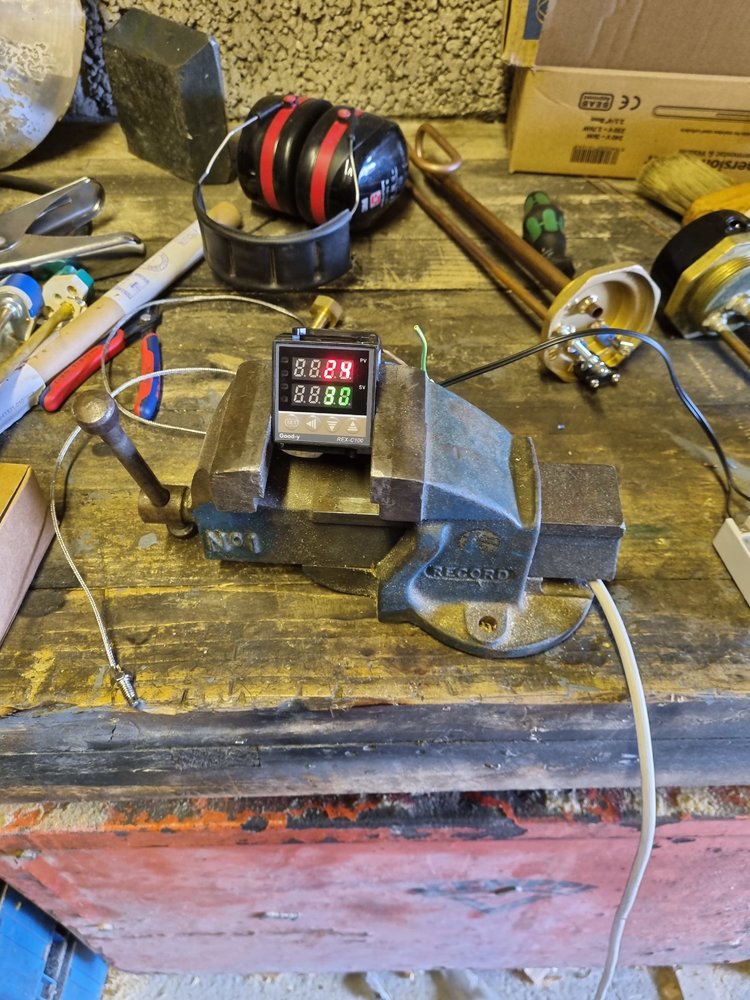

I noticed after buying it that you're not supposed to use a copper element in a stainless cylinder, I don't know if that means it'll break in five minutes or it'll just break prematurely if I'm using it day-in, day-out heating hot water in a house like it's designed for. I had been planning to put my temperature sensor in the thermowell the stat came out of but I think it'll probably read significantly higher than the actual average temperature in the vessel being so close to the element.
Having seen the manual these Chinese controllers come with, I'm temped to look for a second hand Eurotherm or similar, something with a bit more support, I don't have a clue how to set this one up.

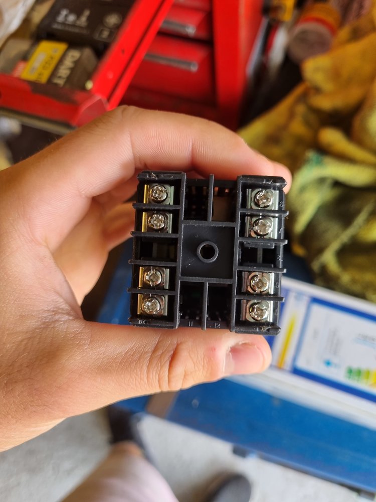

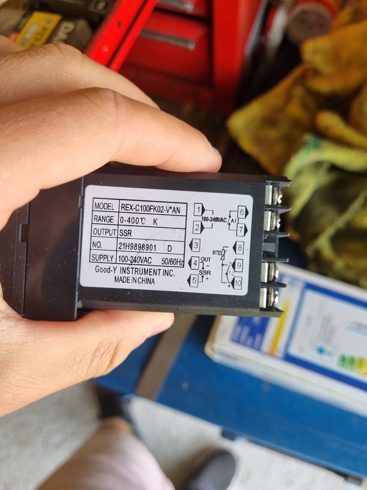

I'll go and look at mine after lunchCheers, I'll have a read through in a bit. Here's the problem with this controller, terminals 3 and 8 are missing, the listing shows all 10 though.
Do I need a PID for the kettle? I'd have thought not, it will maintain its own temperature at exactly boiling but nearly every brewing controller I've seen online they have one.

Just seen this video on a ready made system and at 10:40 they say the kettle PID controller is set for "percent power output" (So not PID at allEdit - I just remembered, I do have the PID controlling the elements via a SSR but set the target temp to 110c so it never kicks in. This is so I can use it on the hot liquor tank should that PID or SSR fail.
). I can't figure out if these C100 controllers have that mode but if not, it wouldn't be hard to do it with an Arduino, almost the exact same code and circuit the pumps are running on actually.

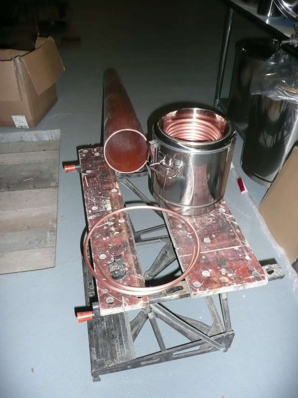

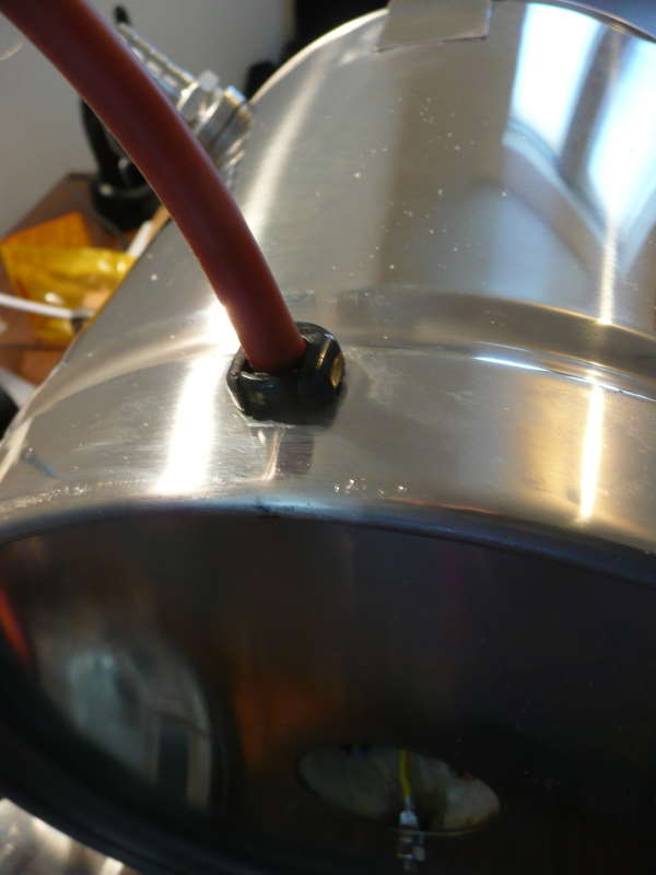

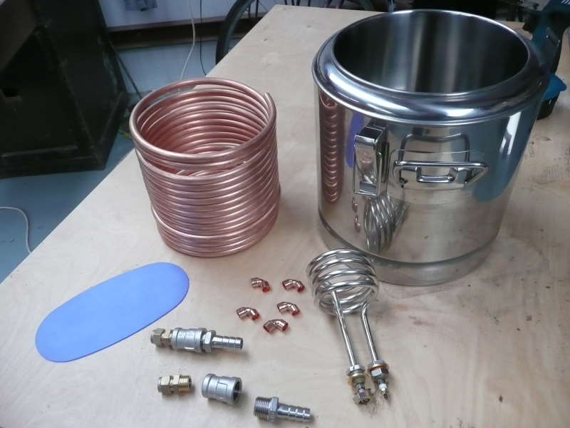

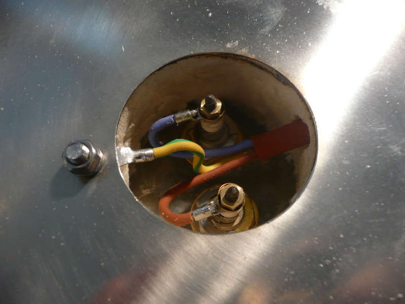

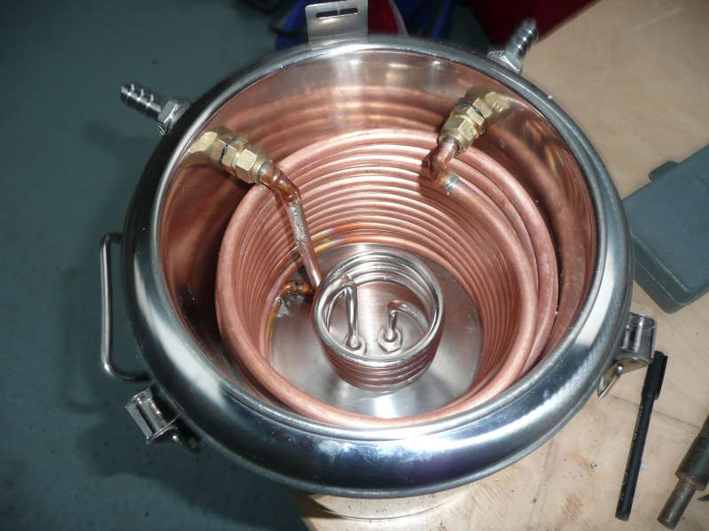

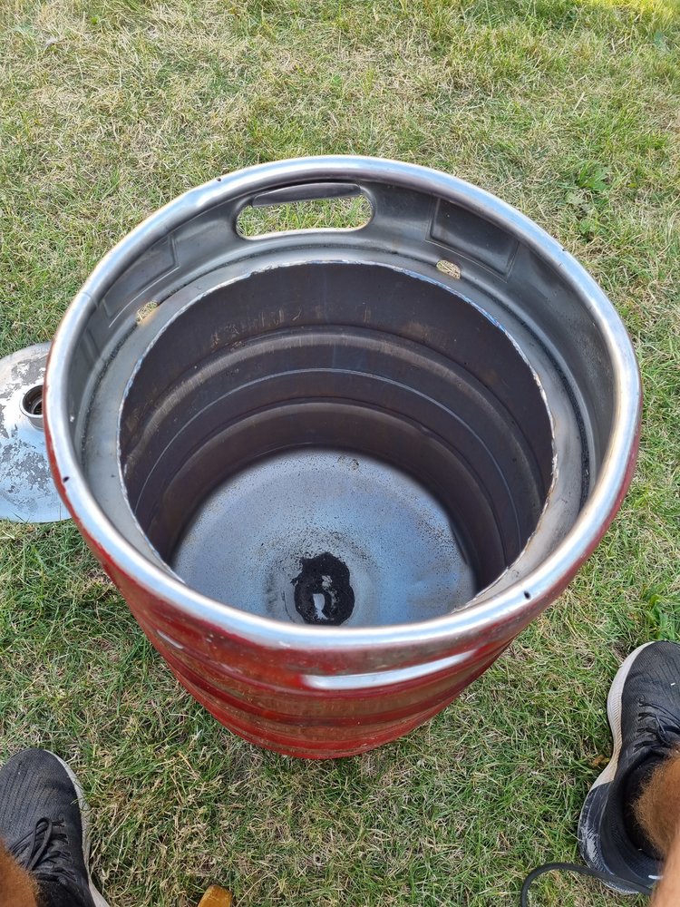

I just wrapped copper pipe around a length of waste pipe to form the coil and put it into a 6 litre SS insulated soup/stew container and stuck an element through the bottom of the pot. There's loads of big SS catering pots for not much on flea bay, but most come from Germany or France.The first keg I cut open by butchering a hole in the top and then cutting from the inside right up to the wall so there'd be no rim. That was impractical, a lot of work and doesn't allow me to use a lid, I reckon that ones gonna be my HLT. I've just cut the second keg a lot more carefully, nice neat circle so the piece I cut out can have three tabs welded onto it and it'll drop back on top as a handy lid.
The hole is just shy of 13", I wasn't aiming for a specific size, just bigger than 12" so I can buy a standard false bottom and fit it in easily. This one's a bit grubbier inside than the first one too, I think it needs passivating? I'll wait till the welding's done for that.

I'm thinking about using coils from a beer cooler as a HERMS coil and immersion chiller too, loads on eBay less than 20 quid for a nice compact food safe heat exchanger coil, seems perfect.
You setup seems to be quite unusual, most HERMS systems I've seen have the coil inside the HLT, yours seems to work more like RIMS, but impossible to scorch the wort, best of both worldsI just wrapped copper pipe around a length of waste pipe to form the coil and put it into a 6 litre SS insulated soup/stew container and stuck an element through the bottom of the pot. There's loads of big SS catering pots for not much on flea bay, but most come from Germany or France.
. I had imagined copper pipe could kink/collapse if I tried coiling it like that. I wonder how tight a coil I could do, I've got some 4" tubing I could weld an end on to make a convenient container, saves having to buy a soup potNot sure what they mean by “percent power output” but a PID controller can have an analogue output (ie infinitely variable for example 0-10 volts or 4-20 ma) or it can have a digital output, generally used with a time proportioning function. Most of the stuff I do will have an analogue output rather than digital.Just seen this video on a ready made system and at 10:40 they say the kettle PID controller is set for "percent power output" (So not PID at all). I can't figure out if these C100 controllers have that mode but if not, it wouldn't be hard to do it with an Arduino, almost the exact same code and circuit the pumps are running on actually.
I assume it sets the duty of a PWM type signal output and ignores the input entirely.Not sure what they mean by “percent power output” but a PID controller can have an analogue output (ie infinitely variable for example 0-10 volts or 4-20 ma) or it can have a digital output, generally used with a time proportioning function. Most of the stuff I do will have an analogue output rather than digital.
You setup seems to be quite unusual, most HERMS systems I've seen have the coil inside the HLT, yours seems to work more like RIMS, but impossible to scorch the wort, best of both worlds. I had imagined copper pipe could kink/collapse if I tried coiling it like that. I wonder how tight a coil I could do, I've got some 4" tubing I could weld an end on to make a convenient container, saves having to buy a soup pot
