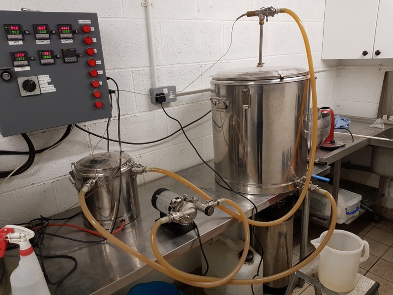

Is that a Blichmann Riptide pump I spy? What happened to the 12V solar pumps? I'm starting to build a proper setup; three vessel, electric heating, maybe HERMS. Either way I'm gonna need a pump or two.Took me a while to get that one, I'm a sucker for punishment.

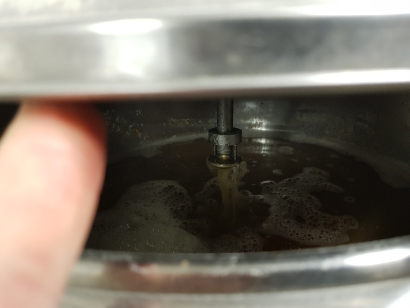

Here's the recirculating through the heat exchanger.

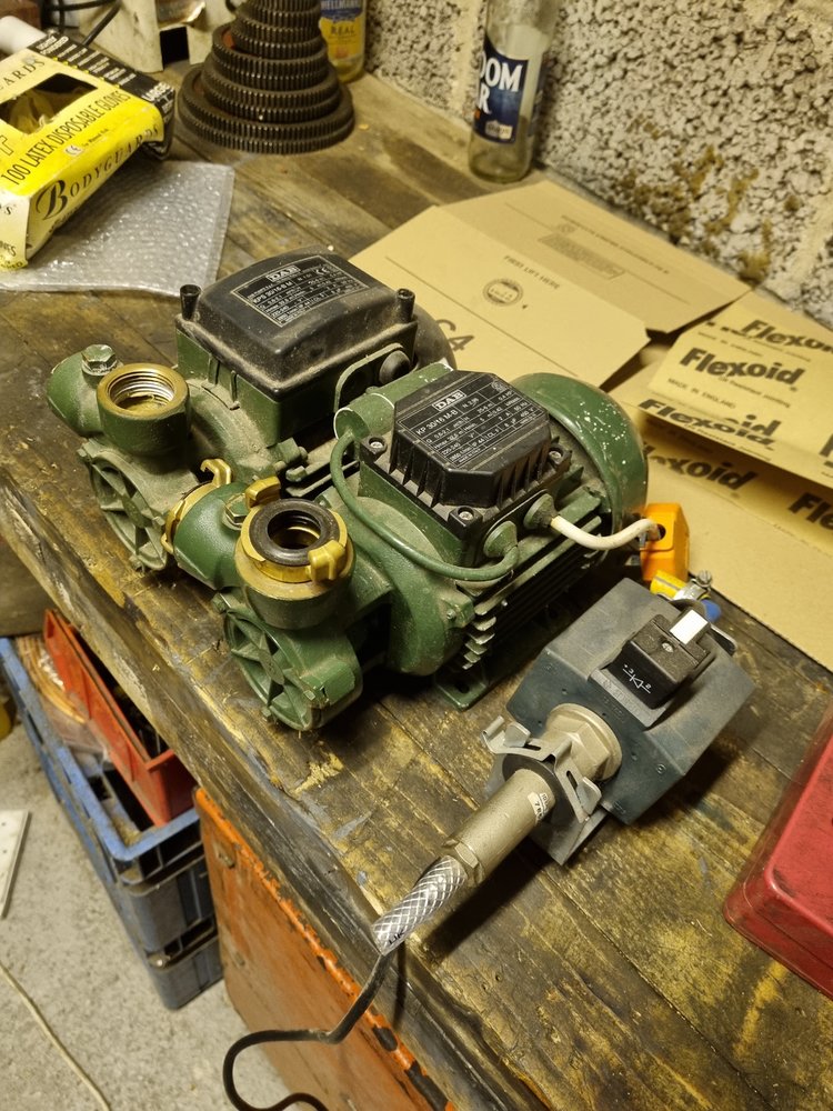

There aren't many pumps that withstand boiling liquids. I also have a Toton brewing pump, only good to around 75c so only good for sparging and crap at priming, even with bleed valves added.I've got a couple of pumps on the shelf here but I think they're probably a bit big, 1" bsp inlets, I assume there's such thing as too high a flow rate? A bit more effort to dismantle and clean too.
Is this the sort of thing you used to use? "Solar pump" doesn't bring up many results. There's magnetically driven stainless pumps on there too, around the 60 pound mark, I wonder if they're any good.
I was wondering what sort of hose you're using too, it looks pretty girthy but I wouldn't have thought one of those little 12v pumps has the flow rate to need much thicker than a garden hose.
there's part A, B, C & D. I forget which ones I buy as I'm suffering from a Sunday lunch torpor, a pint and a half of 5.7% brown ale before and 3 glasses of Chateaux de Chasselas while washing the dishes.
I recognised the camlocks, I've got some big ones here but not stainless unfortunately. I'll see if eBay do them in Chinese stainless, lots of tri clamp fittings on there...
