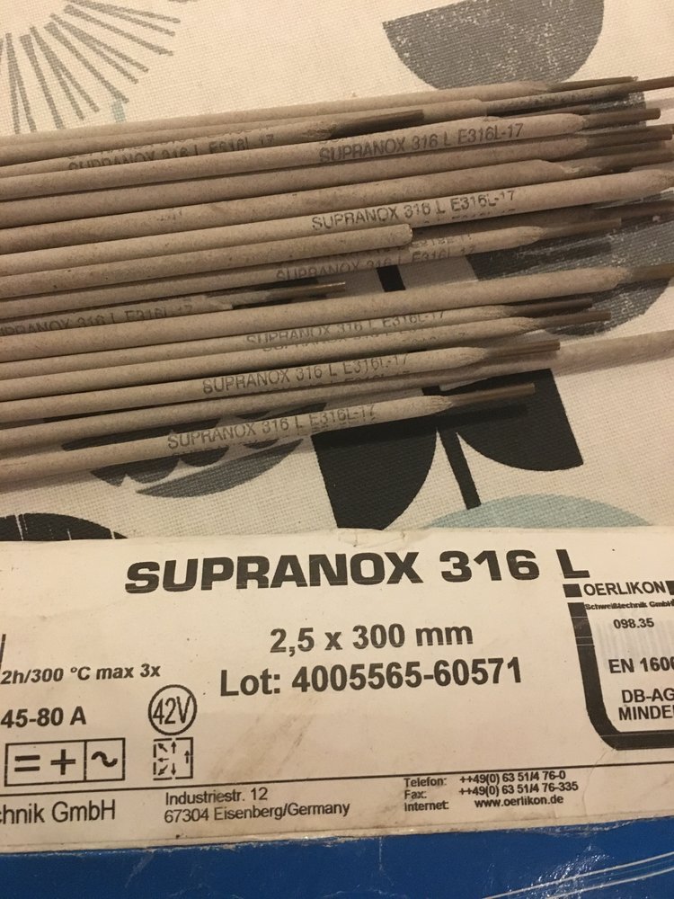

That would be fantastic if you could spare some, cheers.I think I’ve got some 2.5mm stainless rods if you want some posting Adam.
I’ll have a gander what I’ve got and chuck some in a Jiffy bag, if your not in a rush!That would be fantastic if you could spare some, cheers.
I’ll pop some in post mateA handful of 2.5mm would do me, 3.2 are probably a bit too chunky. I think the 253ma rods would be wasted on this but I'll let you know if I ever get a micro gas turbine in for repair.![]()

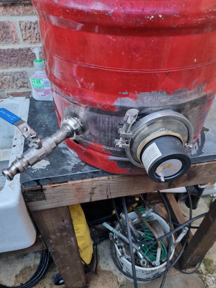

Great stuff glad the rods worked ok for youNo leaks!

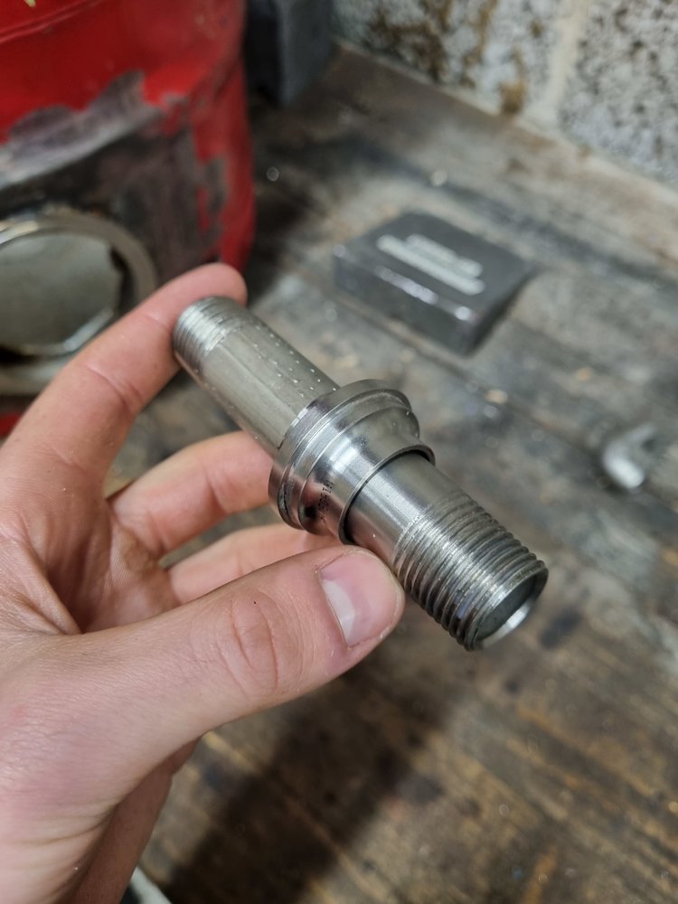

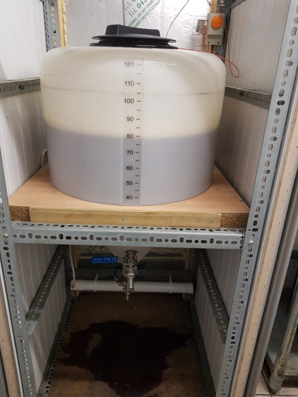

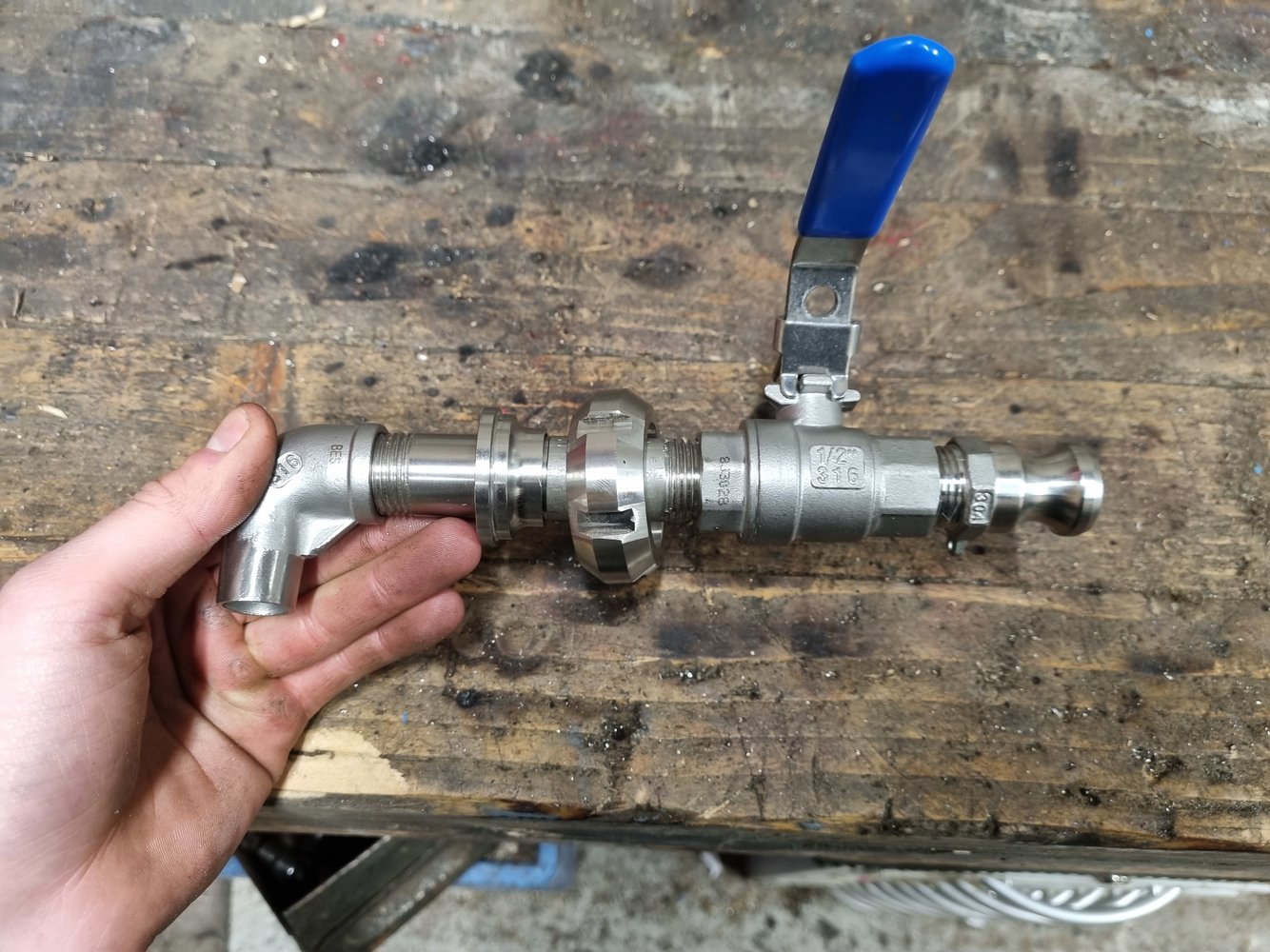

Supranox rods ran a treat, it might just be that I'm getting better at sticking though. Cheers Dale.

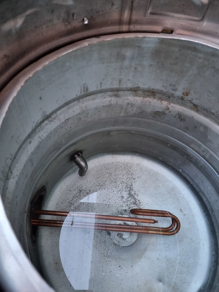

I assembled that passthrough backwards, it protrudes further forward than I wanted while barely making it through the keg, should be fine though. I've also warped the funk out of that triclamp flange, luckily not so far that the gasket can't seal it, but it's a massive pain to get the clamp on.
Bit of tidying up still to do, the back side of the welds are all oxidised and nasty. Do people backpurge with MMA?
*This* close to finishing.![]()
If it's an open joint you do not need to purge but if it's not you need to either use a backing tape, purge or use solar fluxNo leaks!
