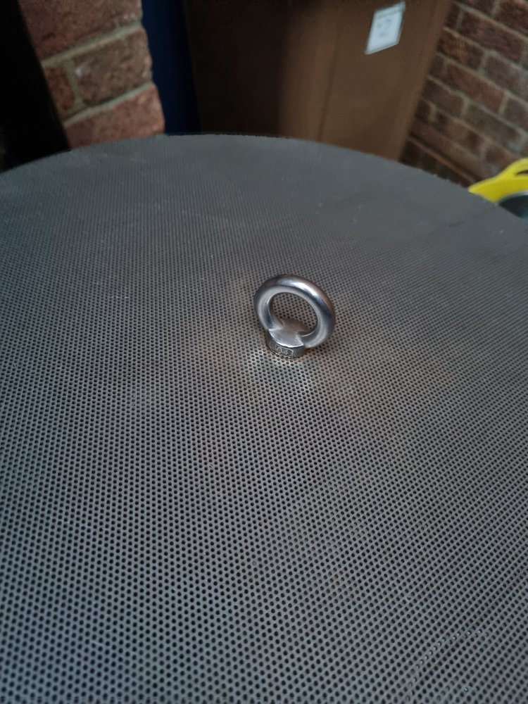

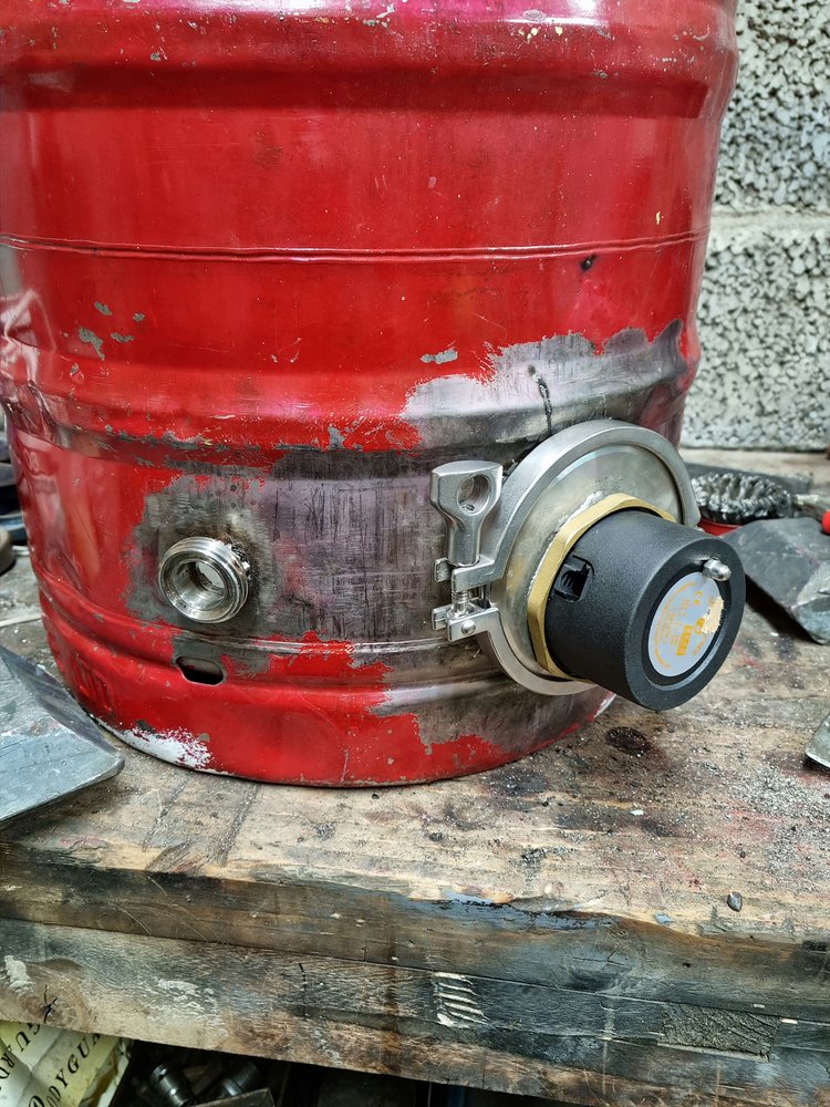

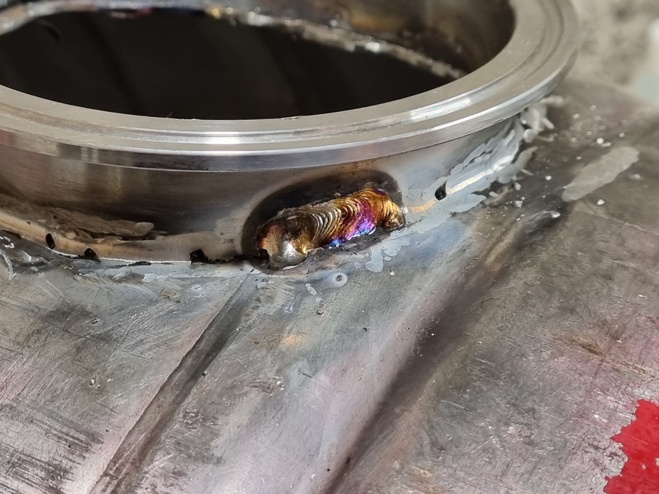

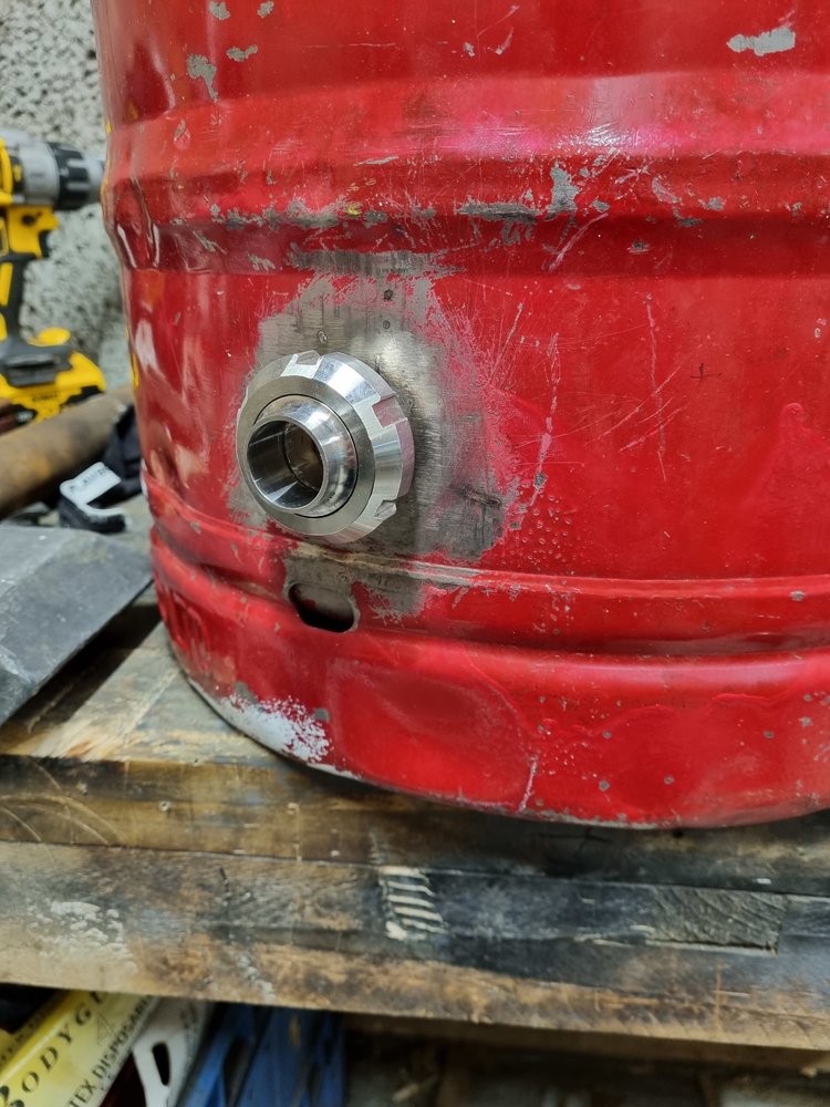

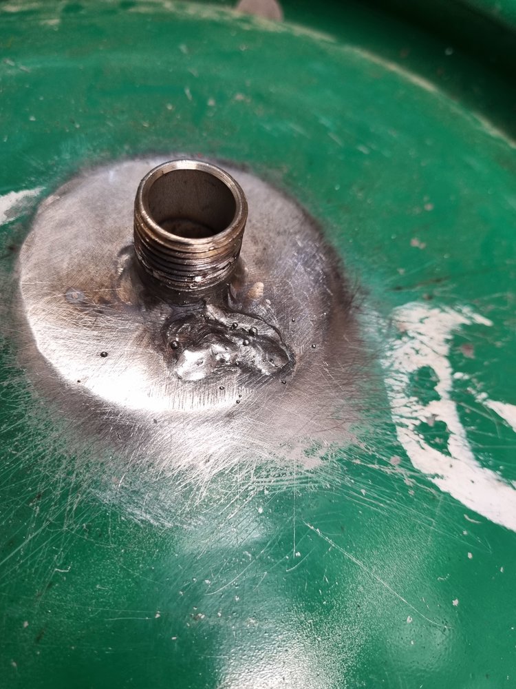

You'd be better off with some 1.6mm stainless sticks if the TIG is that badStuck the fitting for the racking arm on the side of the kettle.
Luckily an SMS nut is big enough to obscure the weld, because this one's even worse than the last.![]()

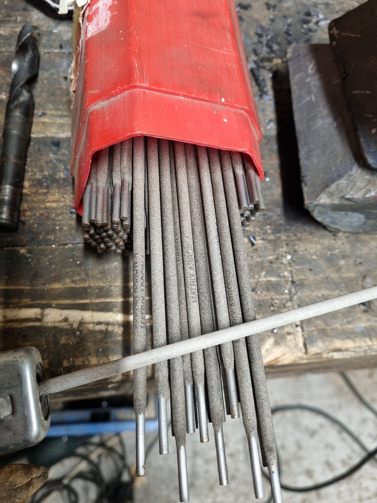

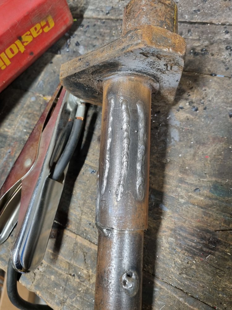

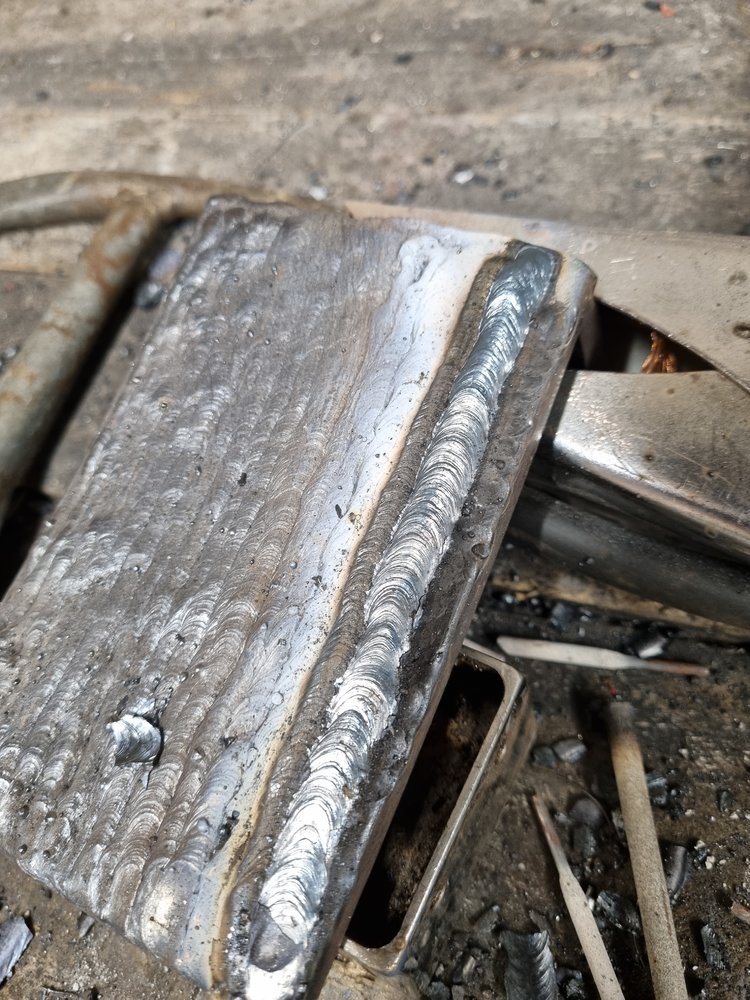

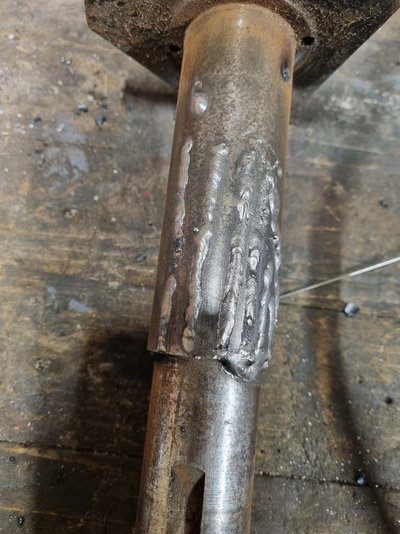

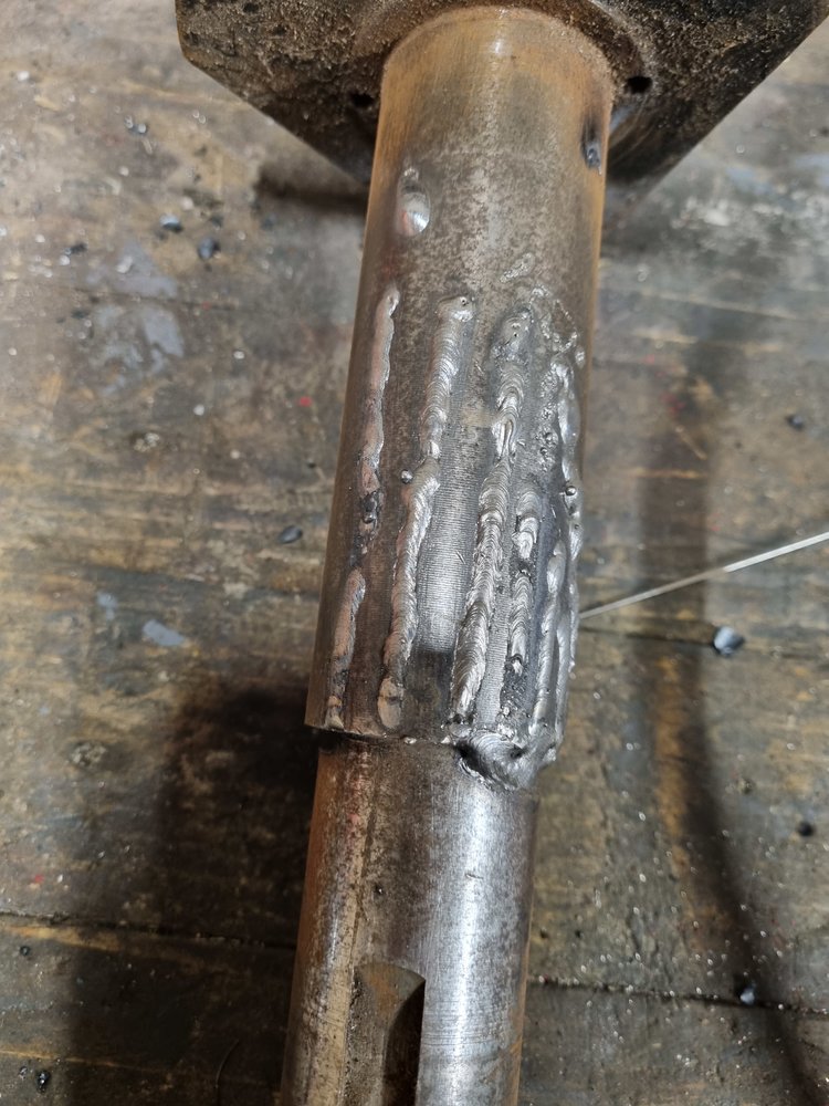

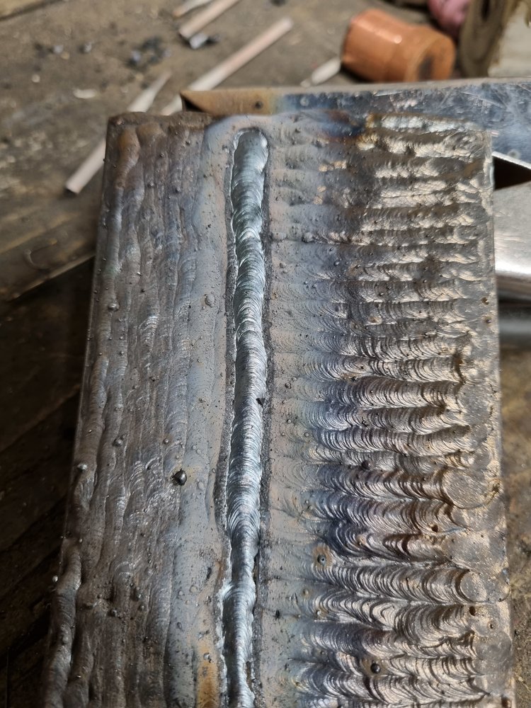

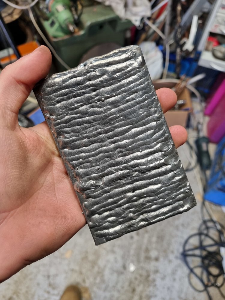

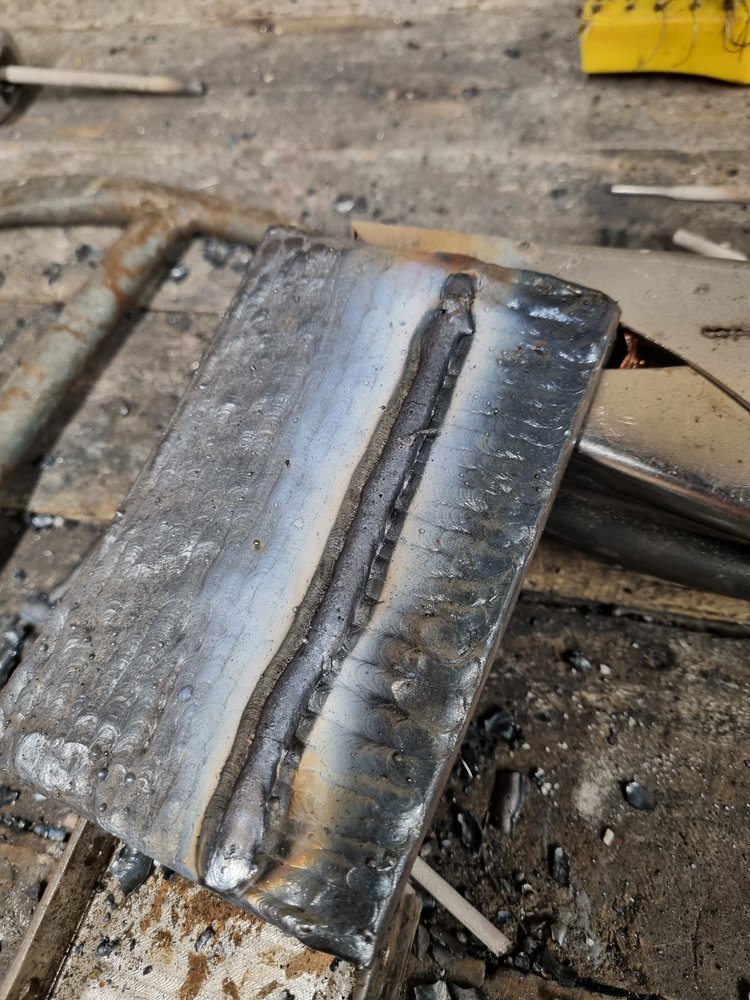

Don’t forget the safety flips flops and have good few measures of your last home brew tooRather than learn what to do, I thought it would be more fun to just wing it, bang some random old electrodes I've had kicking around for years against a rusty old crankshaft and see what happens.
That's 2mm and 3.2mm electrodes, 60-110 amps in both polarities, now to get some identifiable rods, set the machine properly and learn what I'm doing.
Sure is fun, hot sparks everywhere, I'll wear jeans and a cotton coat tomorrow!![]()
244 is a nickel rod for repairing cast iron. Your welds would be bright silver like stainless and the flux is usually blackBit of practice.
That's mostly using 2mm rods (Left here by the previous homeowner), they seem to run just as well in electrode positive and negative, with slag which peels off in big pieces, I think that points to them being 6013 or 7018? I did a couple of beads with the 3.2mm rods, they're in a Castolin 244NC box but Brad thinks that's not what they are. I don't like the way they run, louder and scarier, I wonder if the flux is damp?
