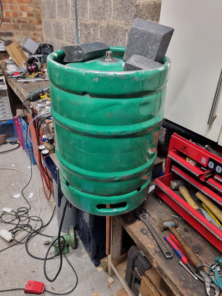

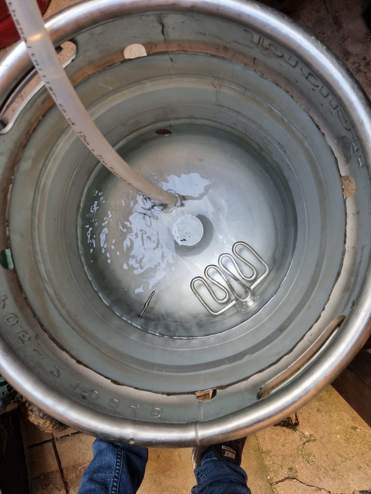

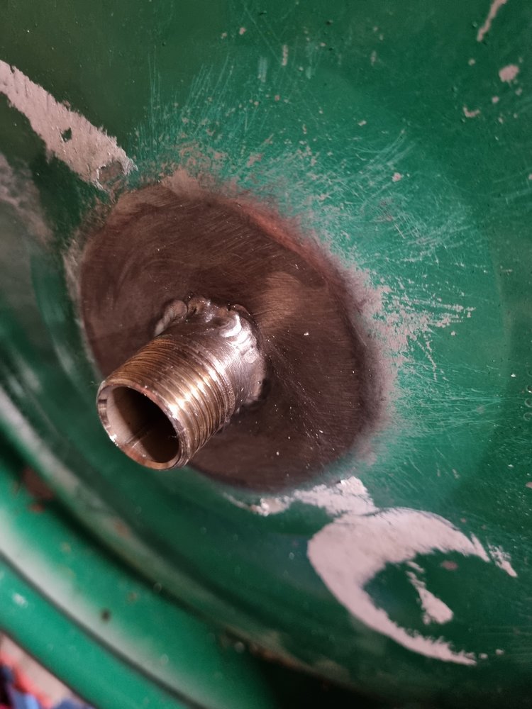

Just put your finger in itMy back purge hose came so I stuck my thermowell on. Pretty poor welding but it's water tight so I don't care.

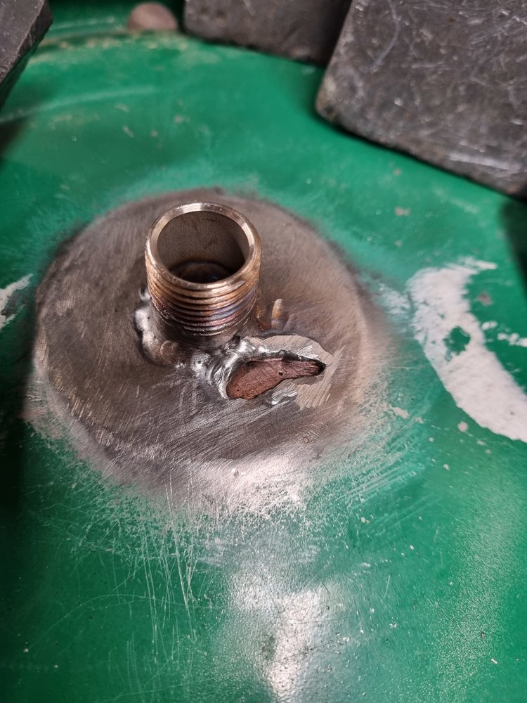

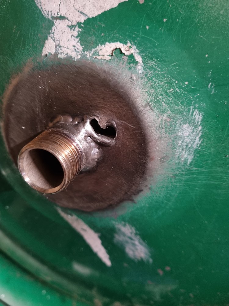

Spurred on my that success I tried the outlet nipple. Again pretty poor welding but serviceable, aside from a little hole, which became a bigger hole when I tried to patch it up, and then an even bigger hole.
I think I'll try backing it up with copper tomorrow and have another go
