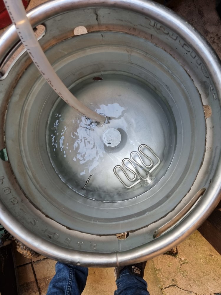

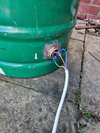

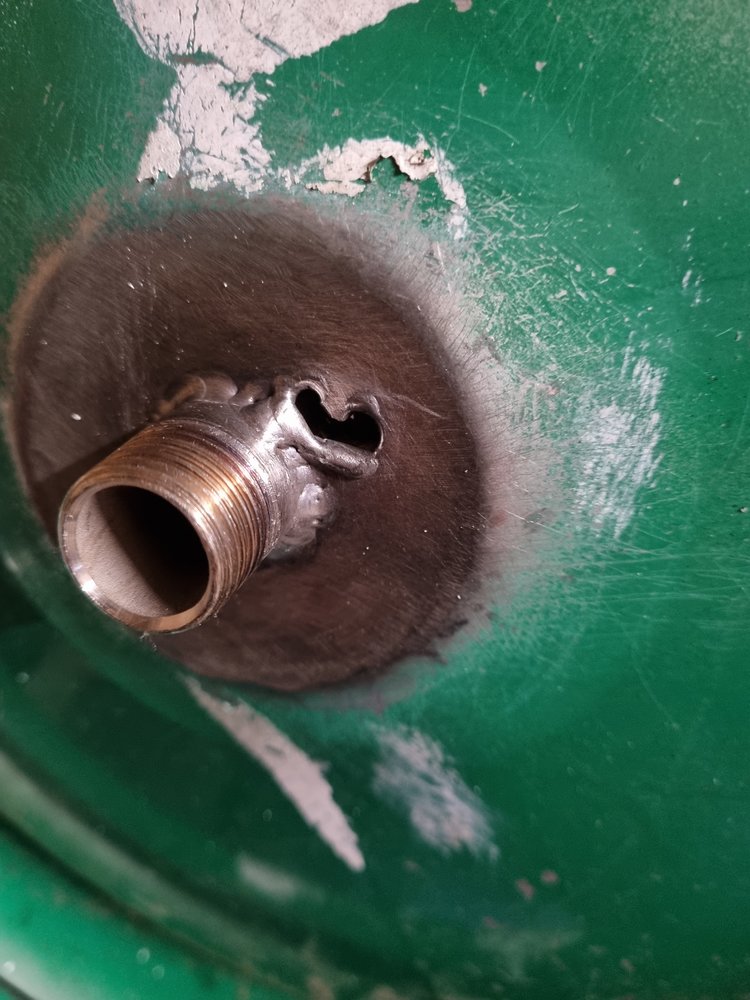

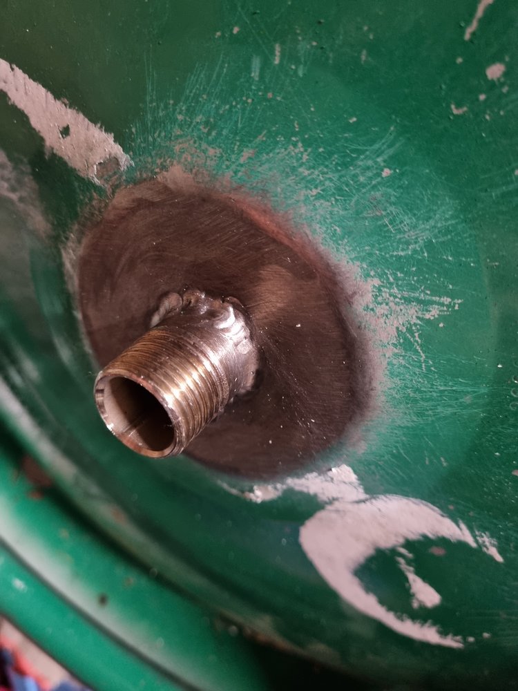

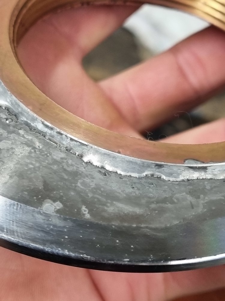

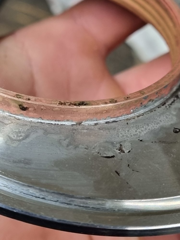

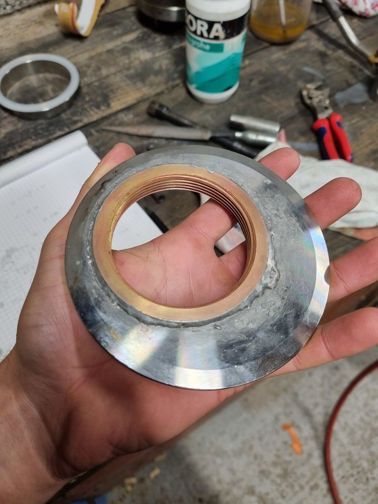

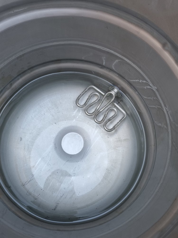

Plumbers solder won't stick to stainless afaik? So possibly just filling the gap might be OK but I would hot cycle it a few times to see if it playsIt turns out they make brass flanges with a 2 1/4" bspp thread for soldering to hot water tanks. I did find a stainless one for twenty quid but a brass one was two quid so I thought I'd try my luck with solder.

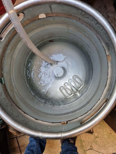

It doesn't look like it's wetted the stainless very well (Until I did it by accident the other day, I didn't think it was possible to solder stainless at all) but the back side looks reasonable. It's holding about an inch of water back, I can't get any pressure behind it until it's all welded up unfortunately.
View attachment 319599View attachment 319598

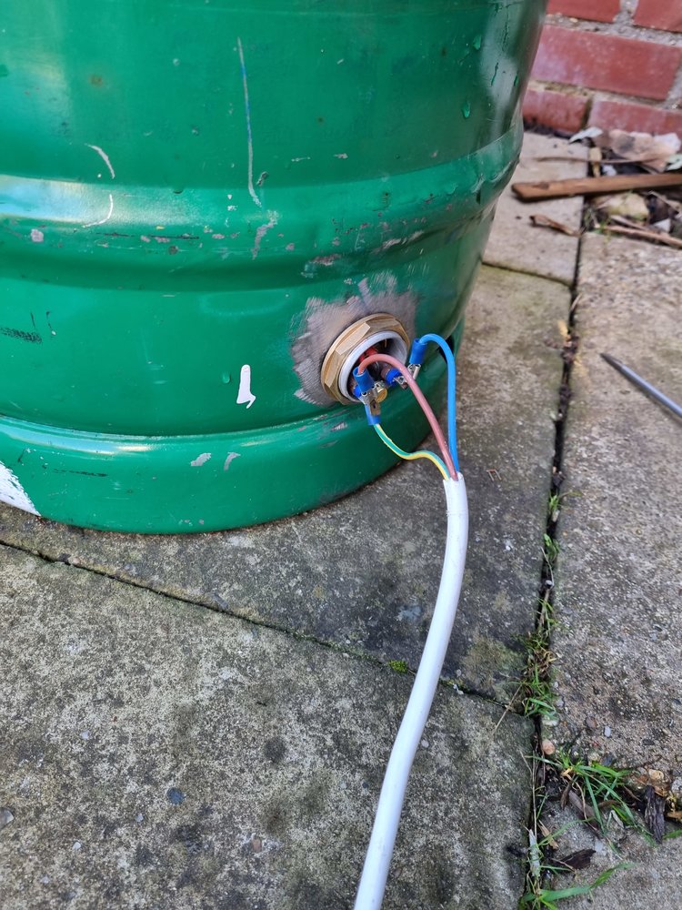

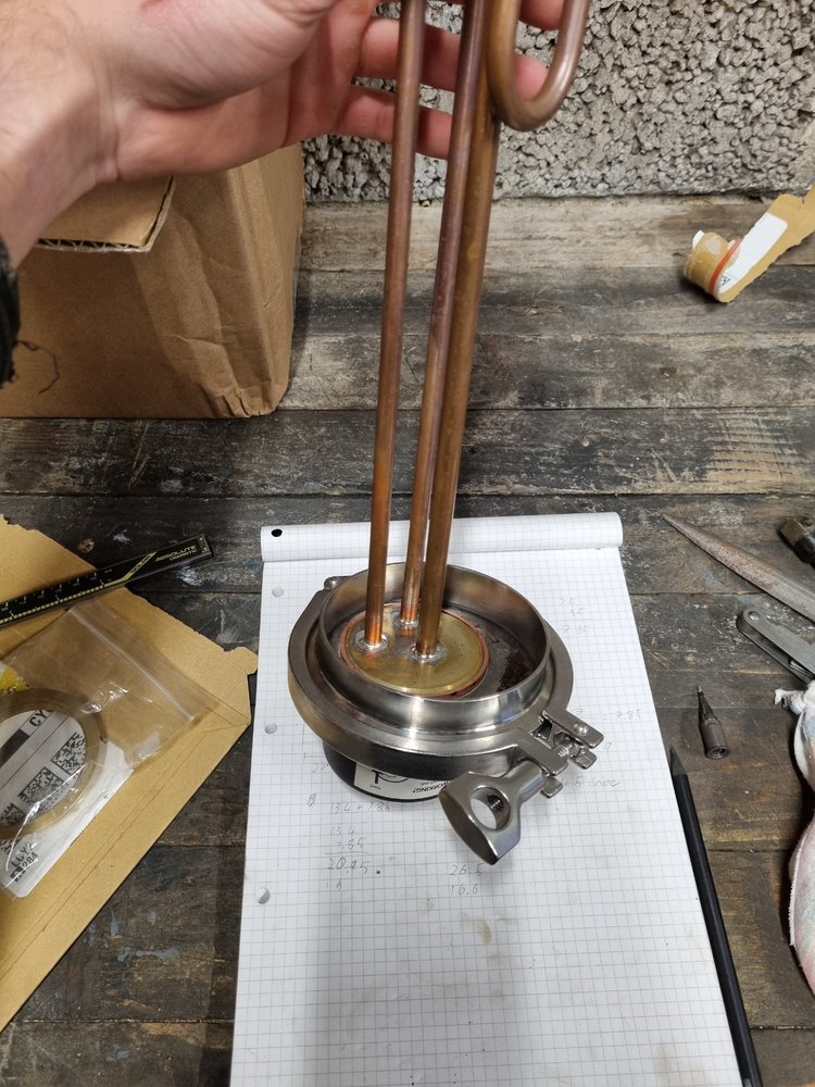

I'm happy to call it a success for now, triclamp heating element on the very-cheap.
That's what I thought but when I made the coil I accidently stuck it to the stainless sheet I was using as a backer. Maybe I've got a really good flux or something?Plumbers solder won't stick to stainless afaik?
My plan exactly… sometimes it kind of sticks, but I wouldn’t want to be reliant until testedThat's what I thought but when I made the coil I accidently stuck it to the stainless sheet I was using as a backer. Maybe I've got a really good flux or something?
I'll boil some water with it before I commit to running beer through it, that way if it fails I'll scold my legs but won't waste any beer.![]()

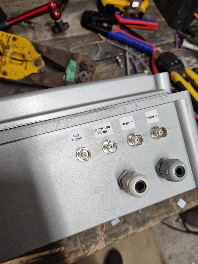

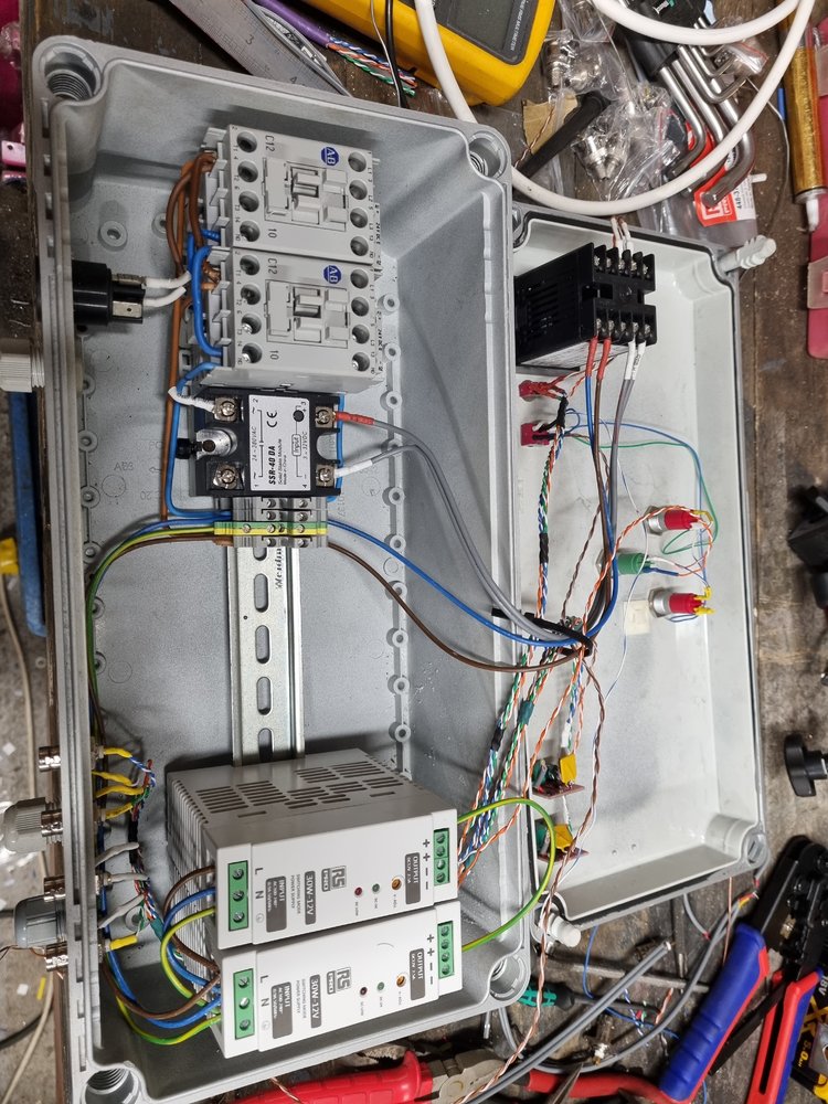

The plugs are of course supposed to be crimped onto coax, I need to figure out how to use cat5 instead, simply because I've got about a gillion miles of it. That's why there's a lot of twisted pairs inside too.

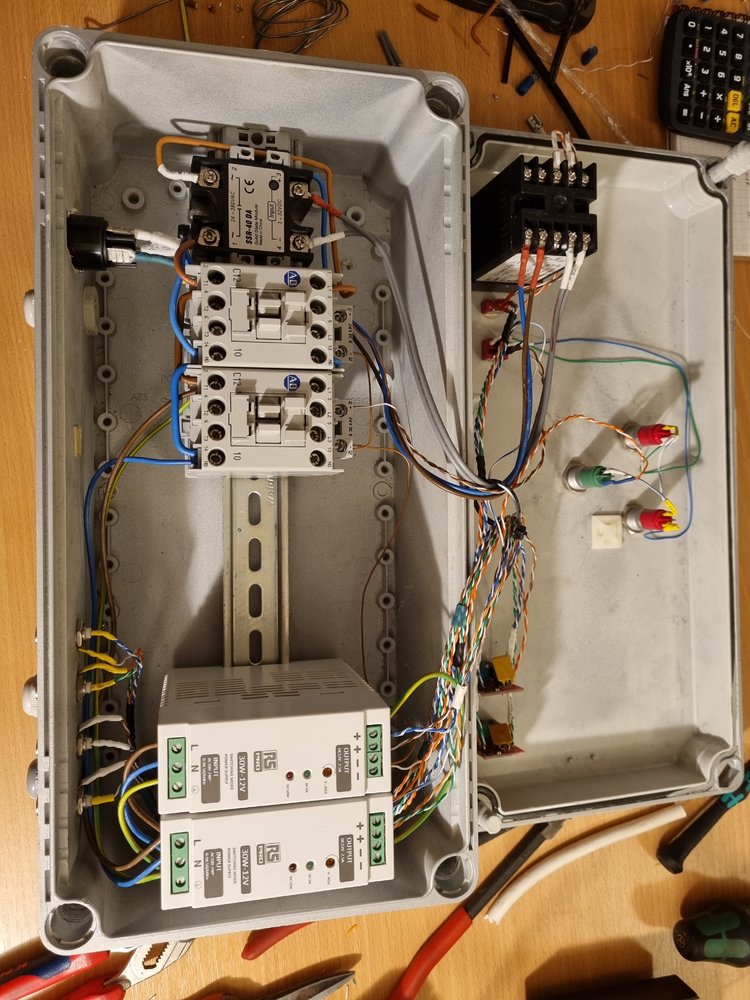

You plonker Rodney!Somehow I didn't notice I've put the contactors right where the temp controller is, so it still doesn't fit.![]()
happens to us all.

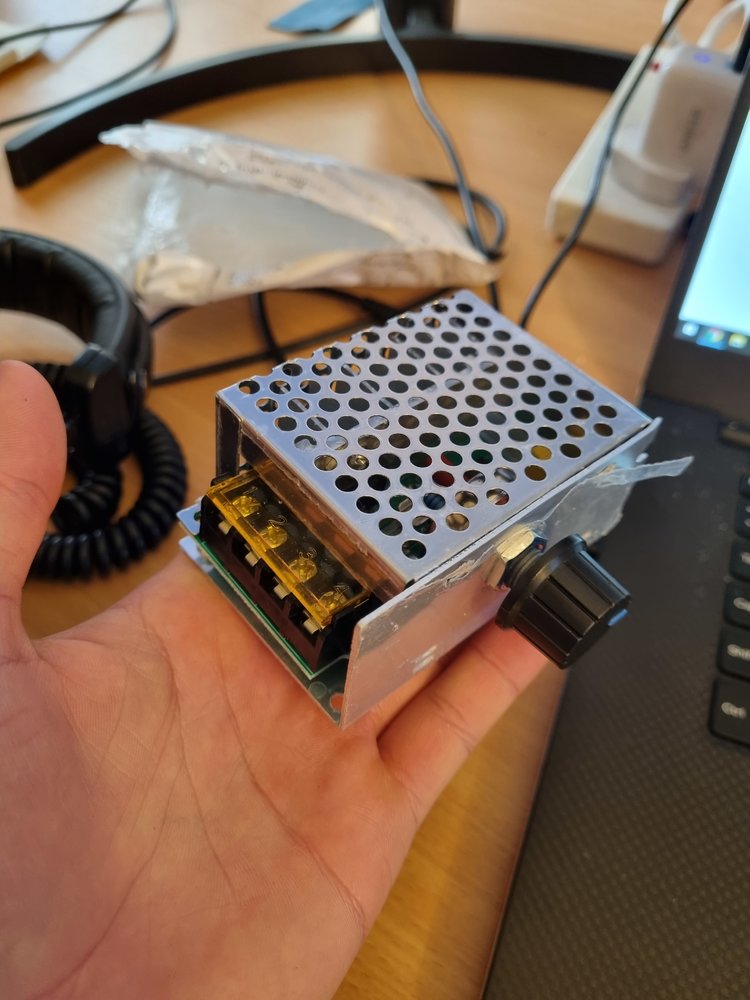

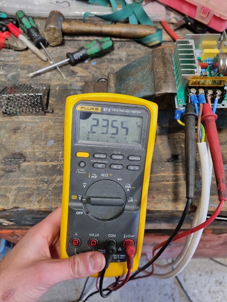

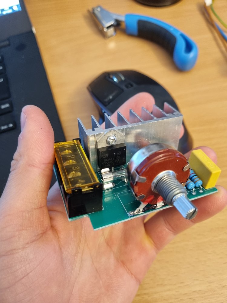

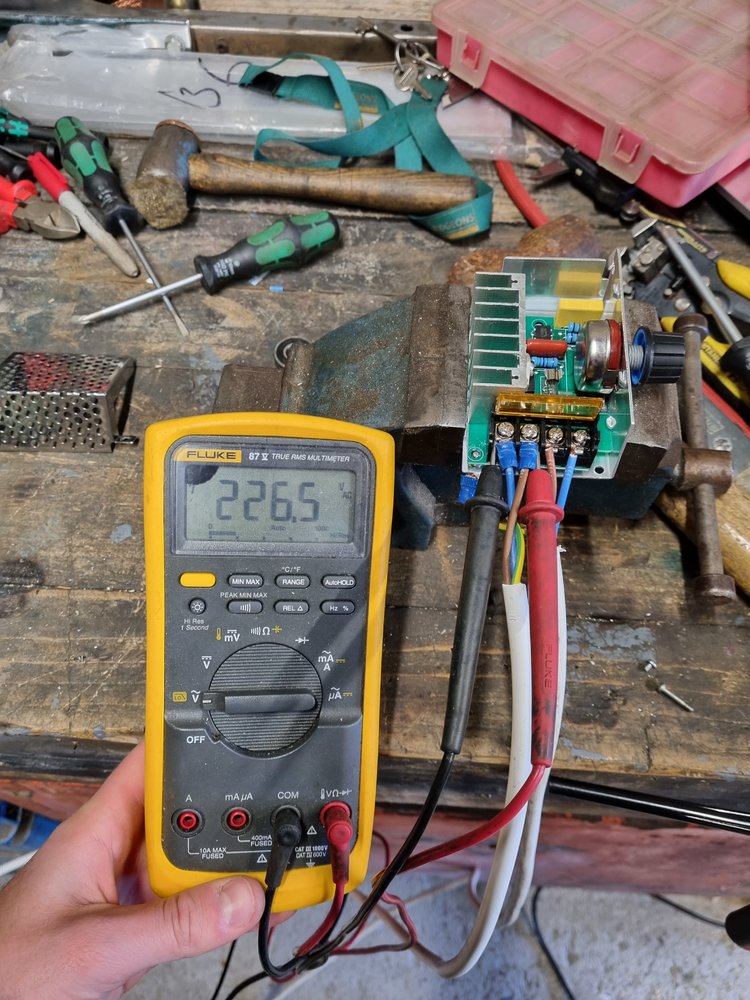

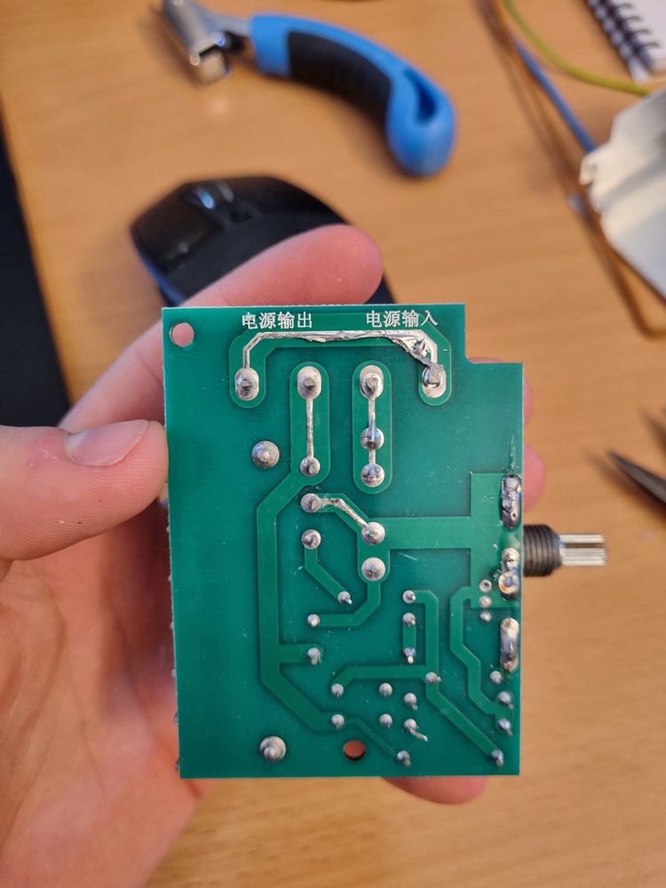

The datasheet for the triac lists the max operating temperature as 125 degrees C so I suppose it's fine. I'm still reluctant to fit it though, if it does decide to catch fire it'll ruin my power supplies and contactors.
