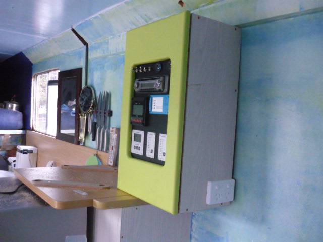

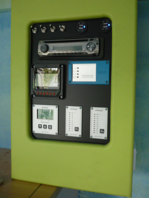

I don't like that mains socket! Wish I'd placed it centrally on the side of the cabinet; it will annoy me.
Easily moved. Fit a double so it takes up old and new location covering exiting hole

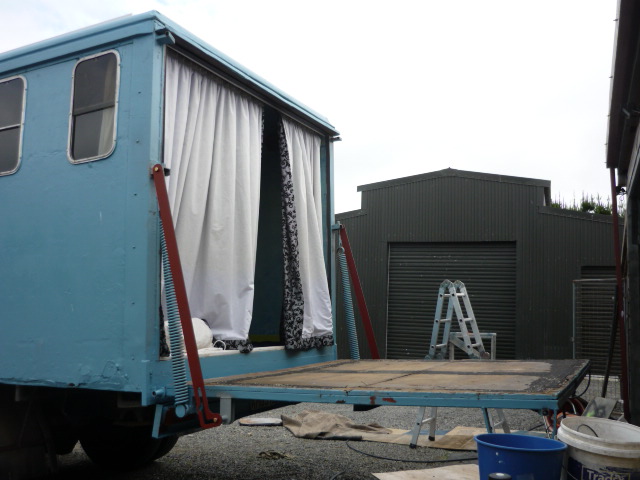

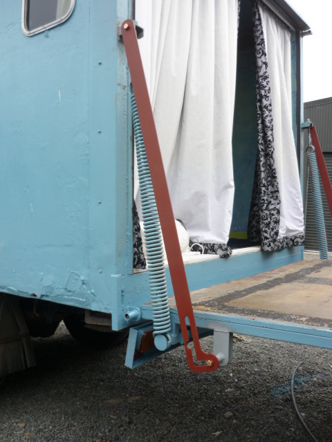

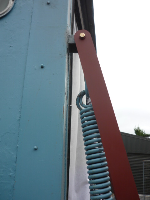

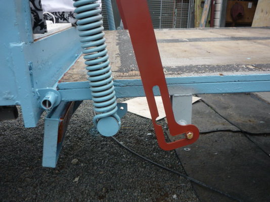

I fitted some stays so that the back door can be dropped down level and used as a deck. The parts were laser cut and when they came back I found that I had cocked up on the measurements and the slots in the stays nowhere near long enough. After rethinking the design I mounted them upside down and they work very well, probably better than plan A. Strange how things turn out.

Add another double one to the left if you have space to give you four sockets . One will always be needed for the phone charger or video game etc. & one for the slow cooker whether it is being used as a cooker/ sterilizer or a gentle back ground heater .I don't like that mains socket! Wish I'd placed it centrally on the side of the cabinet; it will annoy me.
