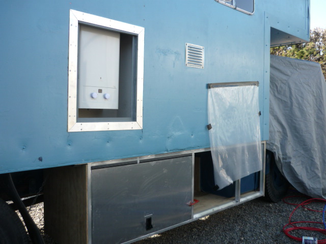

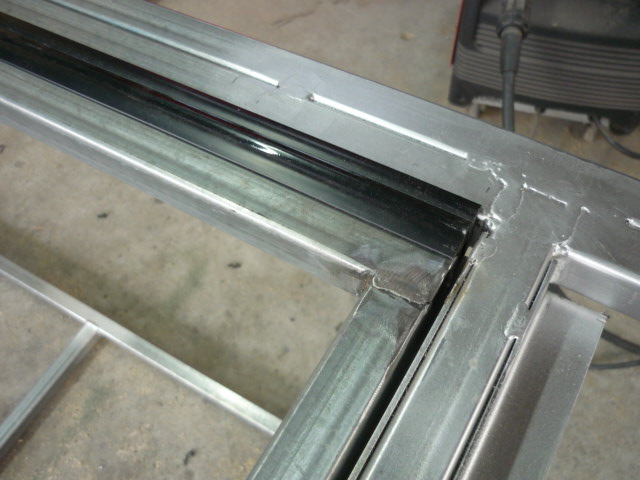

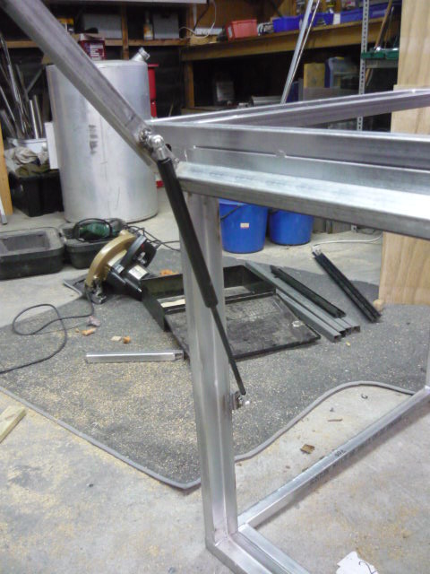

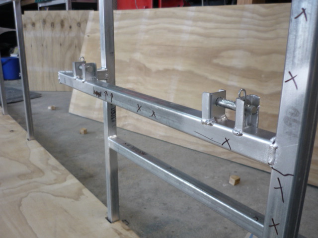

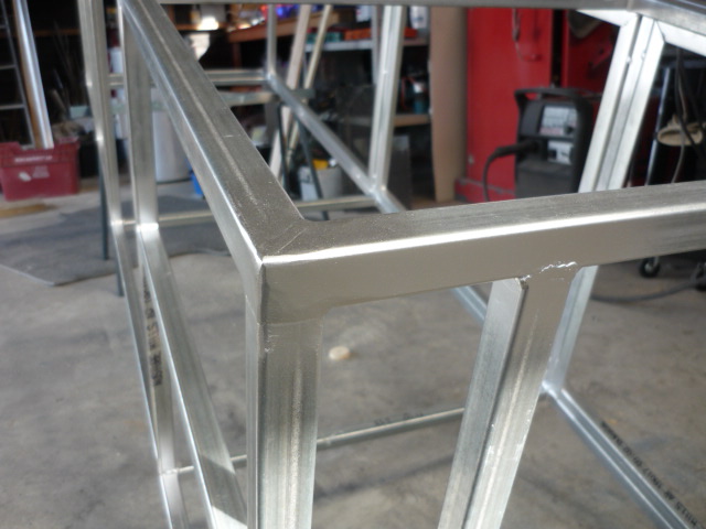

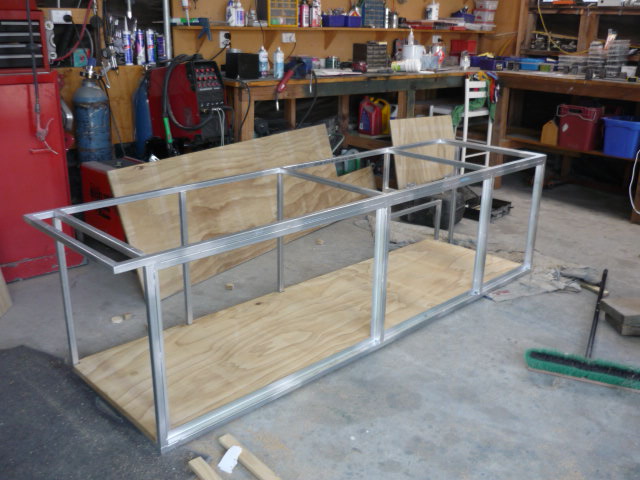

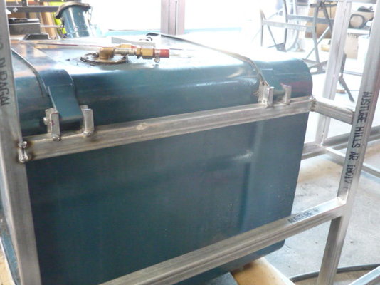

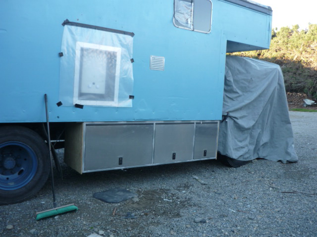

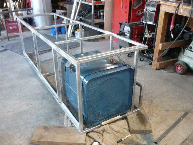

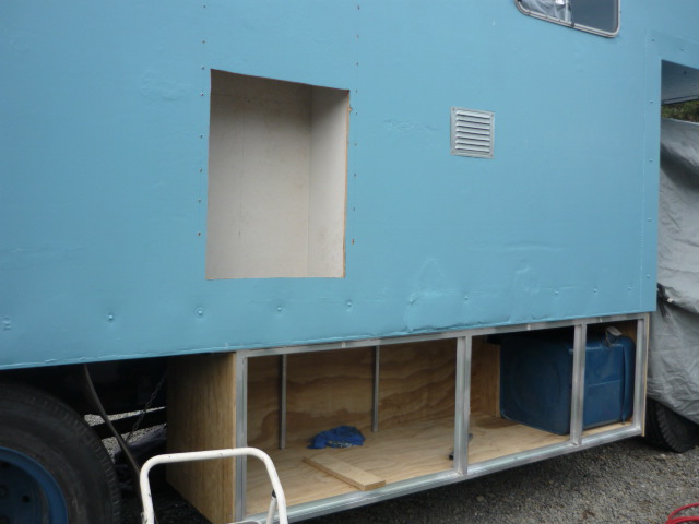

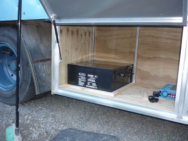

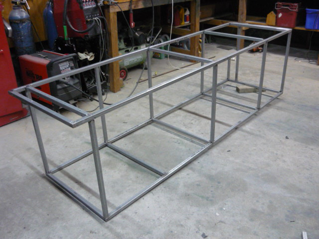

Getting towards the end of the first side-locker.

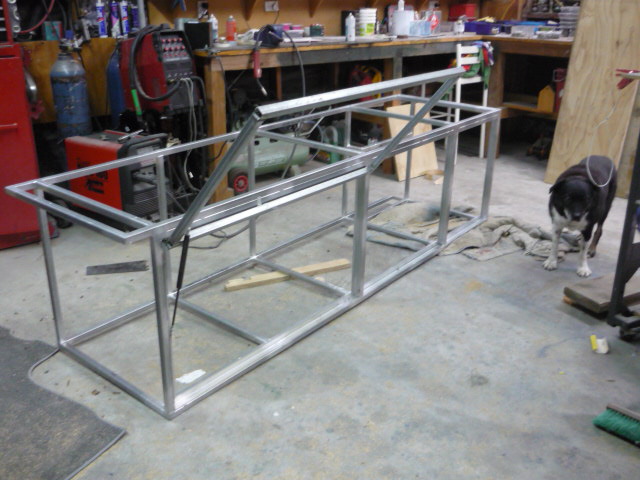

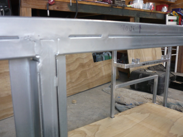

I doubled up the top front rail to add stiffness and to lower the hinge-line to clear the body

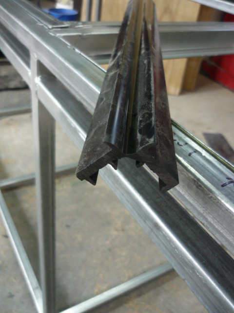

and added door shuts

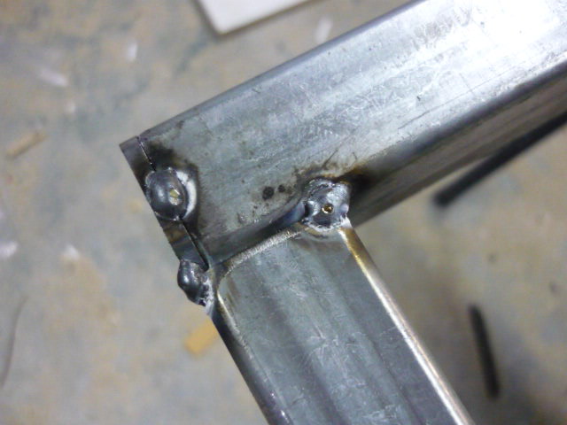

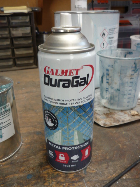

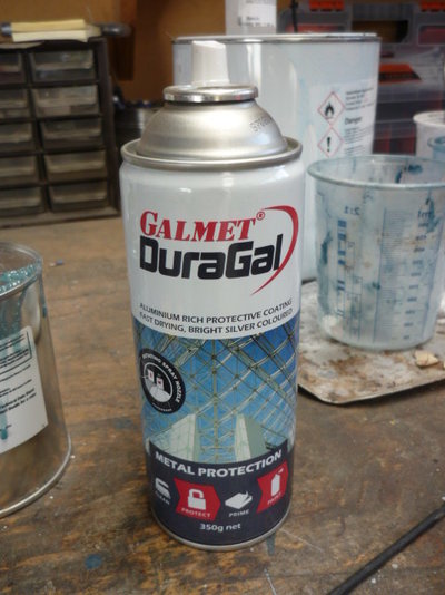

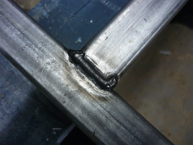

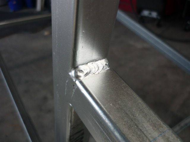

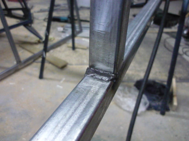

It's all 25x25x1.6 Duragal SHS with this primer on the welds
It matches the tubing quite nicely and goes on nice and smoothly

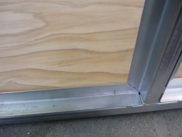

Floor is 25mm treated ply.
