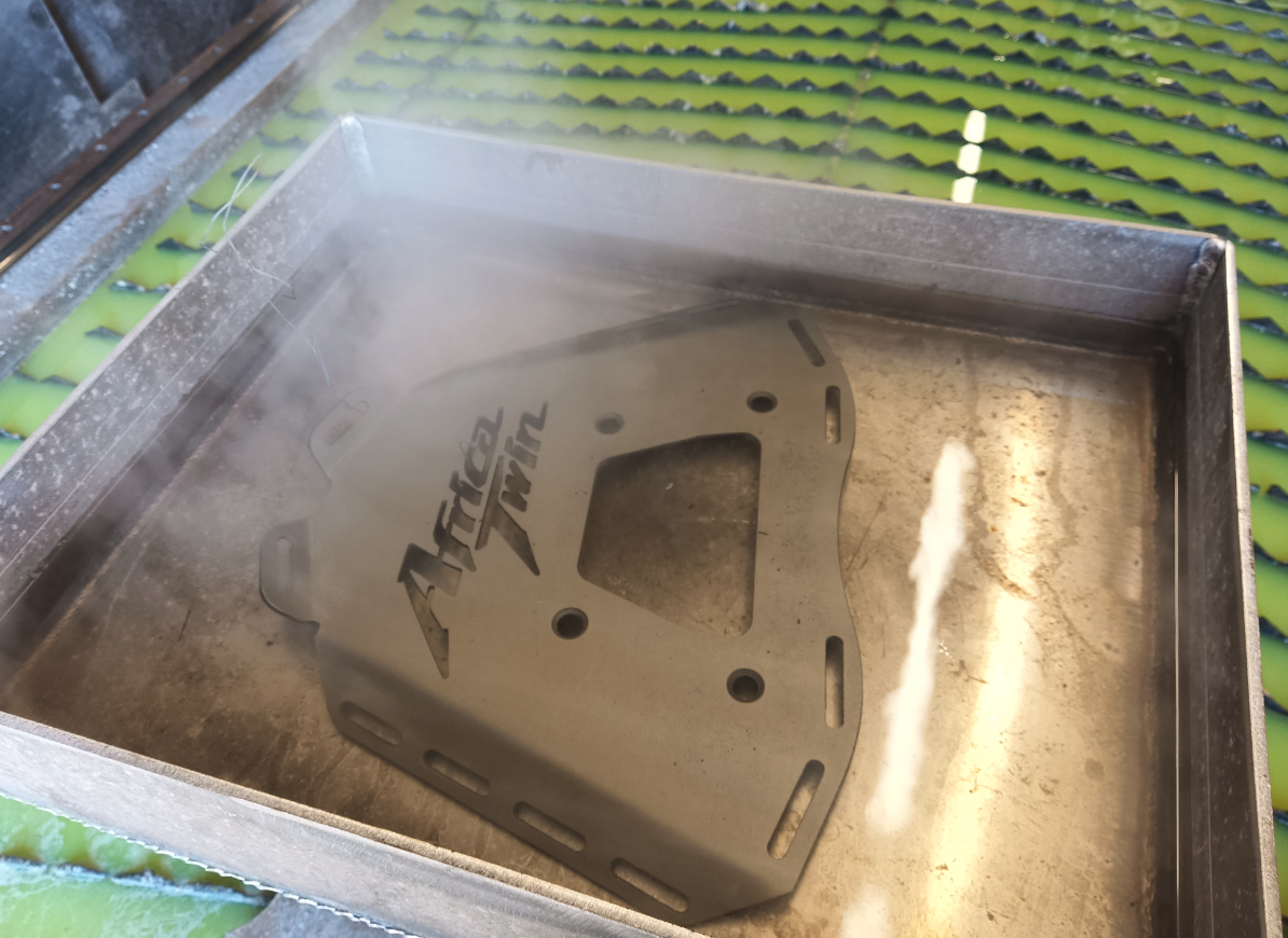

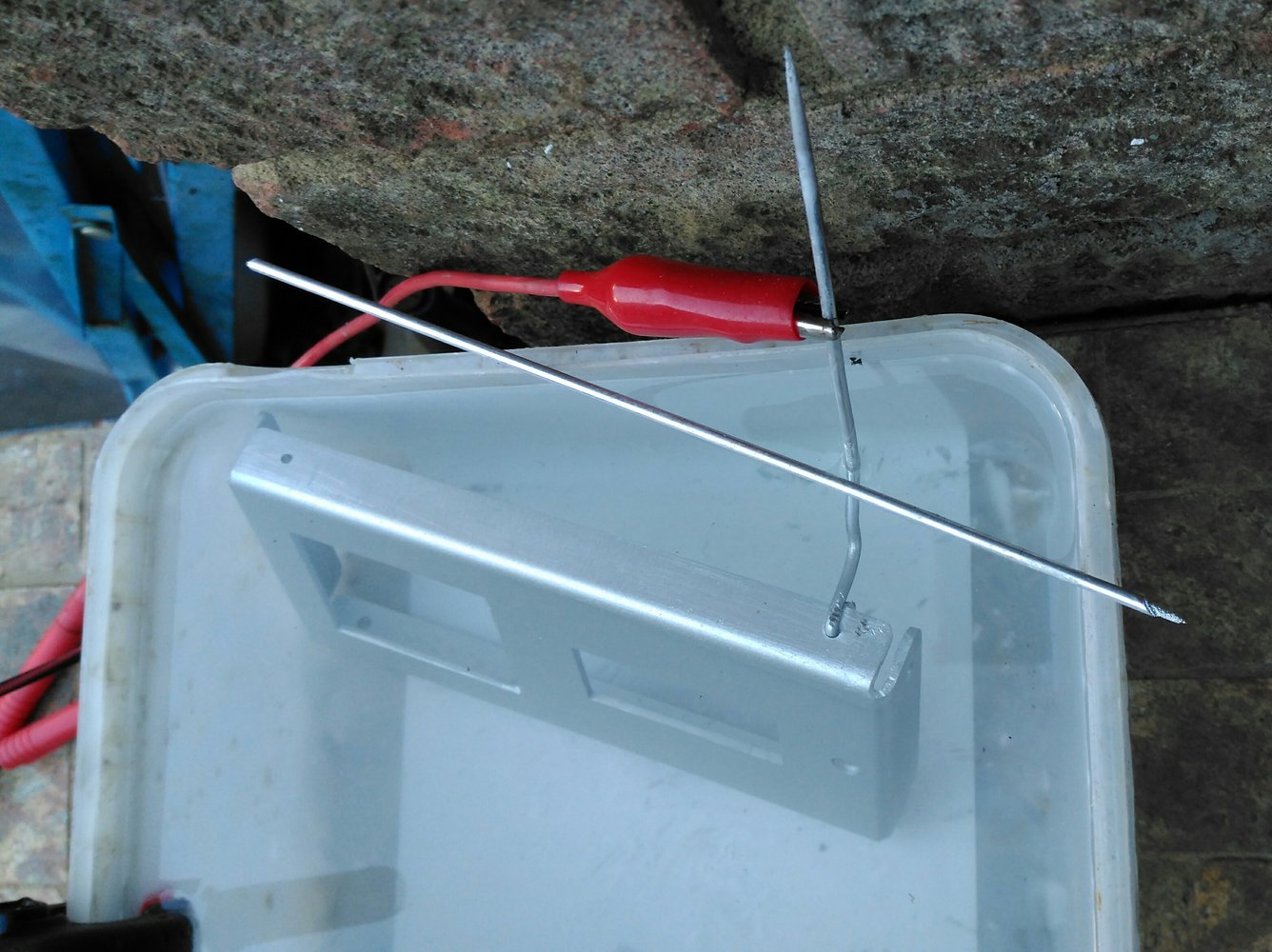

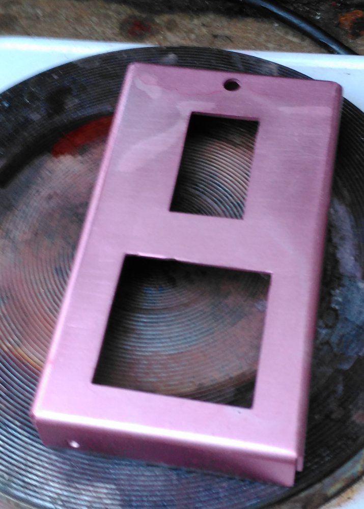

Hissing sound... The sound of failure
Eating straight through my wires due to poor contact and the full current acting on wire, no current with the wire raised out of acid.
Everyone else seems to have success wrapping wire loosely around a hole. This is crimped with pliers, still no good.
I know titanium wire can be used, but that wont stop the part anodising in contact with the wire and doing the same thing..
Any ideas? Cant be arsed to get the tig out..
