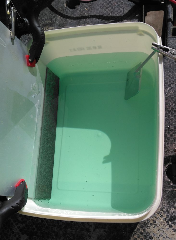

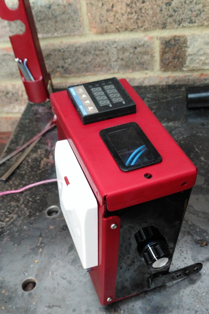

Started with the small test piece. Based on 37cm² and 6A/foot² Im running at 240mA, aluminium cathode and sulphuric acid. As this sulphuric was generated using a lead annode theres a fair bit of dissolved lead which is plating out on the cathode. I'll clean it off before I do the proper parts.
thats annoying as I cant rule out the orange, I may have cocked it up.
