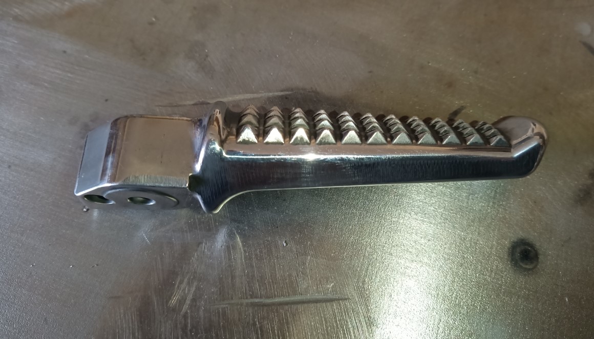

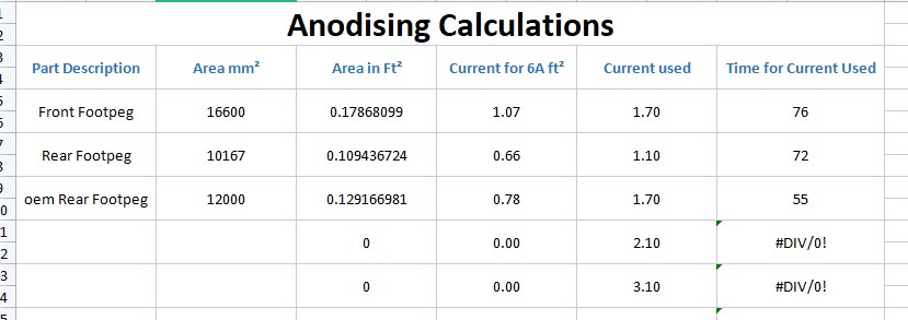

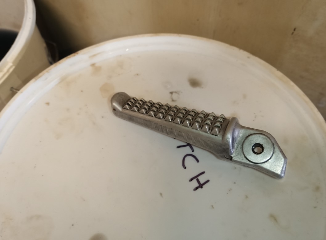

I concurIf anyone wants to check it was 2hrs @1.1Amps and surface area of 16600mm² (0.18ft²)
^ Is wrong, sorry (I typed 10600 into my spreadsheet)I think you said previously that the area for the footpeg was 16600 mm^2 = 0.11 sq ft, so that would be ~0.7A for 6A/sq ft

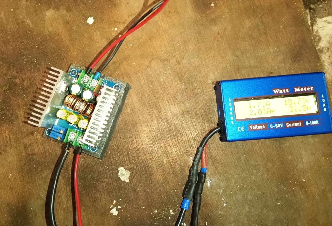

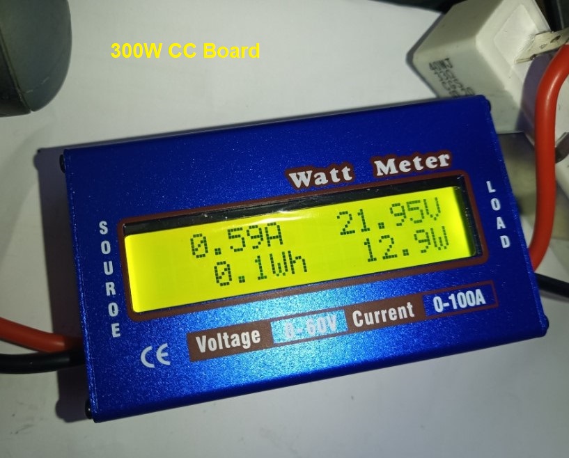

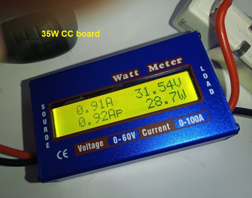

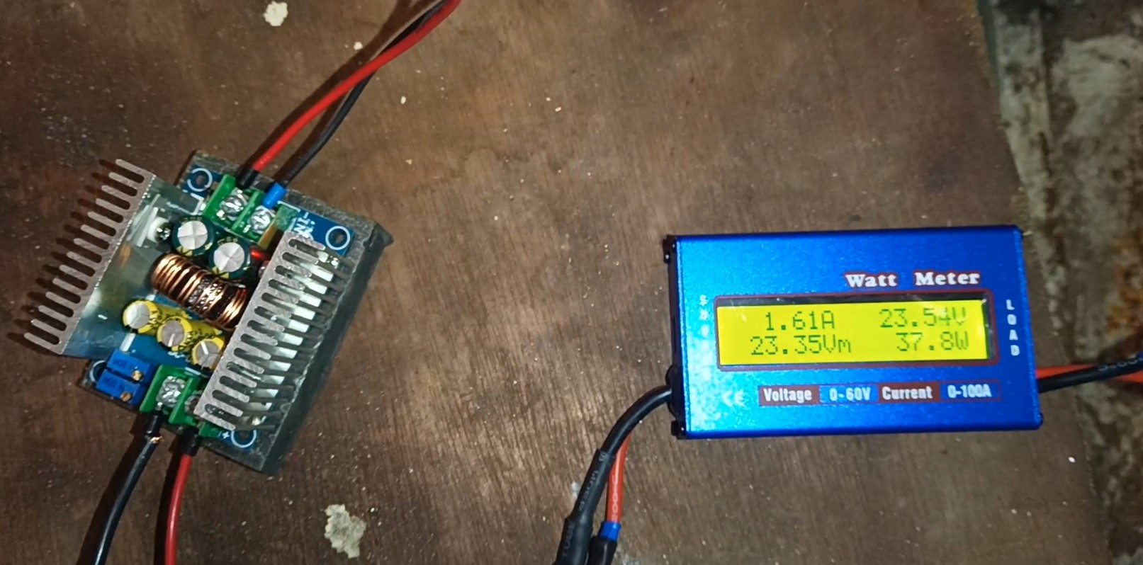

I'm guessing the quoted output isn't what they claim it to be.Well I don't have a clue how that CC/CV buck boost board is meant to work.
It is connected to a 24v PSU and a big resistor is at the other side of it. Max I can get out is 21.9v @ max current of 0.56 Amps.
If I reduce the current the voltage drops but I can not increase it. If I drop drop the voltage with the current at the 0.56Amps then the current starts to drop as well.
