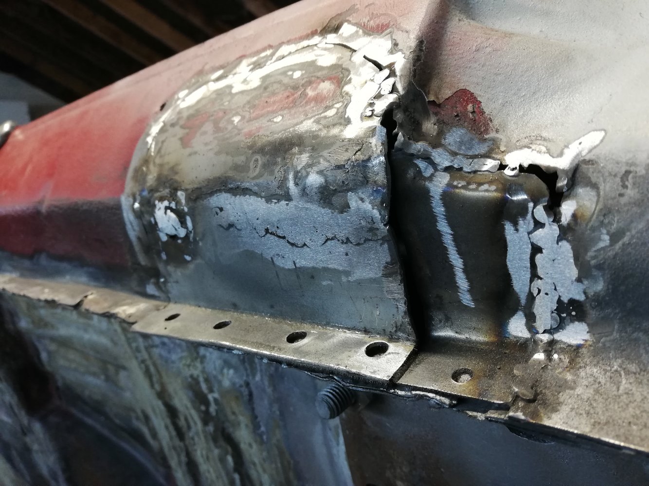

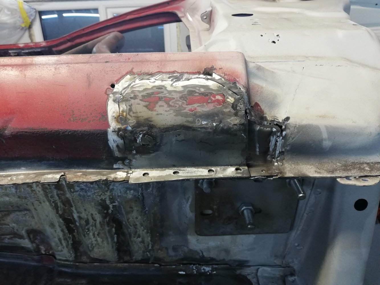

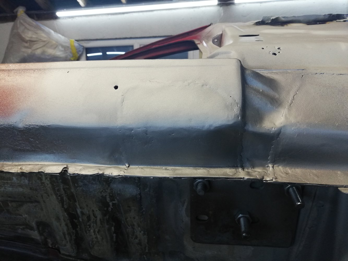

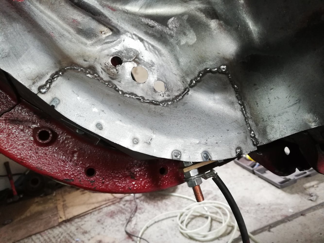

Yea, i'm not sure whether or not to seam seal it, as it may provide an exit for any moisture run-off from inside the sills/pillars etc......although I will be spraying wax into all the cavities anyway ....It interesting looking at your sill my outer sill actually has a tiny 90 degree lip on the edge that covers the seam where the 3 pieces join I assume to prevent moisture flicking up into the gaps that I thought was a neat touch.
