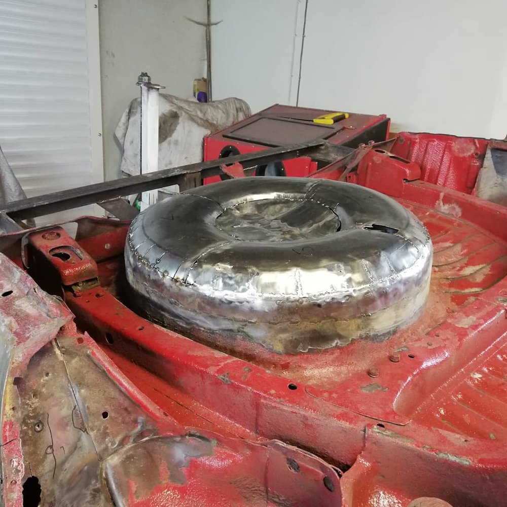

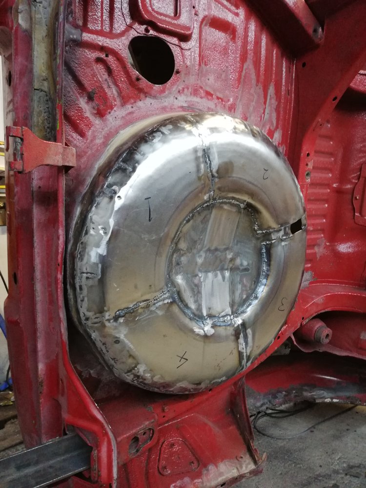

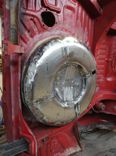

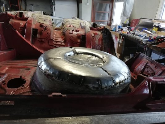

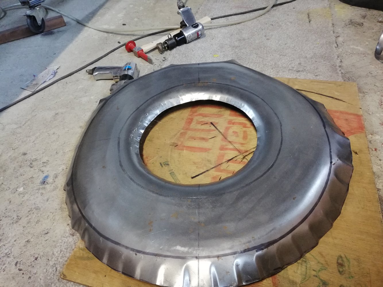

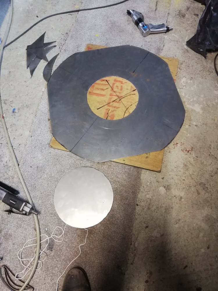

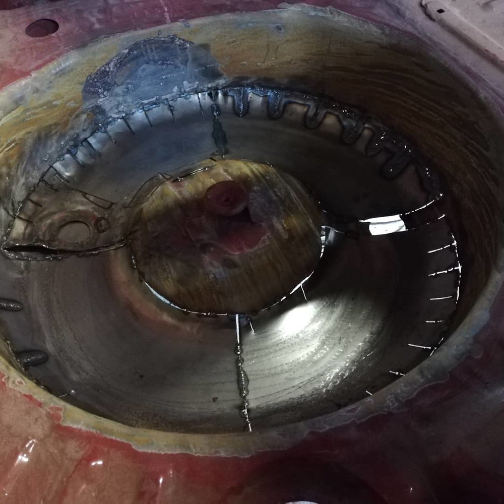

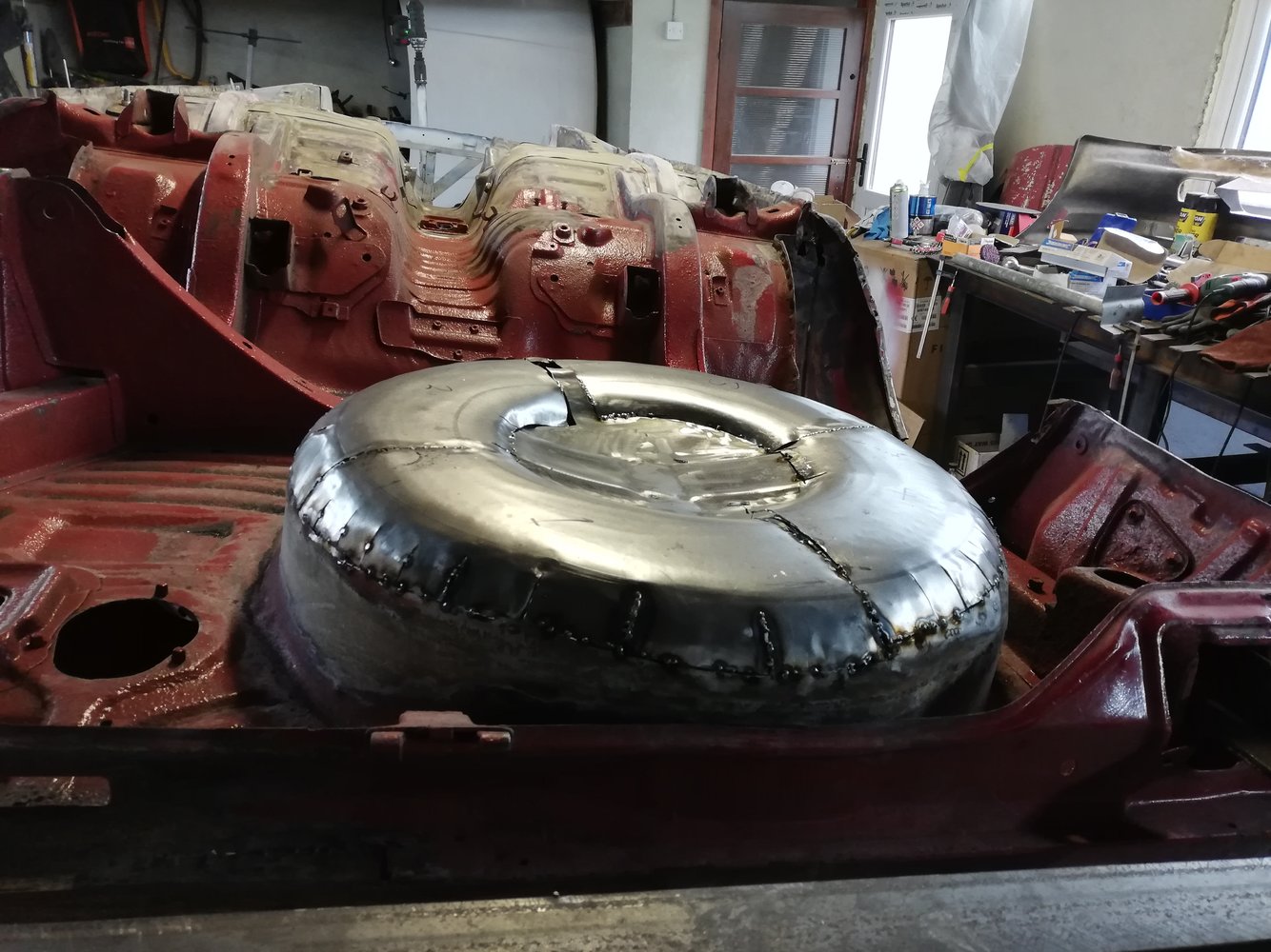

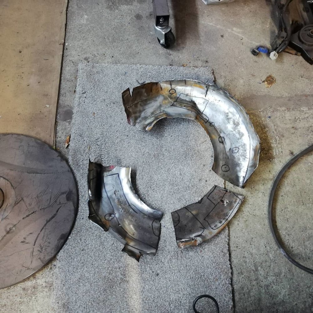

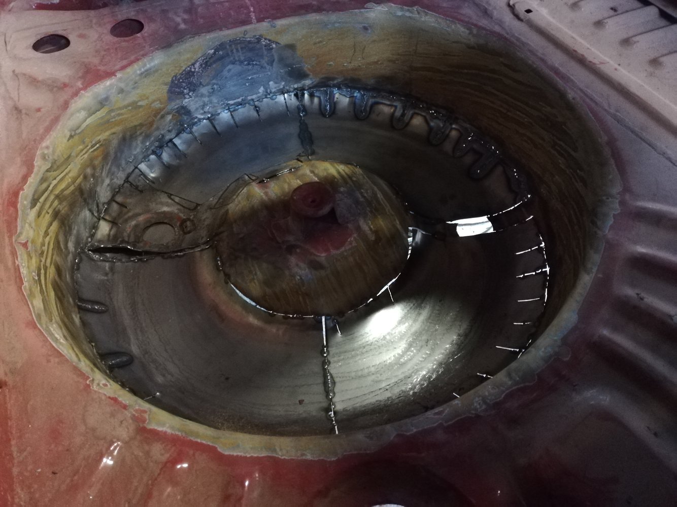

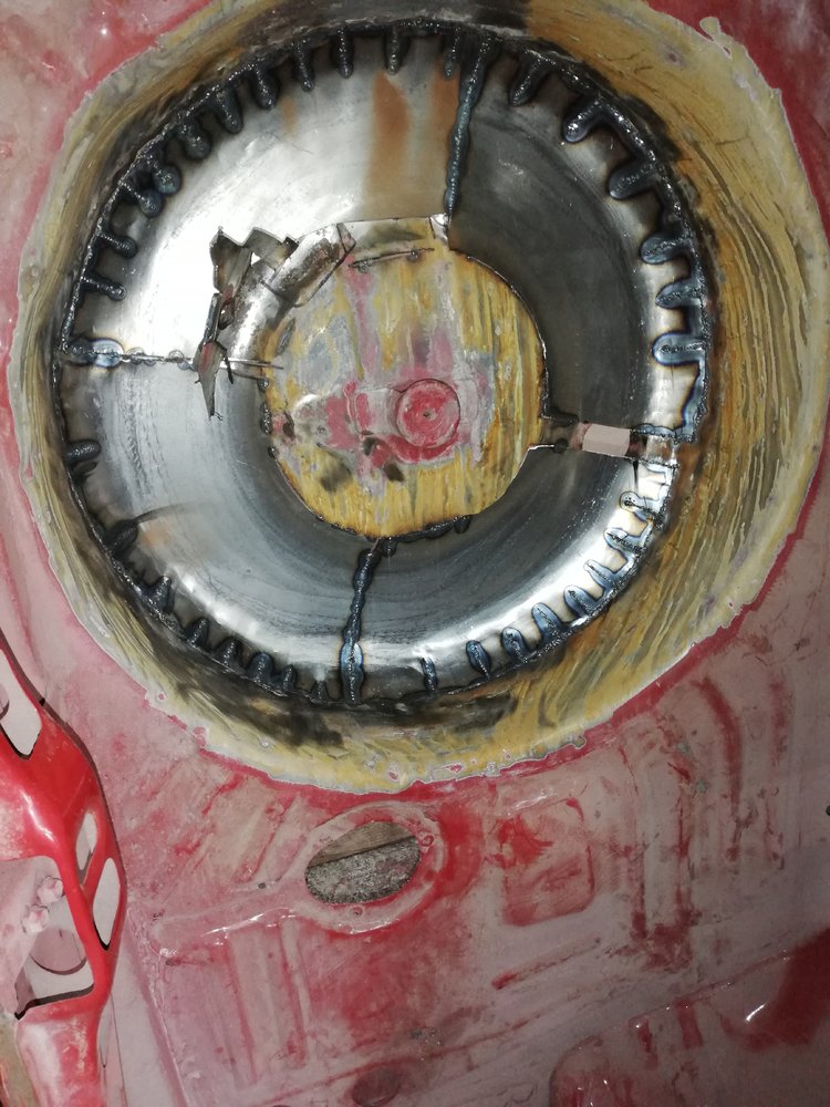

....I like how you formed the recesses for the bung holesIt's amazing how similar to my alfa that spare wheel well is, right down to the bung holes.
I made a few new sections for mine and welded them in.
They were the trickiest patches on the whole car but well worth doing.
Just go for it, you will learn lots as well.

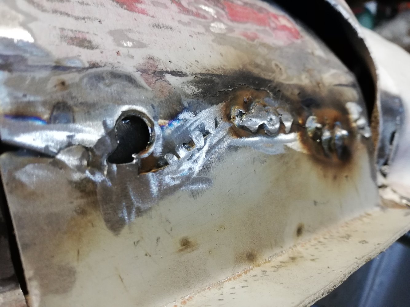

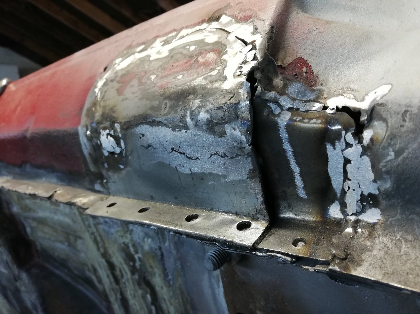

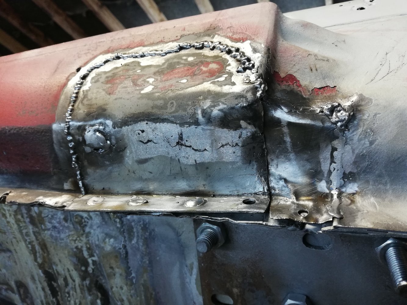

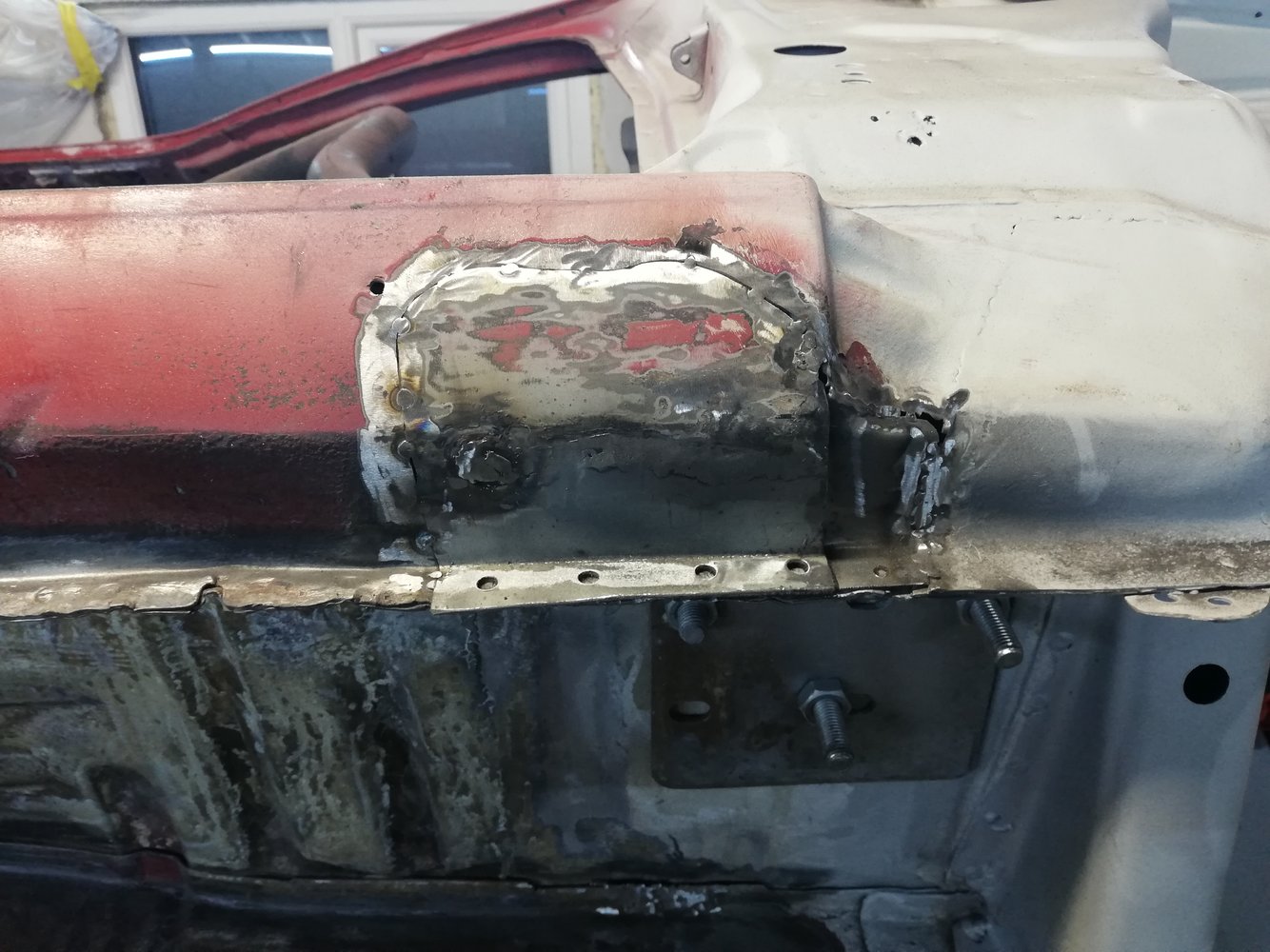

....I knew it was a bit ambitious, and it's hard work & all the relief cuts are quite daunting...

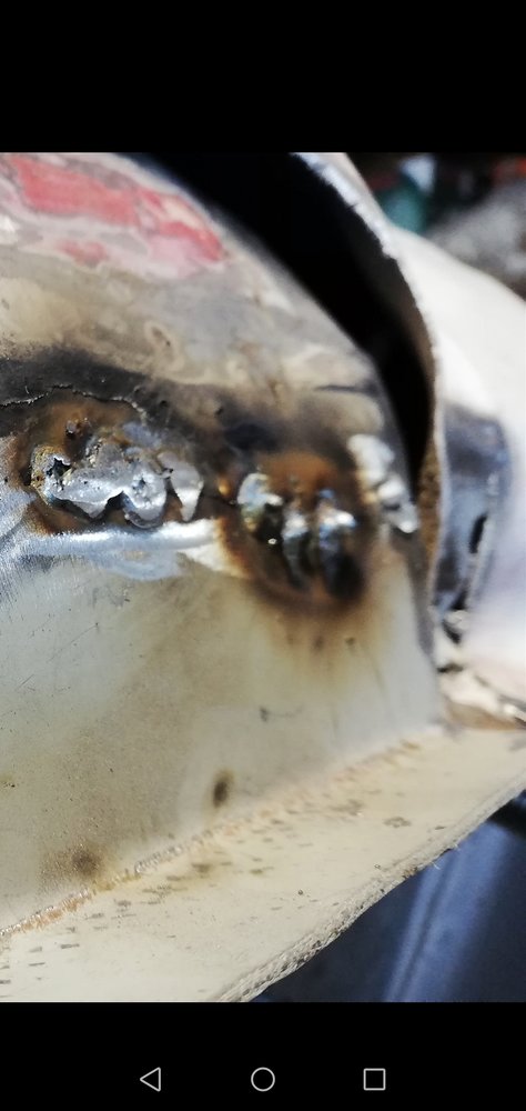

. I know that there's a minor leak because the gauges slowly depressurise after I close the tap (over the course of a few hours). However I suspect that now I'm nearing the end of the bottle, the leak is allowing air into the mix causing horribleness into the welds (the last three tacks on the right.
