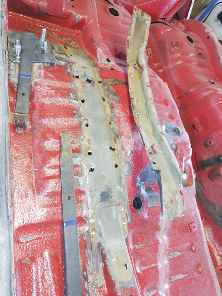

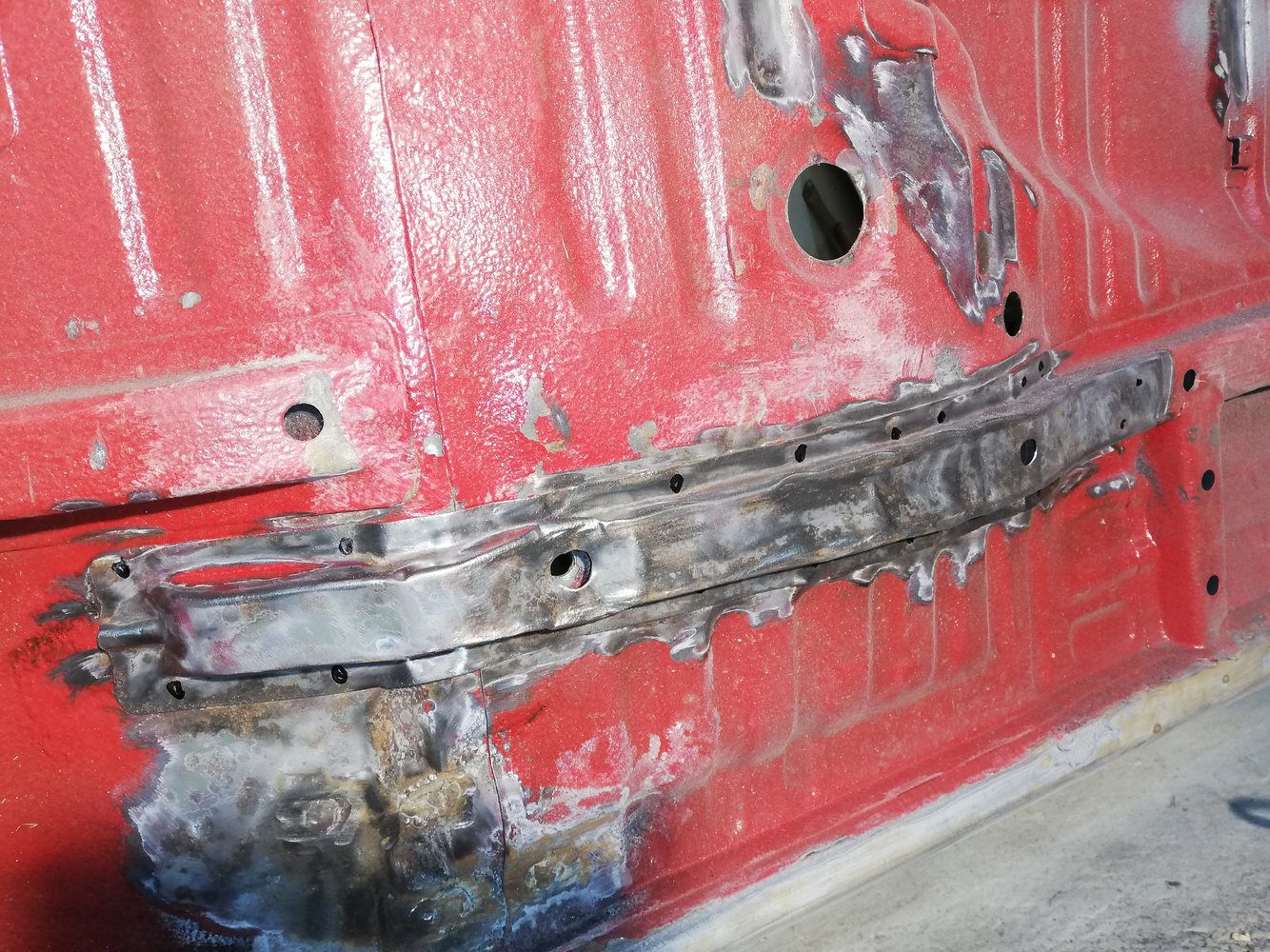

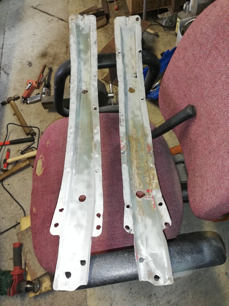

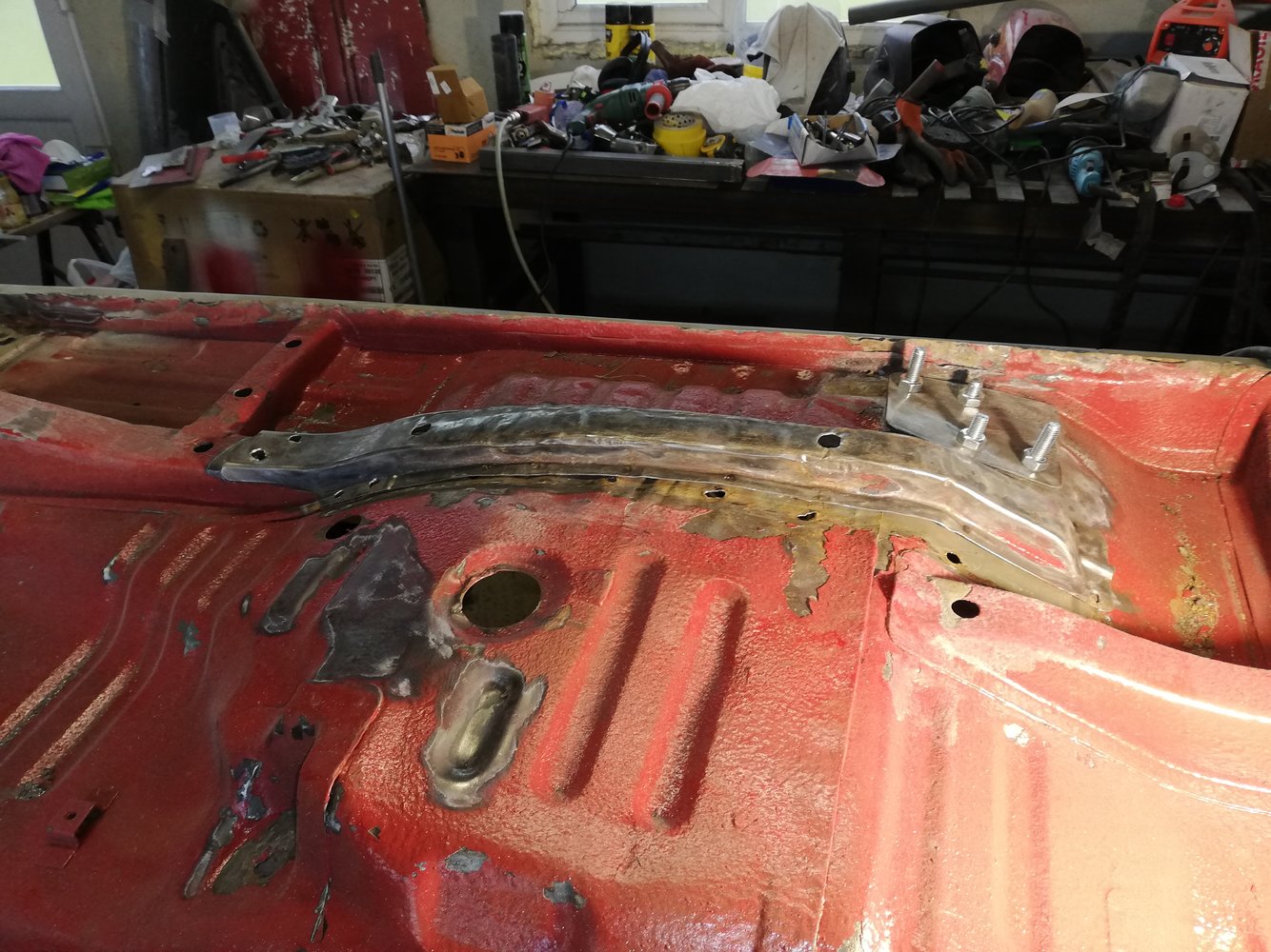

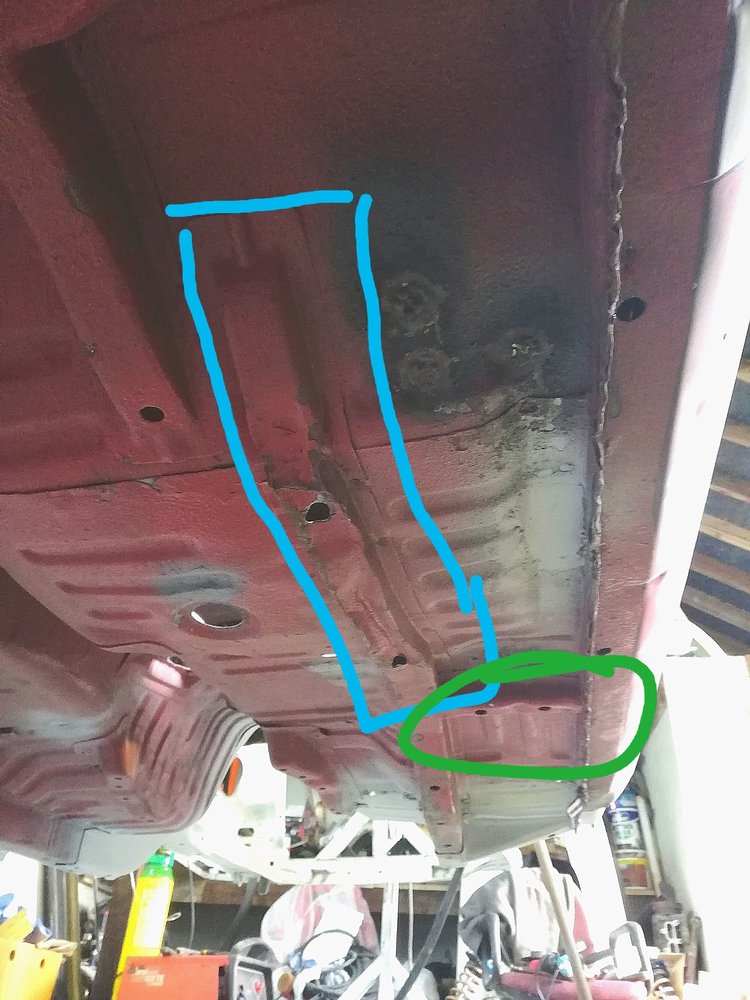

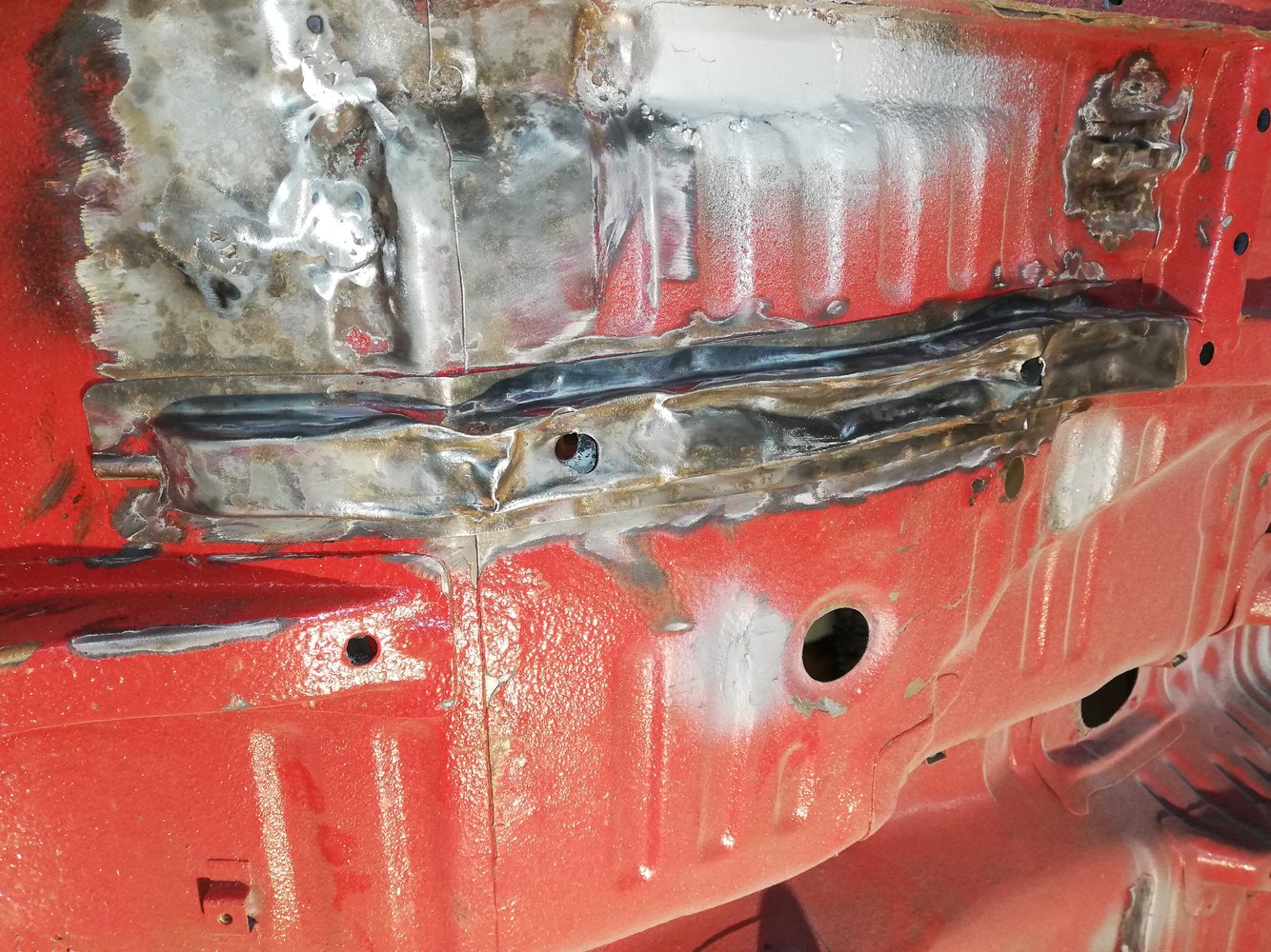

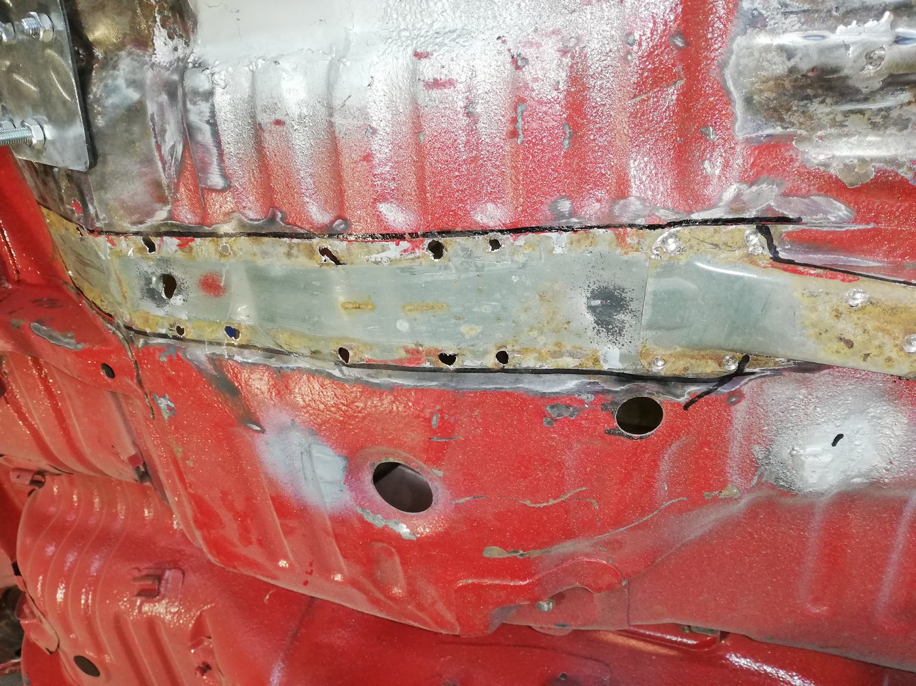

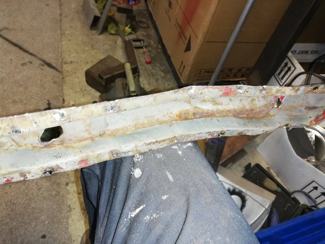

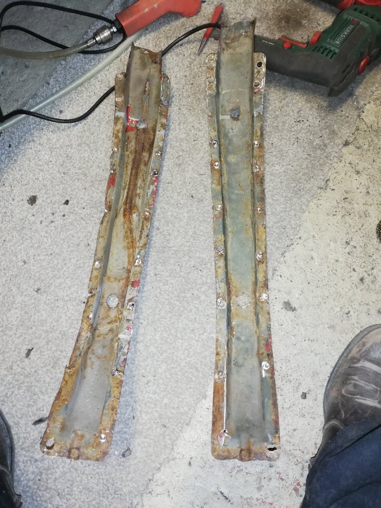

Couple of posts of similar repairs on my project, not much detail as I thought it was pretty straight forward.

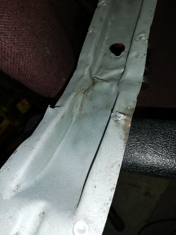

These bits are very light (0.8) on the alfa

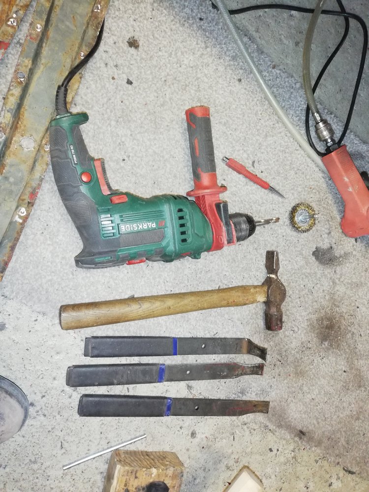

Just cut the bit you want to straighten, drill out the spot welds and straighten.
If it’s close after straightening, the holes will match and make alignment easy, then just plug weld and dress.

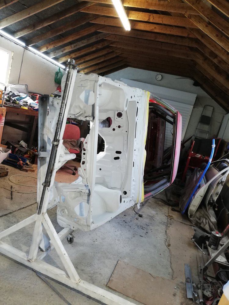

25 year old Alfa 75 back from the brink (hopefully)

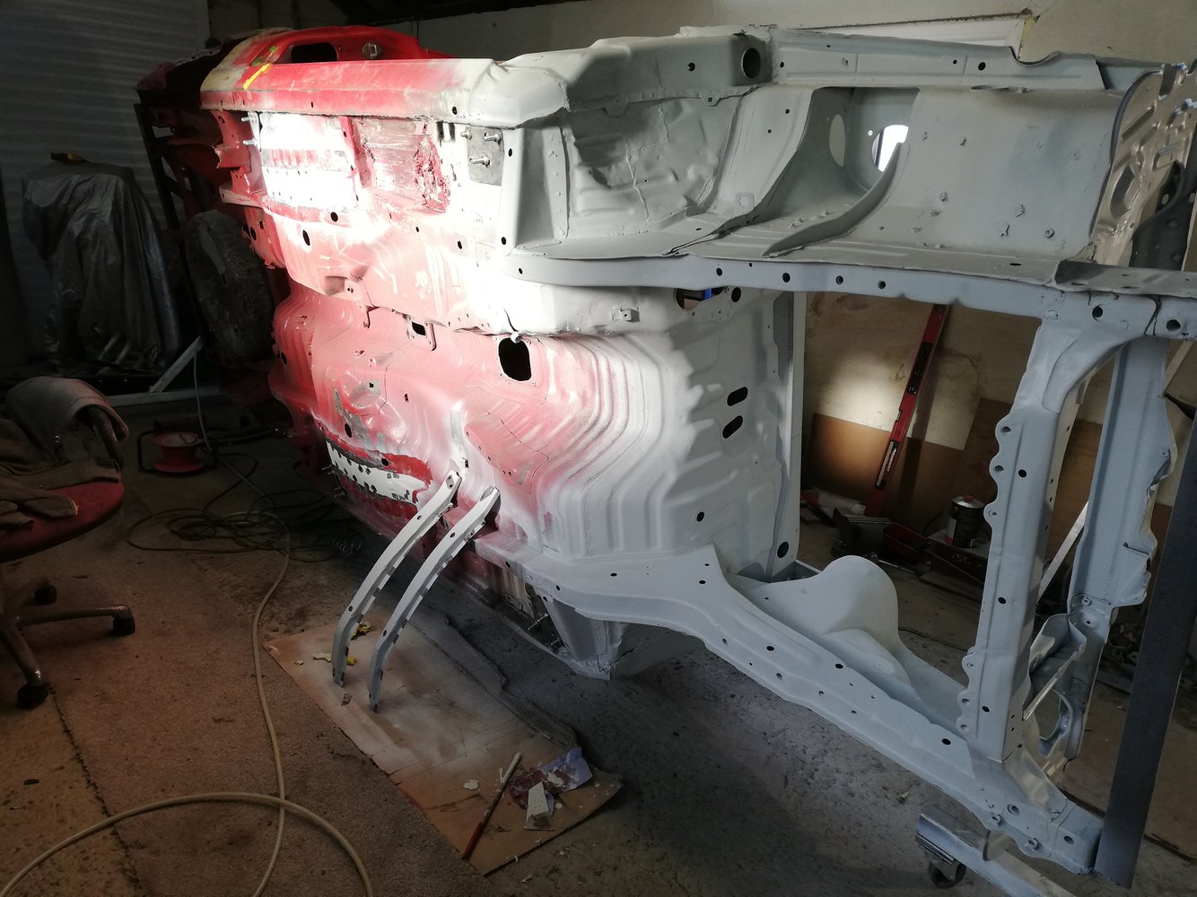

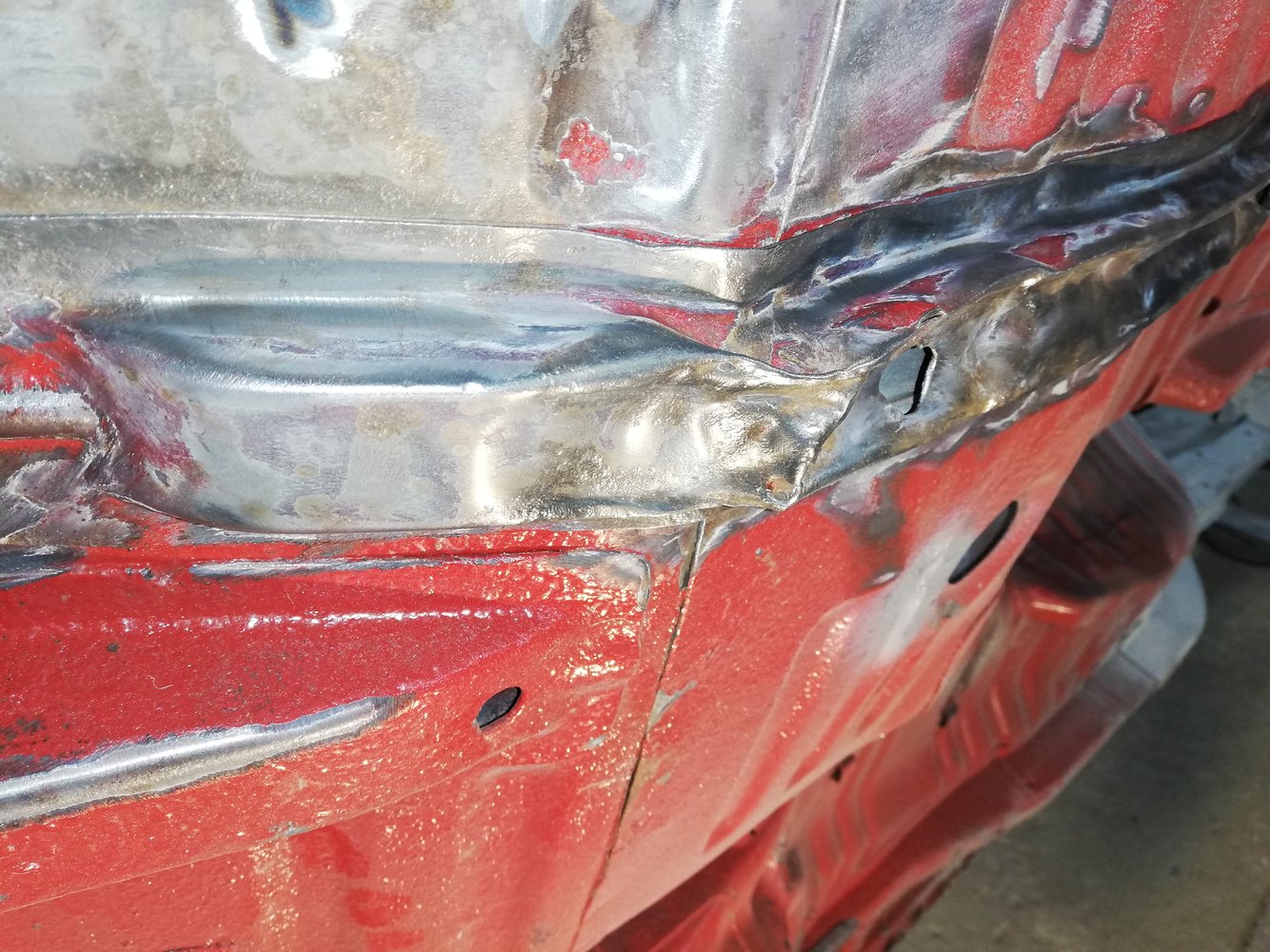

Thanks @Exuptoy Nearly there with this bit but every time I think I'm finished a I find something else! But it's good to finally say enough is enough and get some paint on. Any job is better than getting underseal off, a bit of welding is quite therapeutic.
