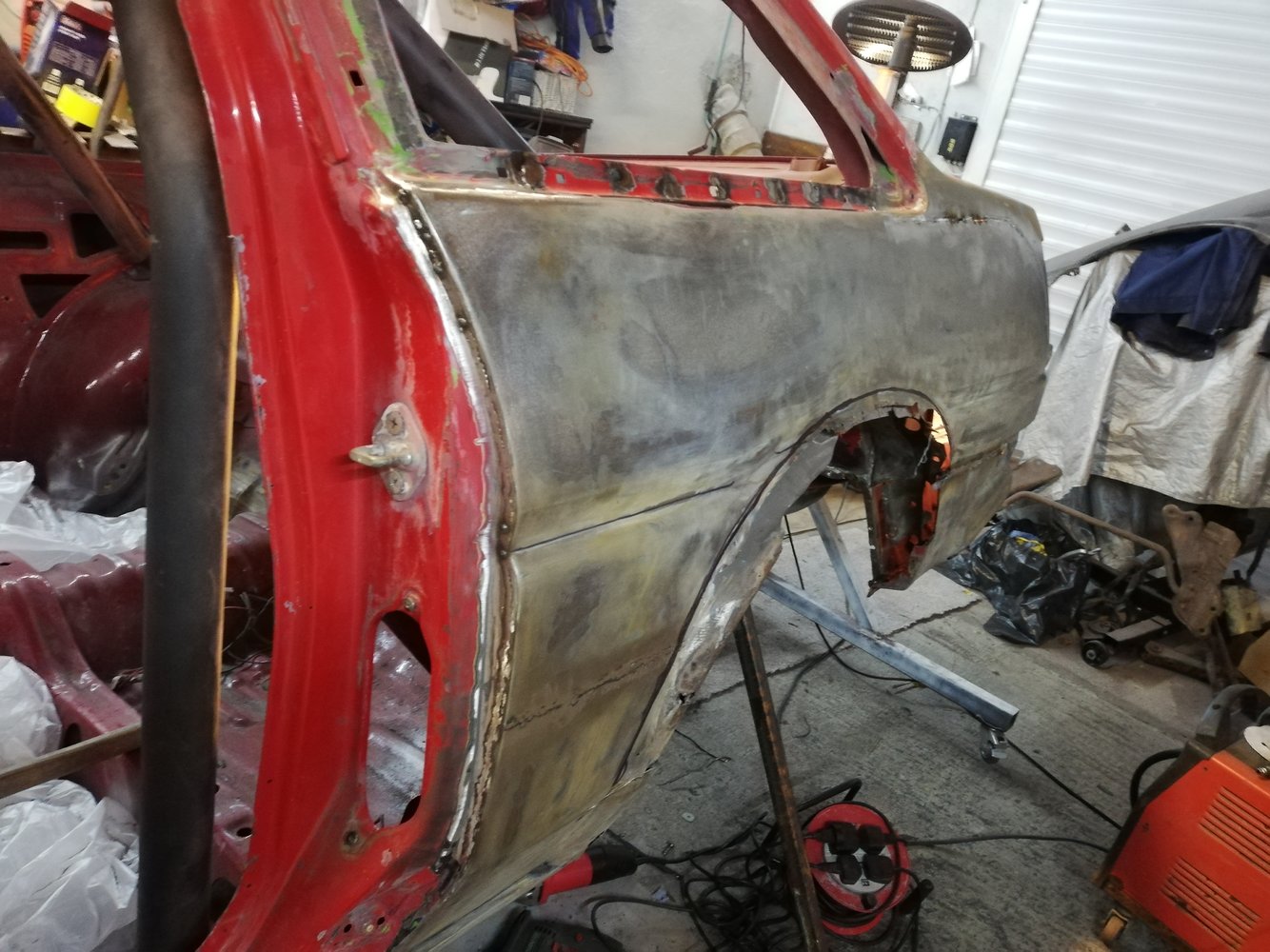

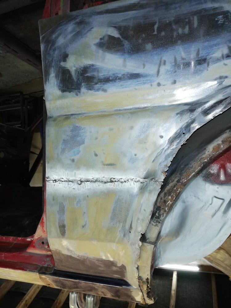

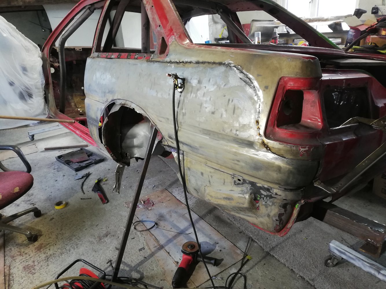

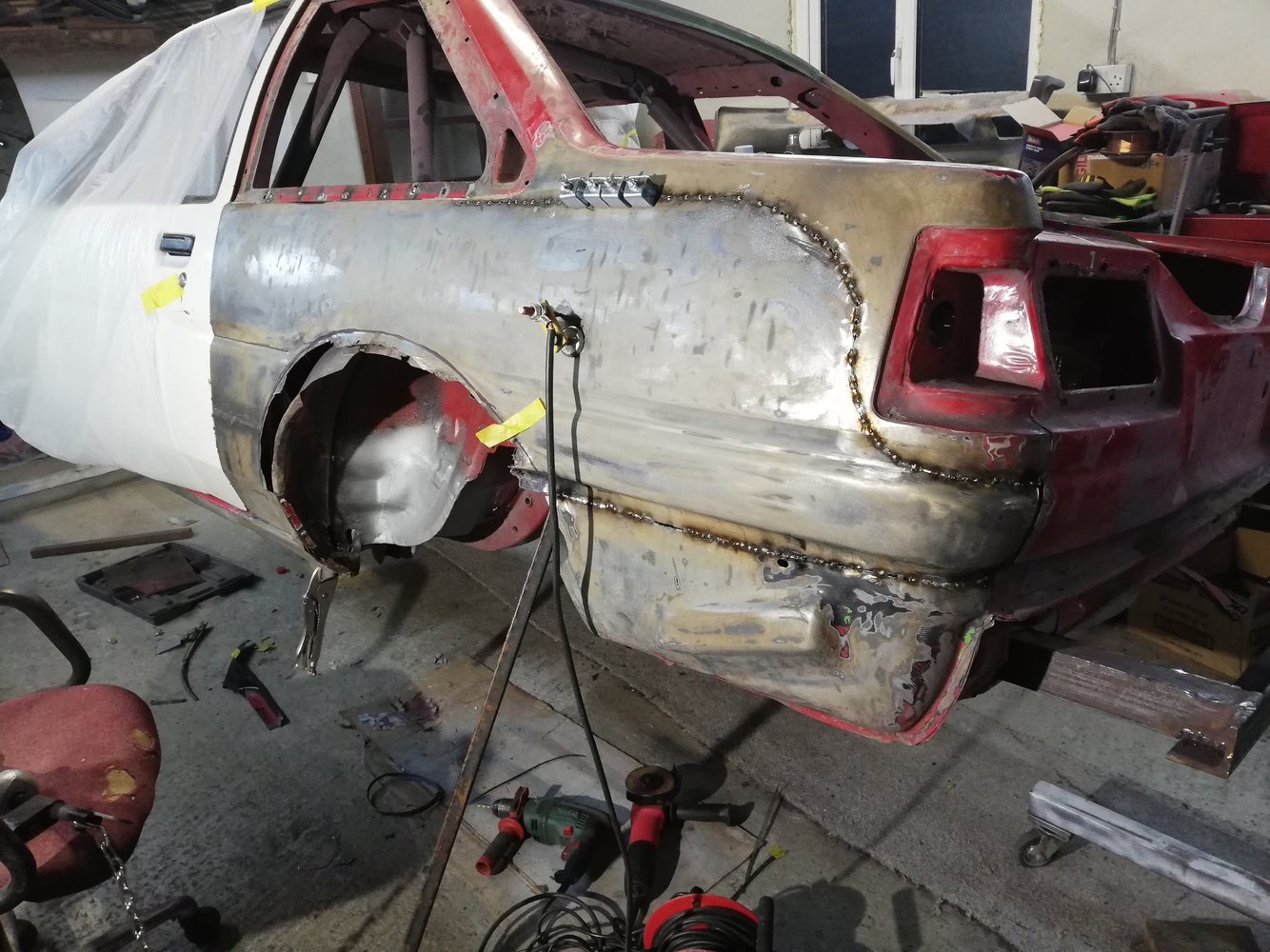

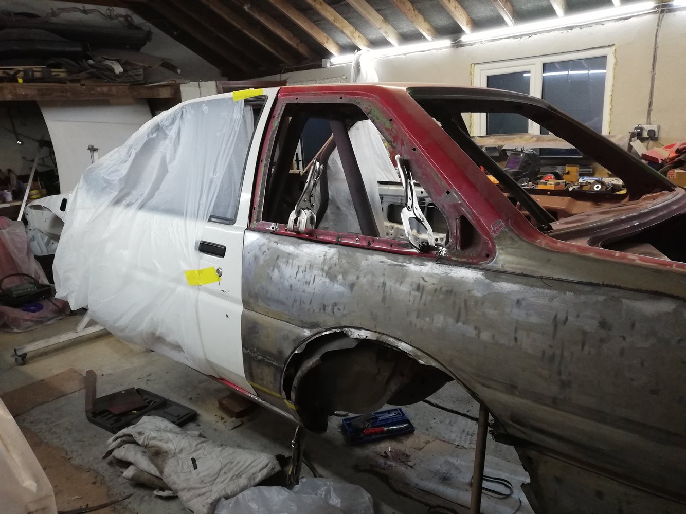

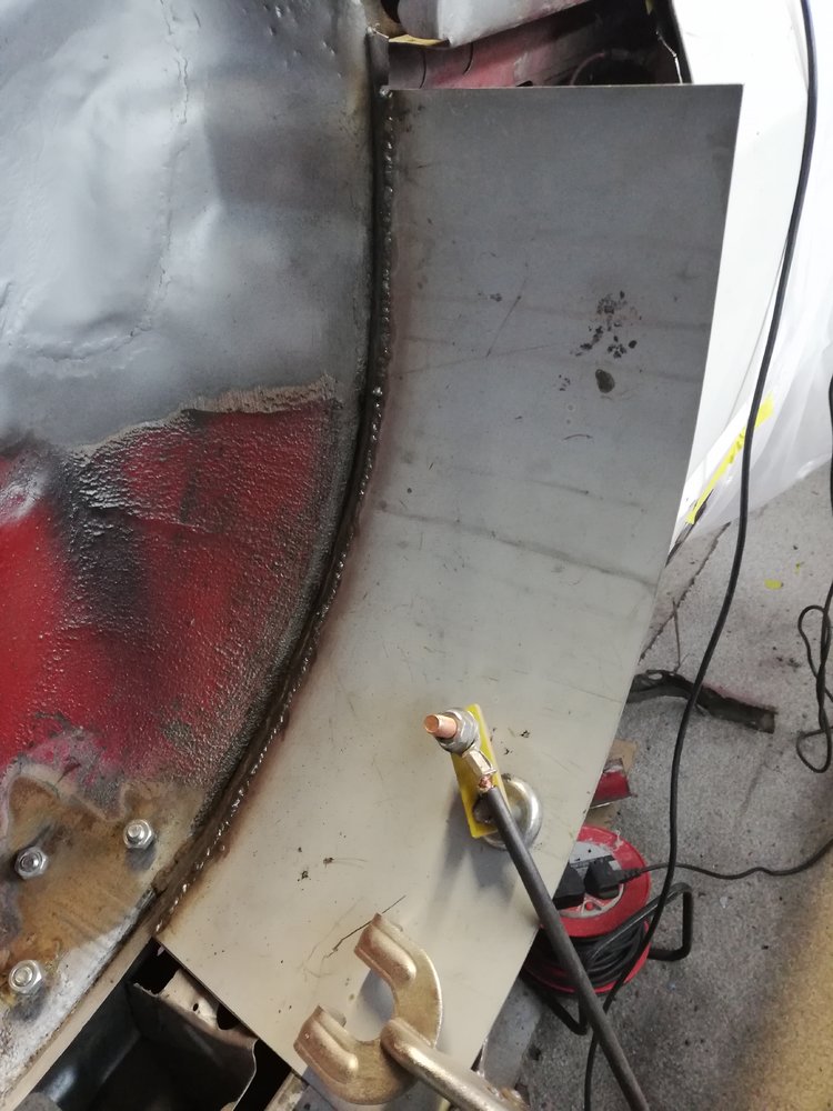

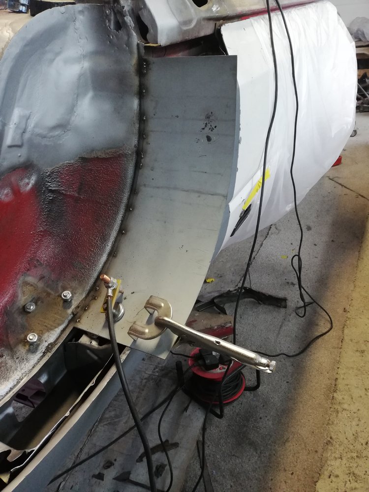

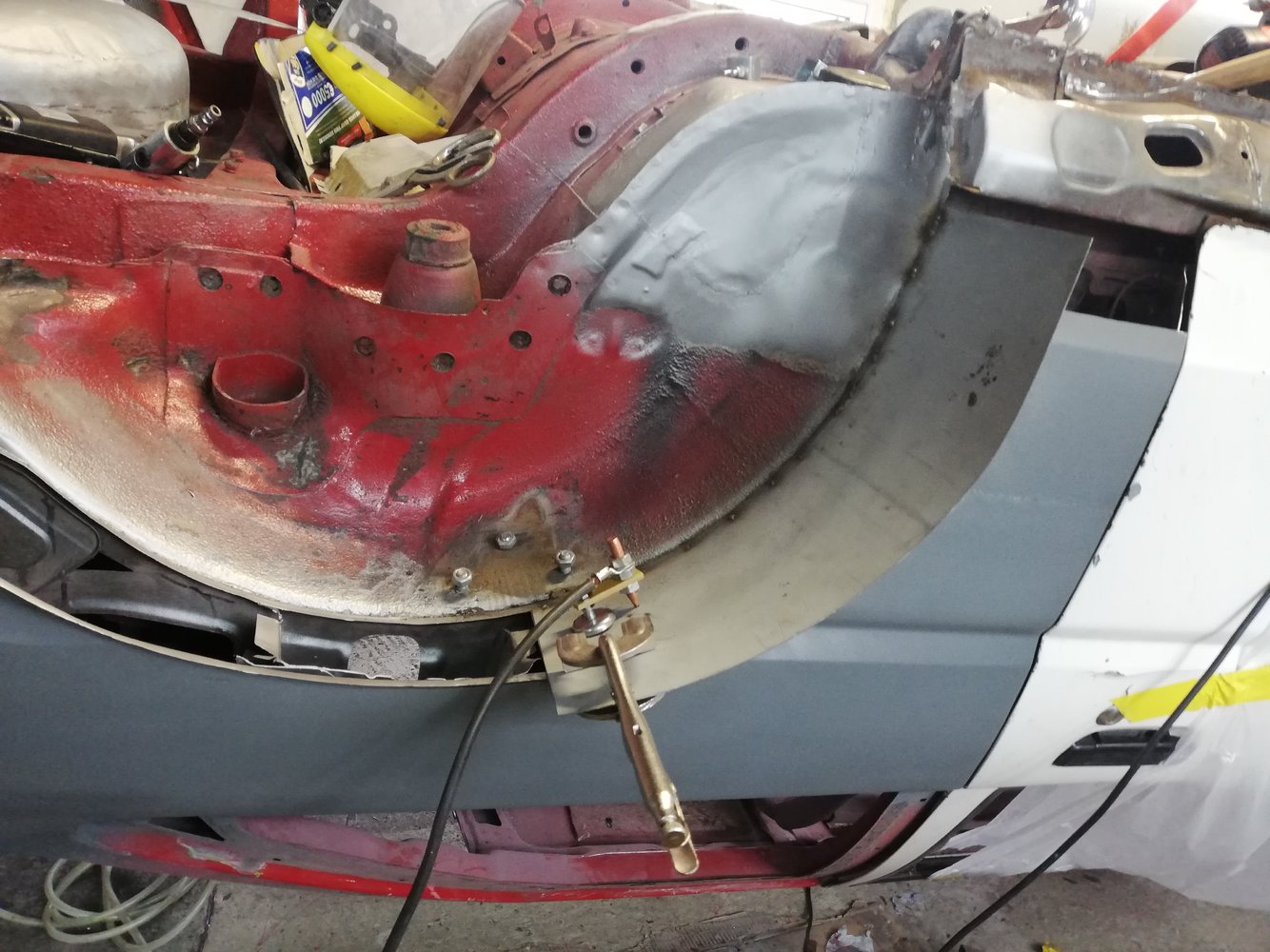

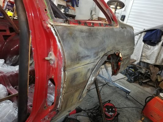

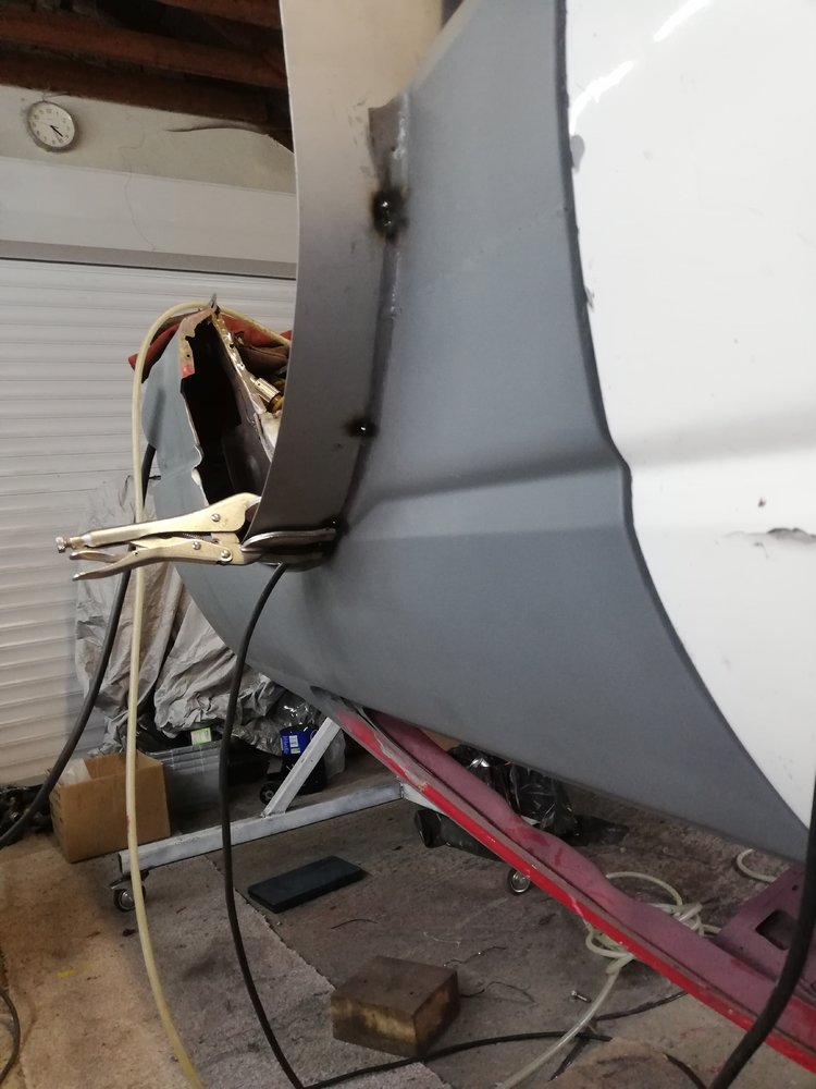

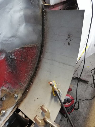

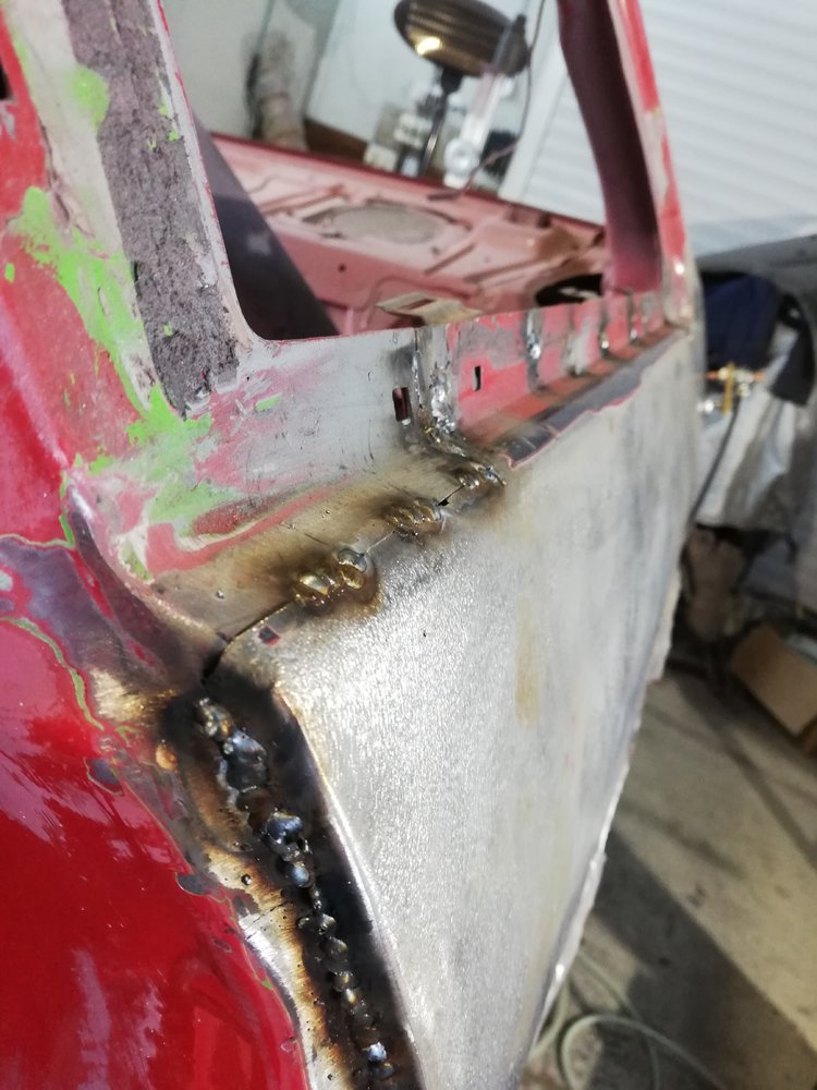

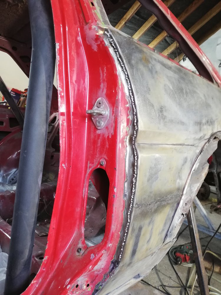

No. The seam along the door-shut I started with spots about 2" apart, then worked on the cut/butt on the flat surface at the opposite end alternating back and forth between the two areas. No distortion that I can see, so farAre you trying anything like air cooling or a damp rag to try assist with reducing distortion?
Good explanation, thanksPreform first weld or tack.
Metal heats up and expands.
Weld next spot before the last one cools down and you will lock in the expansion from the first weld.
The next spot will compound the problem and so on.
Start 2 inches apart and work out away from one another?No. The seam along the door-shut I started with spots about 2" apart, then worked on the cut/butt on the flat surface at the opposite end alternating back and forth between the two areas. No distortion that I can see, so far

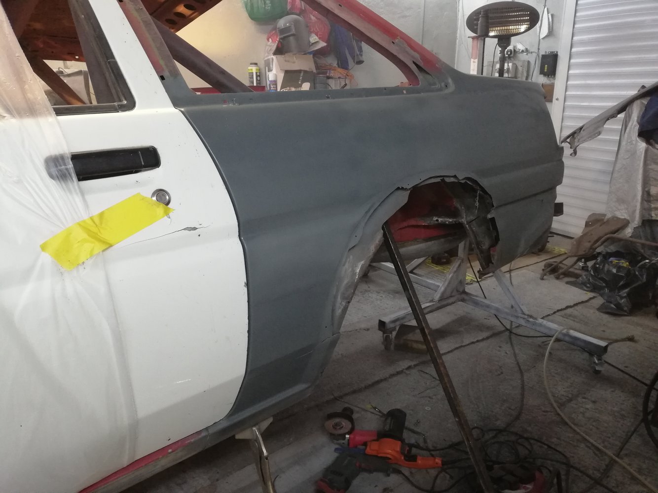

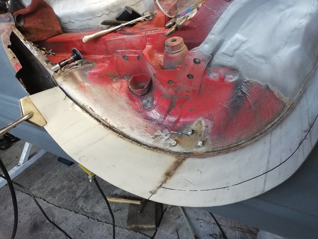

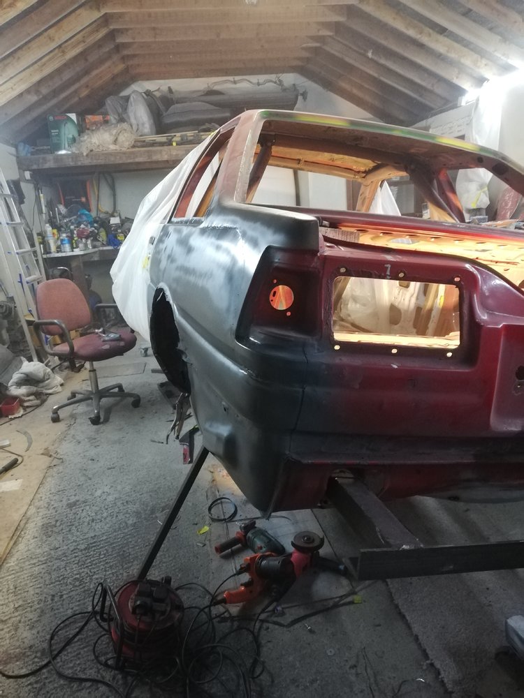

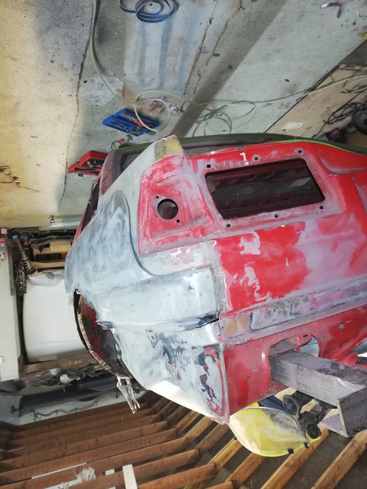

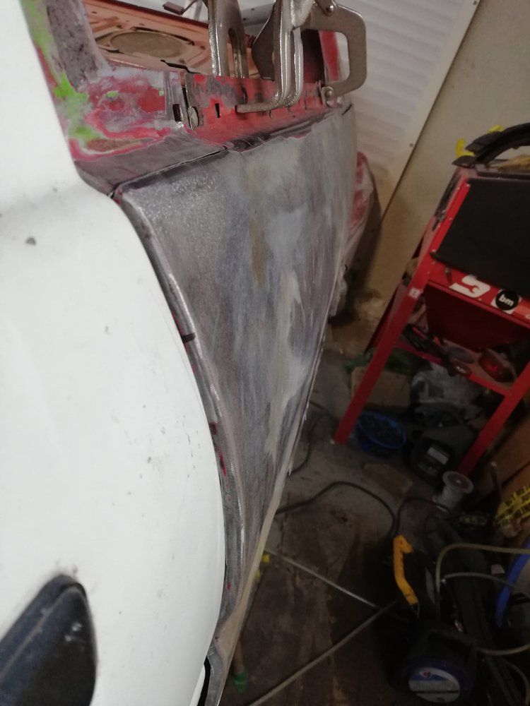

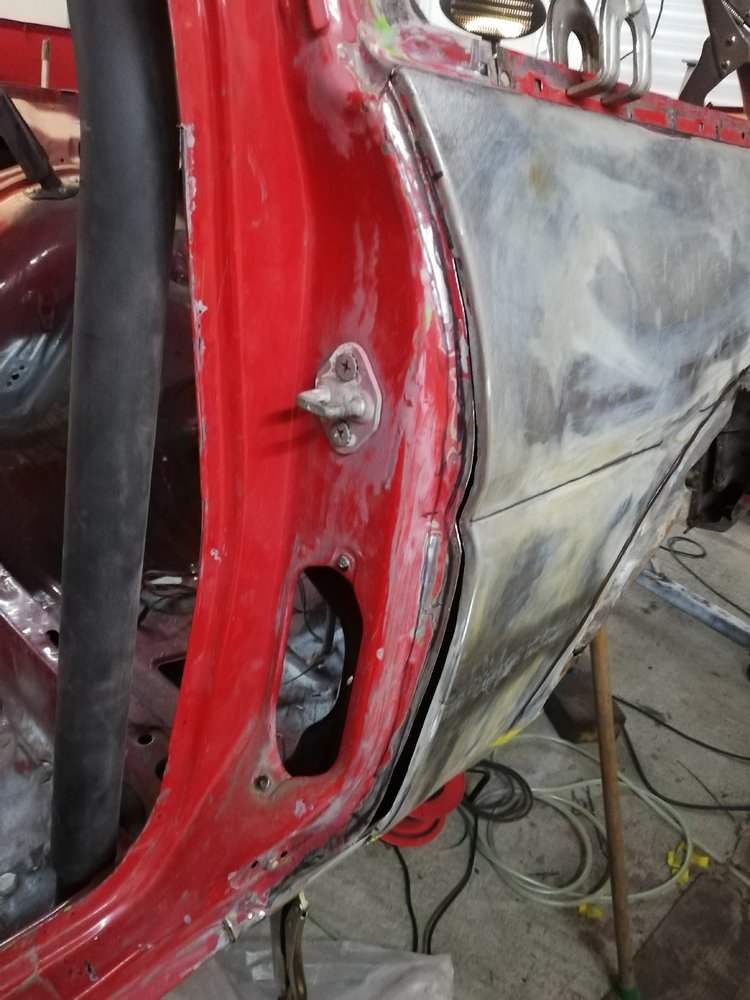

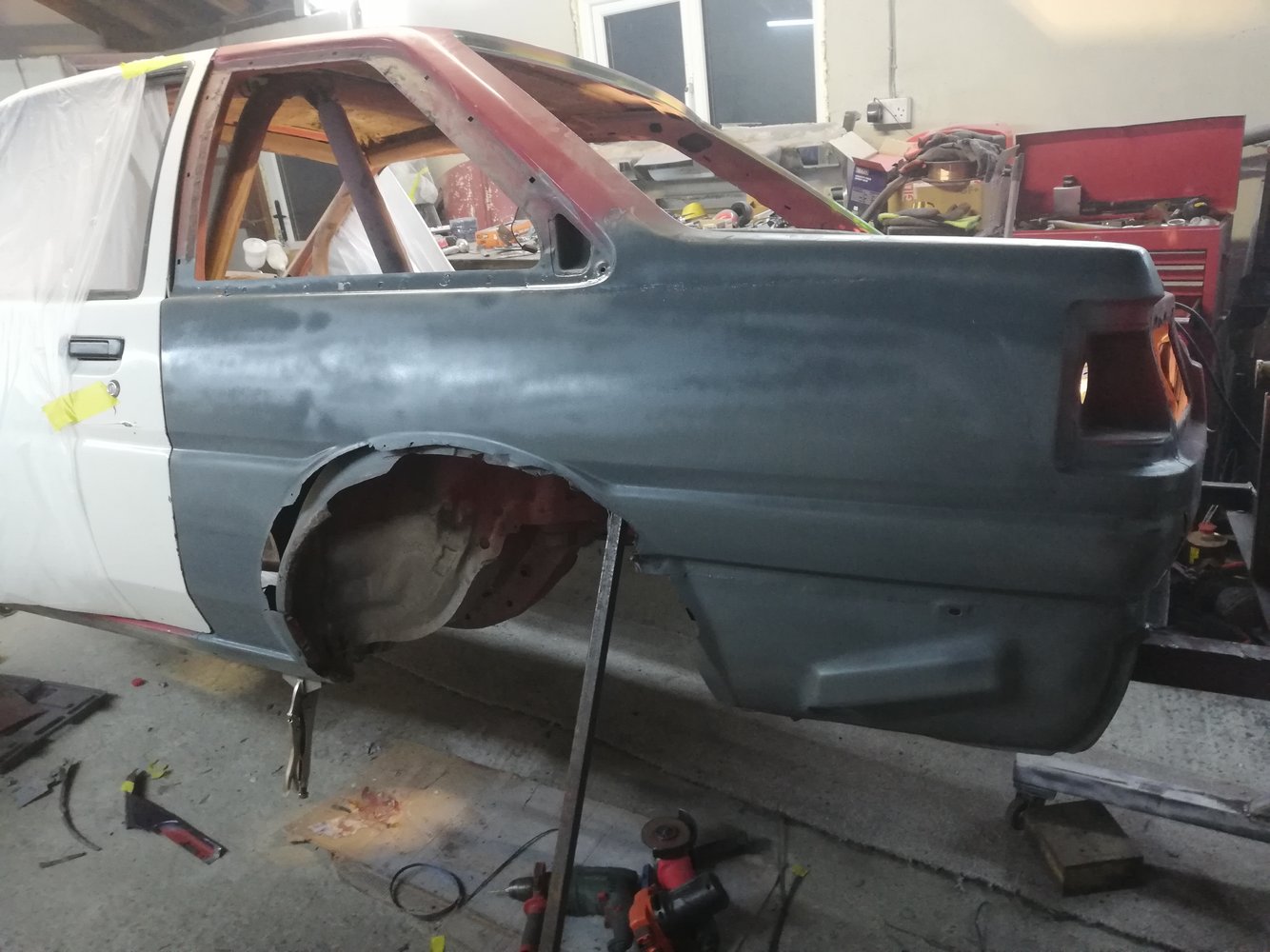

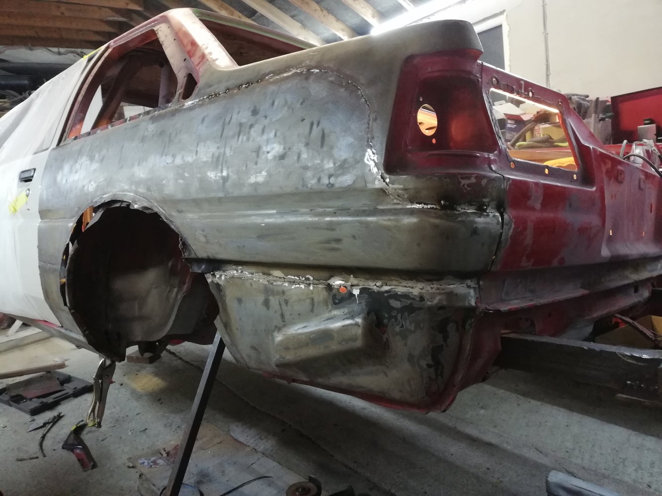

, actually blew through once.Coming along nicelyAnd so it continues.... a quick temporary coat of primer it will need a skim of filler along the top seam, but for the most part it's good
View attachment 306496 View attachment 306497 View attachment 306498 View attachment 306499 View attachment 306500 View attachment 306501
